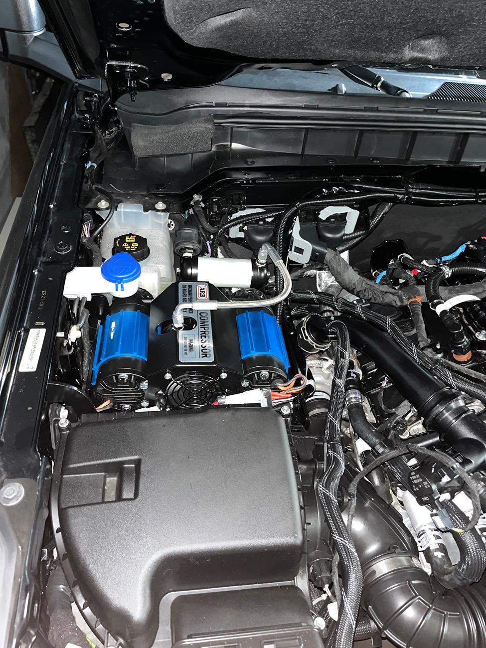

I started with portable, a single hose and no dedicated deflators. As I started going more often, I found I wanted to take less stuff with me each time and air up/down faster. I got the onboard twin arb compressor, the valve stems that deflate in 4-5 seconds and the quad hoses. It made the tedium of airing up and down a bit less of a chore.
Still annoying unless you manage to get one of these installed on your bronco. Also if anyone in the states has done this, show it off. This pic I found on reddit.

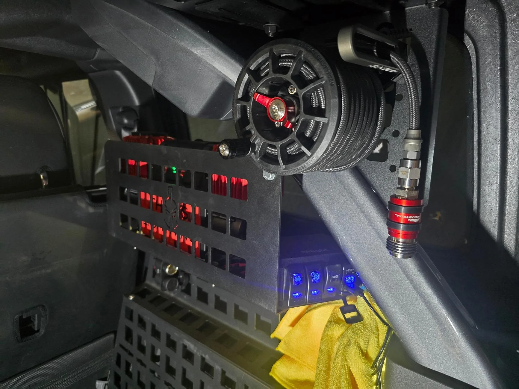

I have the Thors setup with molle mount. It’s hardwired. Very convenient and fast. Because it is so easy, I air down a lot more. We go on FS roads a lot and it cuts down on the rattling and beating up my Bronco. I put on the CRS hose/reel just because I saw it and liked it.
That hose reel awesome

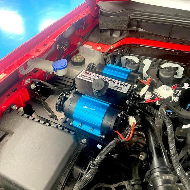

The main difference between the ARB Twin Air Compressor, which is $616 and a portable air compressor such as the MORRFlate or THOR for like $350 or so... is that the ARB is an ONBOARD air compressor and the others are PORTABLE.
Onboard air compressors LIVE inside your vehicle, installed, always ready to go. While portable air compressors live in a carrying case and have to be setup every time you want to use them. The portable connect via alligator clips to your battery while onboard air are wired to the battery at all times.
Both are about the same speed, with portables MAYBE being slightly faster because they are BIGGER compressors.
The real enthusiast prefers onboard air because it's out of the way, doesn't require setting up and is VERY reliable. They are built to take a lot of abuse and heat because they are onboard air compressors.

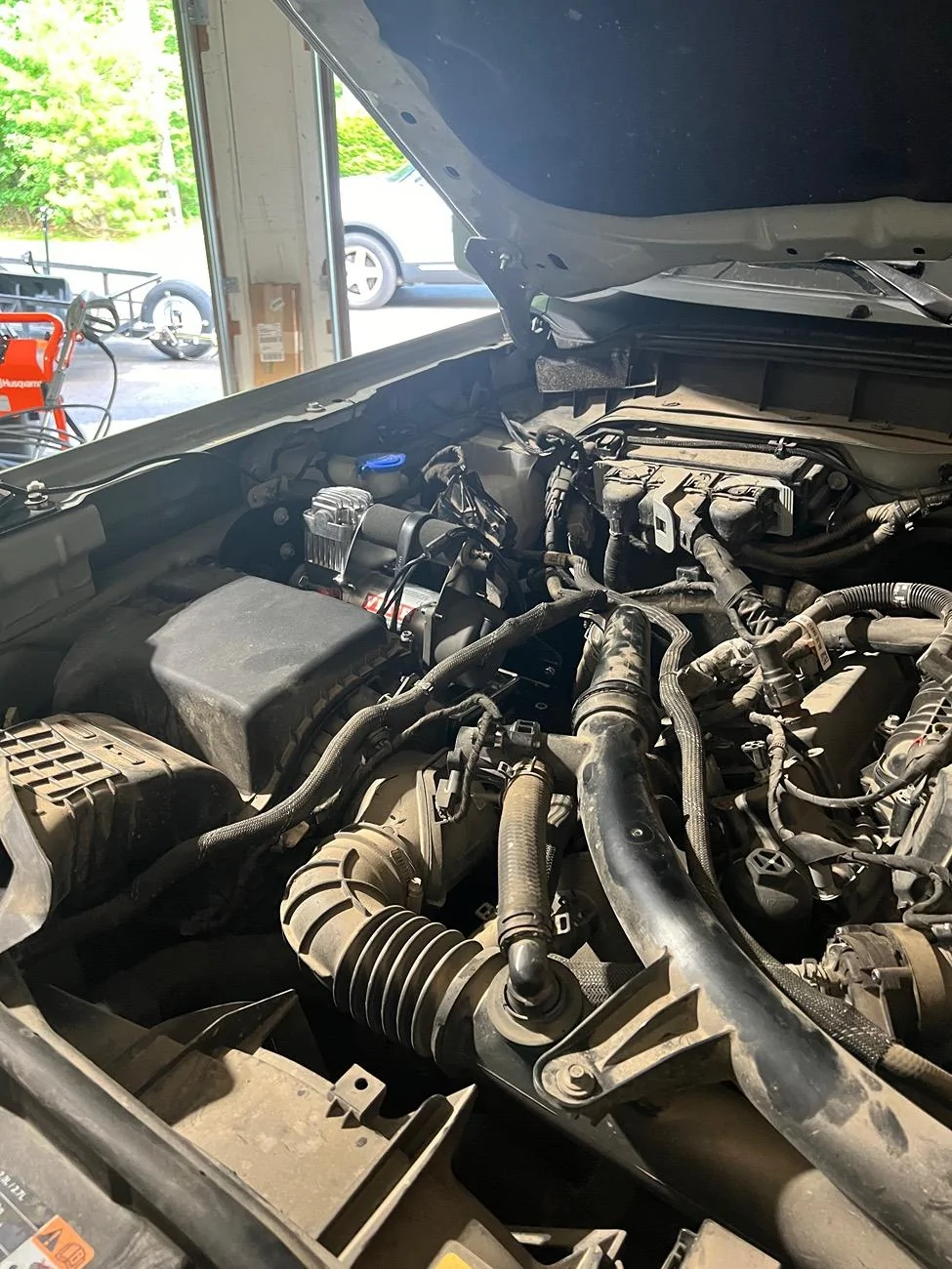

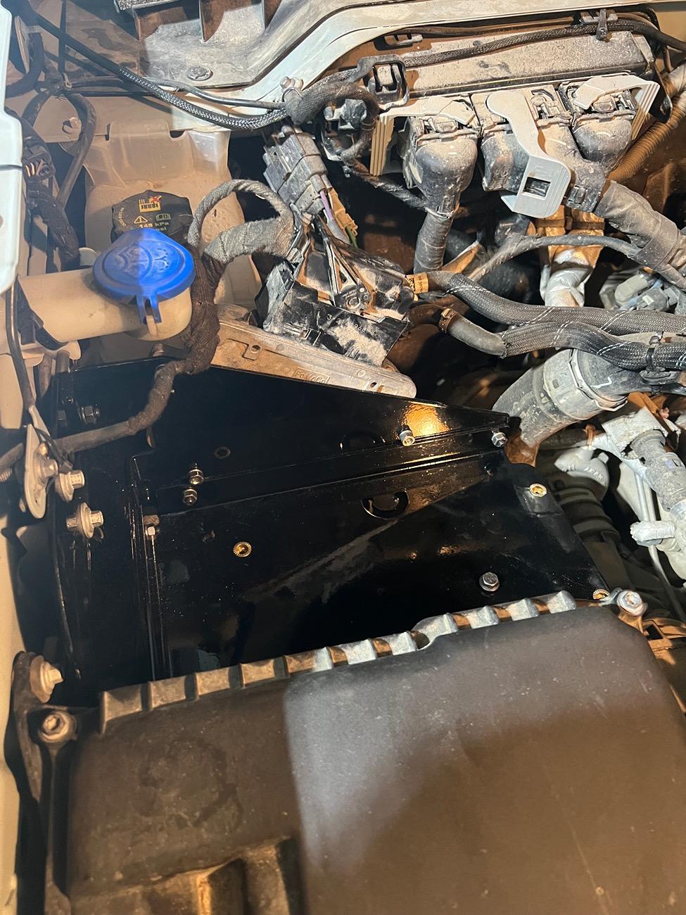

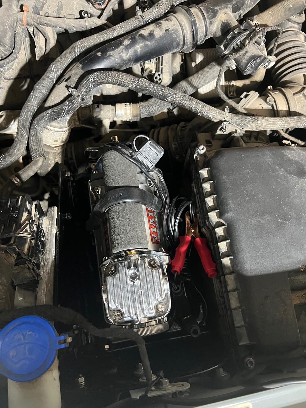

I think people have covered the options pretty well. I have somewhat “split the difference “ installing an under hood mount that accepts most of the “NAPA” and “Viair” style compressors. It even works with a “bungie” set up giving you the option to take the compressor out for mobile use (my Viair is currently in its mobile bag in my F150 for a trip). It ends up about $300, depending on the compressor you choose.
The guy making the mounts has done a lot of testing and is a Btonco owner/enthusiast too.

How much did you take out to get it to fit?
Have the same setup. But now I need that hose reel!

+1 for the ARB twin compressor mounted under the hood for reasons everyone has already stated that has one. Ford Performance had a 25% off recently for Fourth of July, so I couldn’t resist. Now I never have to worry about it.
