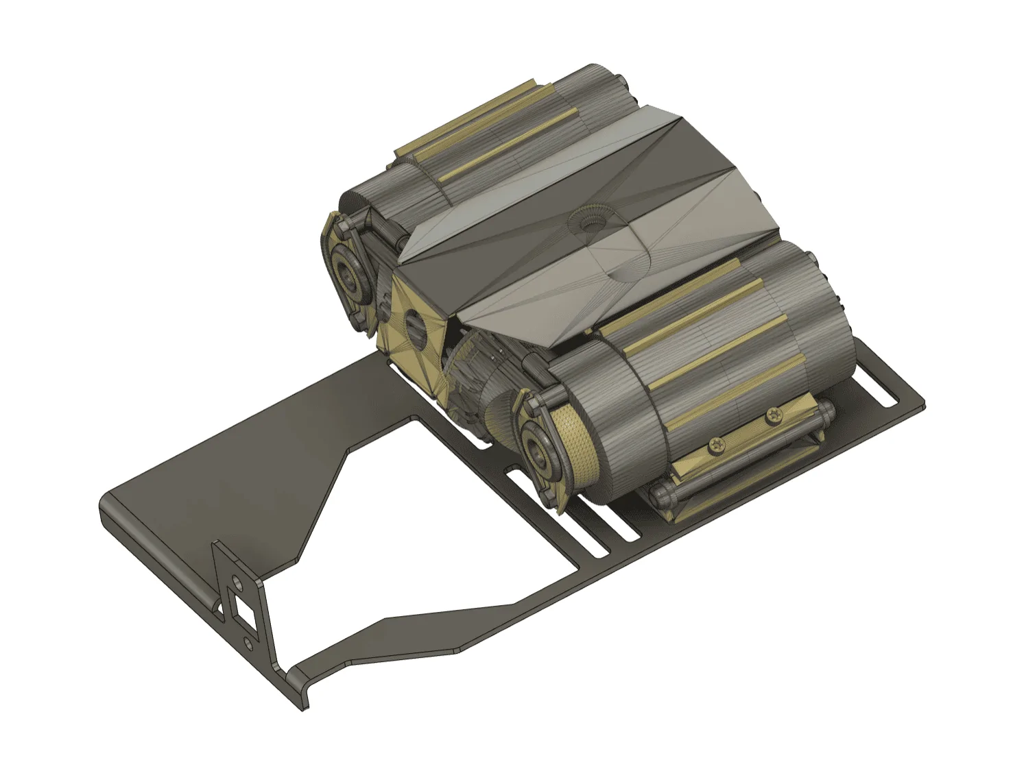

The Mishimoto CAI will not fit with the KR offroad underhood mount. It will work with the Roush CAI, but that is because it still uses the stock airbox.
I know this because I just replaced my Roush CAI with the Mishimoto CAI (along with their charge pipes and a whipple intercooler) and my underhood KR offroad twin ARB compressor mount would not work. The install video from Panda Motorworks shows the fitment issues at minute 3:15:
I relocated the compressor to a molle panel in my cargo area.
With that said, the KR offroad mount was great. Easy to install and looked great.

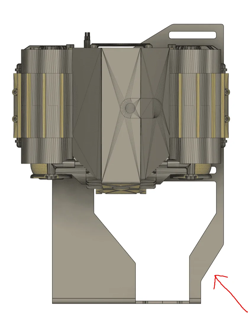

We just redesigned the bracket a bit. It should work now with some more aftermarket intakes. It probably won't work with the Mishimoto one still because that box REALLY sticks out. The other boxes had issues with the mounting point gettnig in the way. So on the new compressor brackets (the ones coming out later this year, figure November/December) should fit better.

You can see the new notched area to allow for a lot of aftermarket intakes to mount, since they seem to use larger plastic pieces that stick out from the air boxes.
