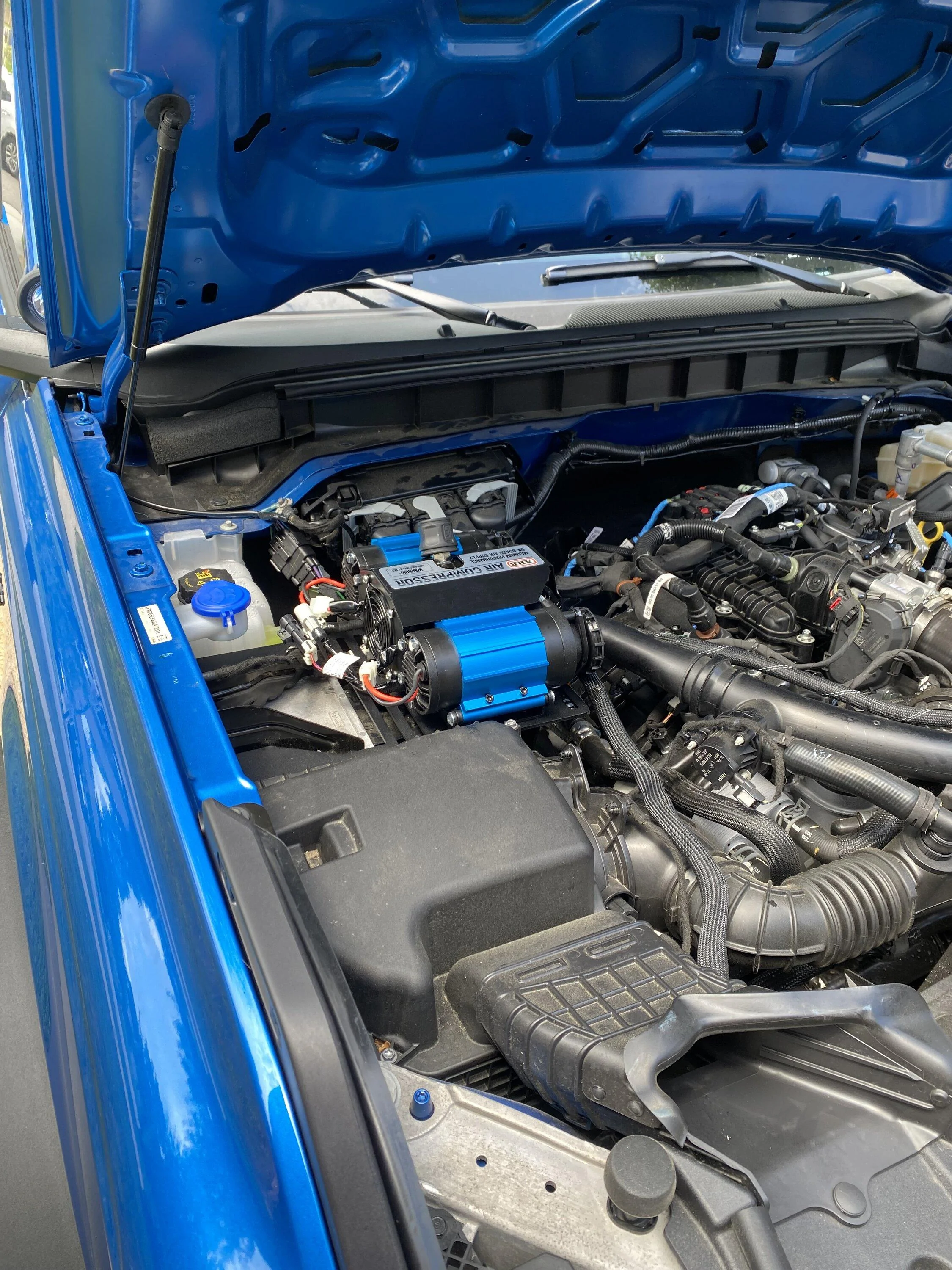

I recently installed the under the hood mount from @4x4TruckLEDs.com and a dual ARB compressor - Pictures are on my build journal. Very happy with it.
Although I have AUX switches as well, I opted to install the switch under the hood, next to the compressor. IMO, it was easier and I would rather control the compressor at the compressor vs. having to go inside the truck. Very simple.

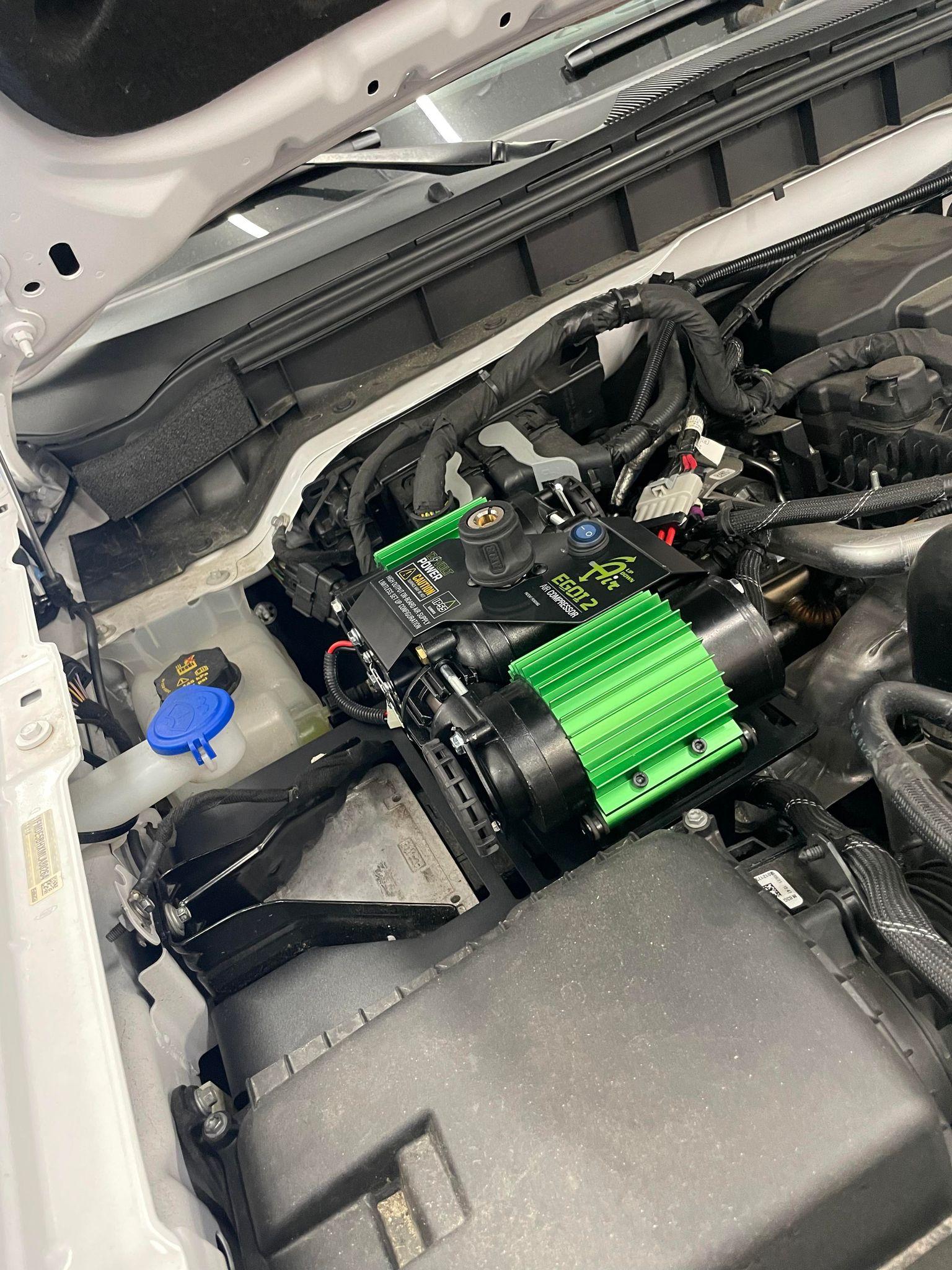

I do love this, but I’m still worried that the CAI I want won’t fit with either (Mishimoto) I’m always looking for pictures and trying to find one with both but it’s not as easy as you’d think 😂.
Also does this connector touch the hood? Or is that any concern?
Get a different CAI then. I honestly don't like Mishimoto because they just copy peoples products. They copied Swarfworks license plate bracket which is made in the USA (theirs is not).
We've had many people run a CAI and not had issues. I think there's maybe only one CAI that has fitment issues based on what 1 single customer said. Out of over a thousand of these out there, not one customer (other then the one in that other post) has reported an issue. So Mishimoto could work just fine.
The only one I heard doesn't work is the AFE Momentum GT on a 2.7 that 1 customer reported issues with.

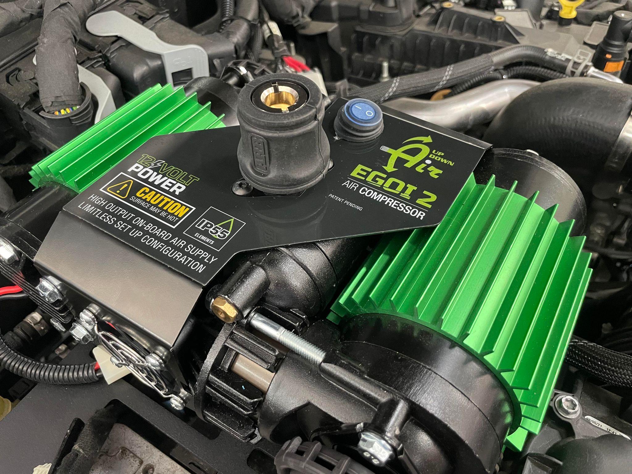

Can I interpret this as the UDA will fit on anything the ARB fits on? Going with tire carrier mount, but hadn't purchased the compressor yet. All anyone ever demos is the ARB.
KIND OF.
So they have a lot more mounting bolts on the back of theirs then ARB (ARB has 8 and the UDA have 12).
Some of the mounting points on the UDA are the same as on the AIR, and some are not.
So if you have a bracket that only has 4 holes (for an ARB), you'll only have 3 that match up with UDA. That's how our current KR Off-Road brackets are. 3 mounting points are used instead of 4. And that is MORE then sufficient.
It also depends on the flexibility of the bracket. Our bracket was designed with extra mounting holes, to give people the opportunity to mount different compressors in different ways. Other mounts may not be as flexible. So it really comes down to the actual mount itself.
With our mount, you can mount an ARB Single, Twin or a UDA without issues. I can tell you that.
I have their setup, and no, it doesn’t touch the bottom of the hood. I have the under-the-hood sound deadening too. When you install the ARB compressor, you can angle the connector - I did this so it wasn’t sitting straight up.

I was referring to the UDA I know ARB tilts but all photos of EDA are straight up.
UDA doesn’t tilt and if your hood has sound dampening material the coupler will tough a tiny bit - nothing to worry about
The Mishimoto CAI will not fit with the KR offroad underhood mount. It will work with the Roush CAI, but that is because it still uses the stock airbox.
I know this because I just replaced my Roush CAI with the Mishimoto CAI (along with their charge pipes and a whipple intercooler) and my underhood KR offroad twin ARB compressor mount would not work. The install video from Panda Motorworks shows the fitment issues at minute 3:15:
I relocated the compressor to a molle panel in my cargo area.
With that said, the KR offroad mount was great. Easy to install and looked great.
