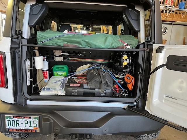

I like the CO2 Powertank which replaced a Viair tank, which was way slow. The Powertank inflates a 35-inch from 12 to 36PSI in about 20-30 seconds each. I bolted mine inside my Tuffy enclosure on the right side, but they have Bronco mounts. The tank is easily removed when not needed. Also may be used for air tools. Detriment is it needs to be refilled, which I have not done in about 8 uses.

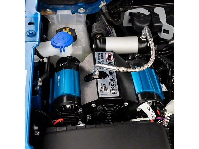

The ARB Twin compressor is the first mod going into my Bronco! You can definitely get away with a lot cheaper, but for me it was:
  • Saving interior storage space for other things when camping, plus its always there when you need it
  • Worrying less about killing the compressor by accident with a cheaper unit and larger tires (worry less about duty cycle and air volume).
  • Quicker/easier air up (using the ARB Twin with a Morrflate Quad hose)
  • Option to control the compressor from an upfitter switch and use the onboard TPMS to monitor pressure during air-up (works while compressor is on, hose mounted gauges require you to turn off the compressor to measure PSI) - I haven't done this wiring yet, but I can when I want to.
  • Lower maintenance compared to filling CO2 power tanks, and lower storage space requirements than power tank (just need a hose)

Question for the group - Besides having a built-in solution for airing up your tires, why does one buy a $900 compressor over a $120 portable solution? Also, what are your recommendations for airing up/down?
$980: ARB Twin 12v Air Compressor
$120: Dewalt 20v Portable Inflator
I run the ARB twin dual compressor. Personally I bought it because quality, convince and size. Filling 4x 35s from 12(ish) PSI back to 38 PSI in the middle of nowhere takes some work for a little compressor. ARB engineers their equipment to withstand these extreme working conditions and temps. It fits in the engine compartment, is wired to an aux switch and takes less cargo space away from the rest of my gear. I also use Indeflate 4 with it and it has made things a lot easier for airing up or down and ensures equal PSI on all 4 tires simultaneously. And I was able to swing the expense. When it comes to off road equipment, If you can swing the expense for quality you should... hope it helped.
