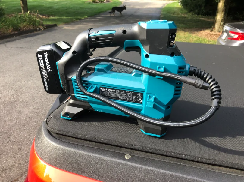

I'm new to the Bronco world, but I love my 18V Makita, surprisingly powerful. I use it for everything, including my compact tractor, which has pretty big tires, and it works great.

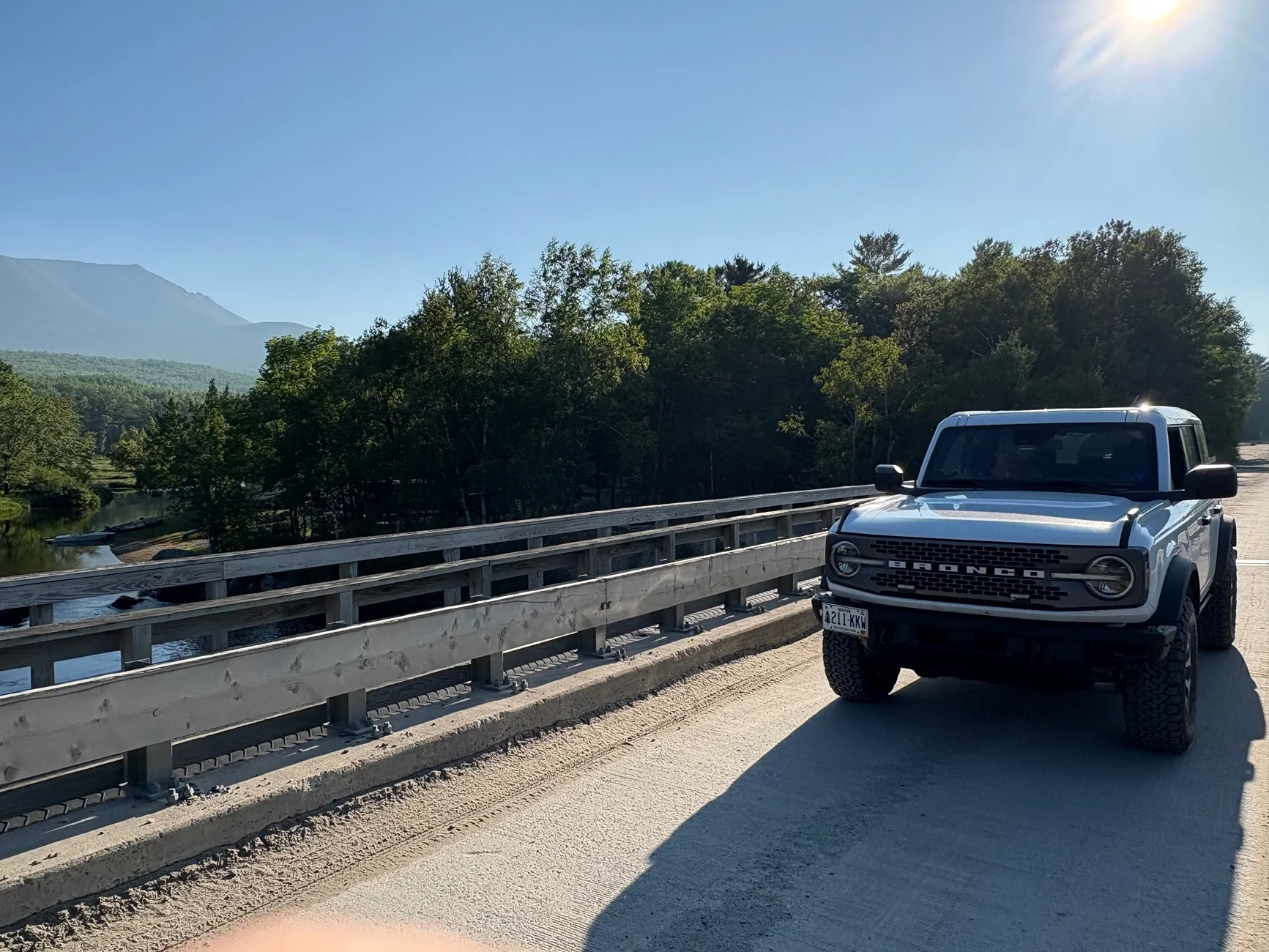

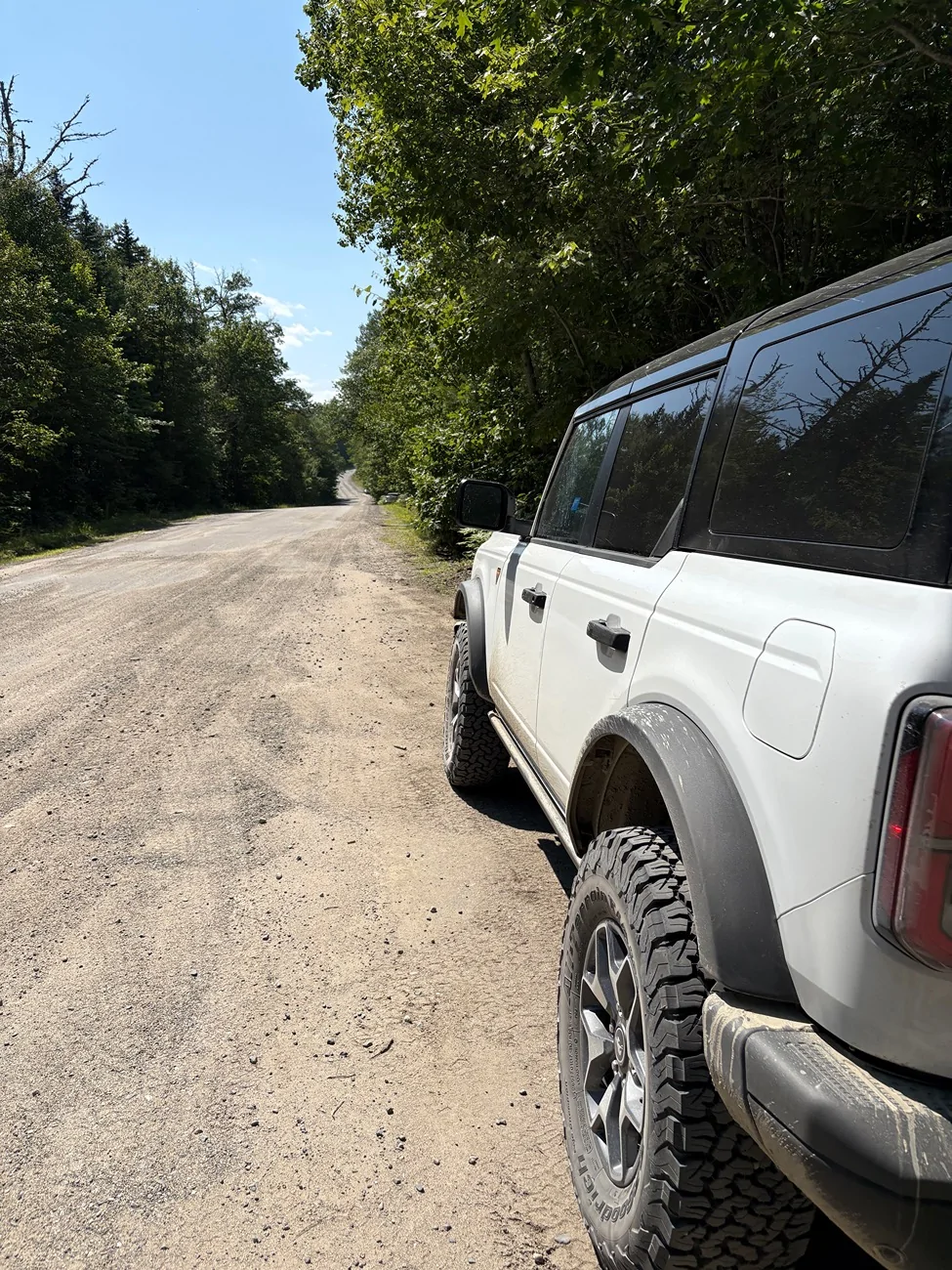

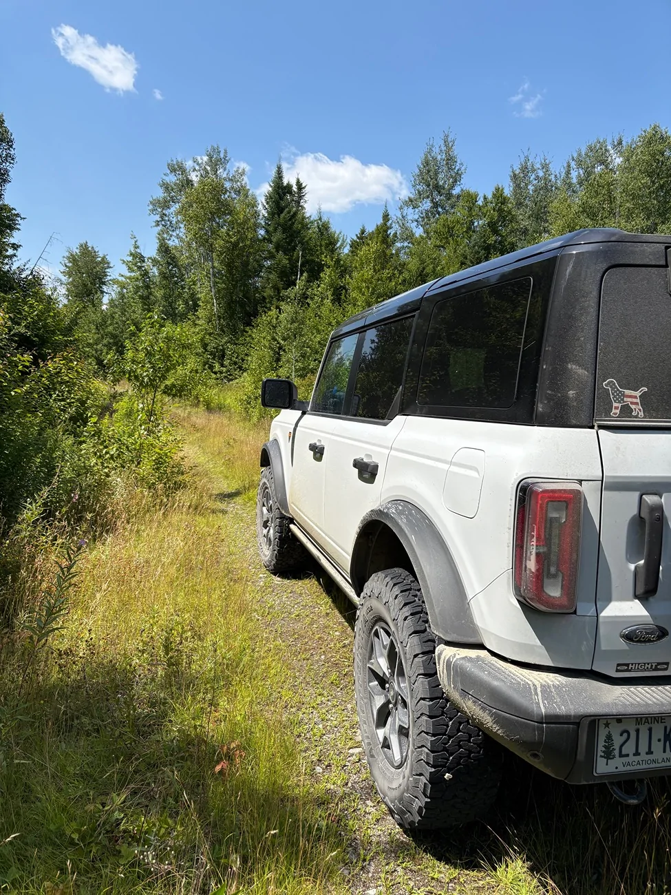

I never did respond back here but around 30 psi was great. Ride was very smooth and we had an awesome time exploring. Will be going back for an extended trip but my dad is nearing 70 and wasn’t up for roughing it.
