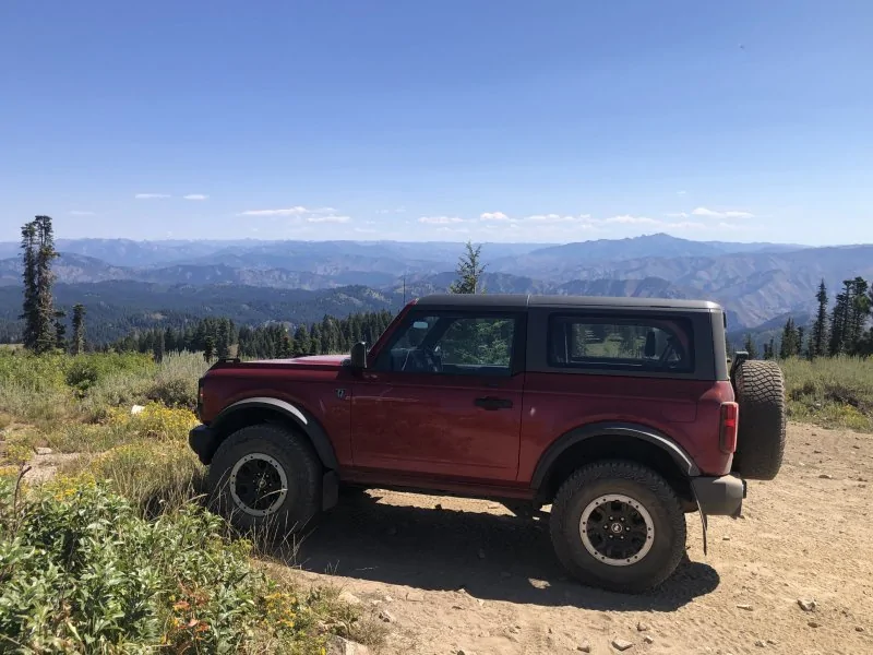

Gratutitous photo from earlier today at a local fire lookout at 7550 feet.
