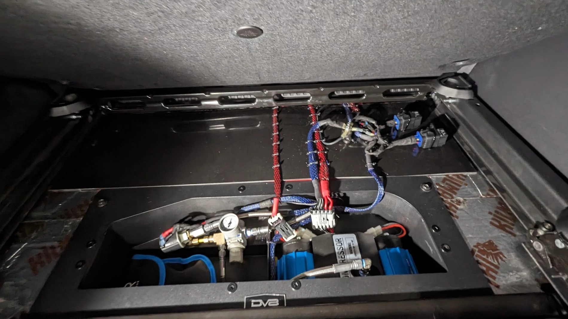

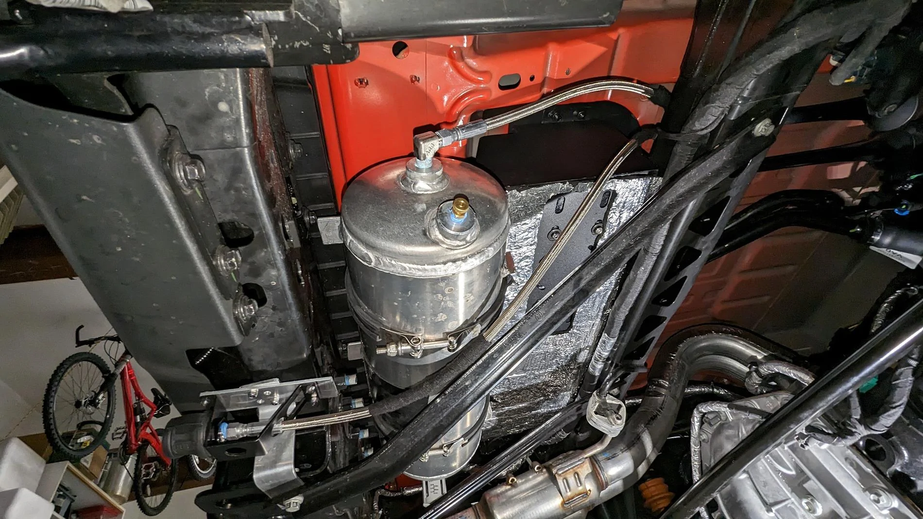

I went with ARB dual setup also - dropped into the rear cargo area via a DV8 Offroad storage tray and a 2 gallon storage tank. If you don't add an amp (see other pic) and you have the slideout tailgate - you get some storage room for air tools/accessories - I had fit a 25' air hose in that empty spot on the drivers side. Now I carry my tools/accessories in a harbor freight pelican type dry box. Don't mind the flux capacitor style relays on the right - that's my fancy air system/air horn disconnect setup up.
