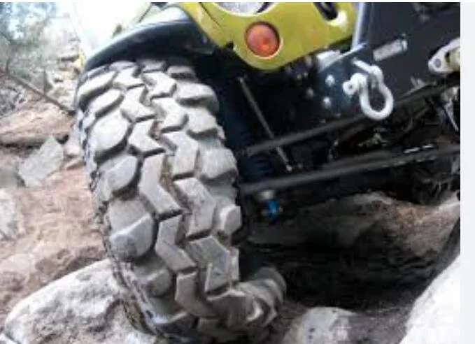

I would go with a more artistic approach. Once on the logging road, drop pressure to where you see the slightest change to a bulging state. Stop there and see how comfortable it is over the ruts and rocks. you shouldn't need dropped pressure for ability here. It is more for comfort. You can drop a bit more if it's still "too rough".
Same for street pressure, I wouldn't run those below 32#. I also don't think 39# is too high. Just performance and preference.
