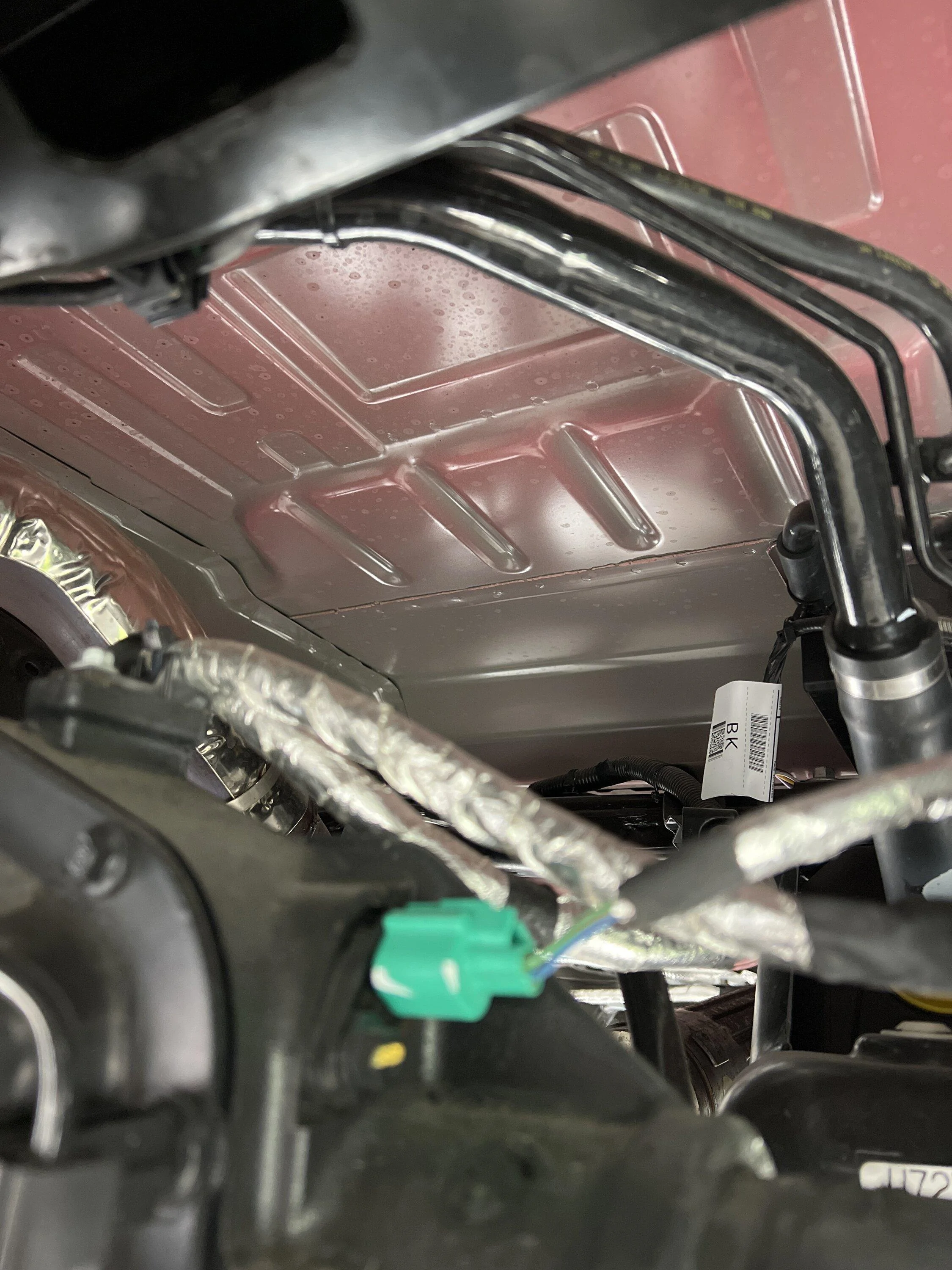

Looking at putting an ARB twin in my Bronco. Would like to also mount an air tank.
questions related to this:
1) Where are Good locations for mounting the tank if I do an under hood mount for the compressor? It looks like I could fit a small tank under the body, just forward of the rear diff on the driver side, immediately aft of the frame crossmember that’s right there. Anyone else do this? I’m curious about clearance at full compression on the driver’s side of the rear axle.
2) Does the ARB twin have a built in pressure switch? I’ve got a Viair on my Jeep TJ and it requires an external pressure switch on the tank and wired to the compressor. I just haven’t seen anything like that on the ARB side.
3) I see a lot of people running ARB compressors without manifolds, but ARB says you must use a manifold, even for inflation-only applications. What’s the deal with that?
pic is of proposed mounting location for tank. You can see the top of the rear diff in the bottom left corner, and the view is looking toward the front. I would mount to the ribbed area of the body floor in the center of the image

I'd go with a Viair twin/tank. They have kits with components that you know will work together. I was looking at the 20185.
As for mounting the tank that spot looks spot on.

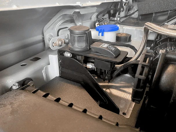

The ARB Twin has a built in pressure switch. When it reaches pressure it turns itself off. The ARB Single has one as well but it's NOT pre-installed. YOU Have to install it and it REQUIRES additional adapters (which are found in the pump up kit). But the Twin out of the box is ready to go.
So ARB likes to recommend a manifold because the air coming out of the compressor gets hot. However they've recently upgraded their hoses so they are reinforced now. I've never had an issue personally, especially with the new reinforced hoses. A manifold can help but is not required in my opinion IF running the newer hoses (which is what we sell these days and have sold since the beginning of the year).
Another option if you don't want to mess with a manifold, is to go with our switch/coupler kit. It puts a switch next to the compressor and also extens the hose about .5m away. So the air cools off in the first .5m (which is basically what a manifold does, where your hose isn't plugged directly into the compressor).
I don't run one and MOST of our customers don't run one. We've had a few people have burst hoses but they all ran the FIRST version of the arb hoses, which were not reinforced (again the new hoses we sell ARE reinforced).

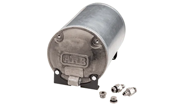

For a tank... wherever you can find a spot. If you are running a tank then you are not going to need a manifold since you're air will go TO the tank. You'll want T most likely somewhere so that you can connect your hose but again that'll be off a line first.
Basically you could use our switch kit and instead of going directly to the coupler off our included .5m hose, you go to a T first. One side goes to the coupler in our switch panel and then the other side goes down to your tank to store air. Mounting it is up to you and finding a spot that you can fit it in. we do sell the ARB tanks as well
Our compressor kit: https://www.4x4truckleds.com/kr-off-road-air-compressor-engine-bay-kit-for-2021-ford-bronco/

ARB Tank: https://www.4x4truckleds.com/arb-1-gallon-air-tank-4-ports/

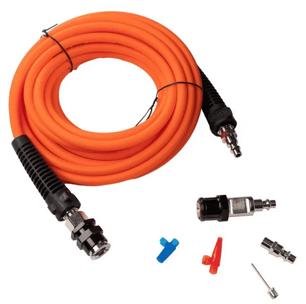

@4x4TruckLEDs.com do you know how to differentiate the old vs new hose? Yesterday, I just repaired my ARB hose for the second time. Definitely bursting from the heat. I bought mine Nov 2022.
That's most likely the original one. I believe we started shipping the new version in January of 2023 or so.
NEW HOSE
Ford Bronco Compressor questions - pressure switch, tank locations 1710054304384
OLD HOSE
Ford Bronco Compressor questions - pressure switch, tank locations 1710054359868
The new one has writing on the sides. The new box also has "V2" on the label
