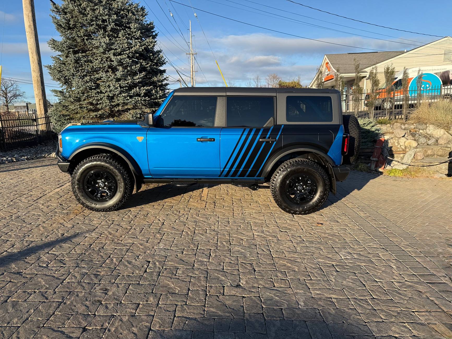

I have a 4dr badlands non SAS with 35” wildtrack wheels on it currenlty. I’m getting the Ford Performance 2” lift coilovers put on tomorrow. I’ve read thru this thread but a little confused now, what should i expect for lift height out of the ford performance coilovers on my non sas badlands? From what i read here it looks like I’ll gain about 3/4-1” over a stock SAS height and about 1-1.5” over current ride height?
