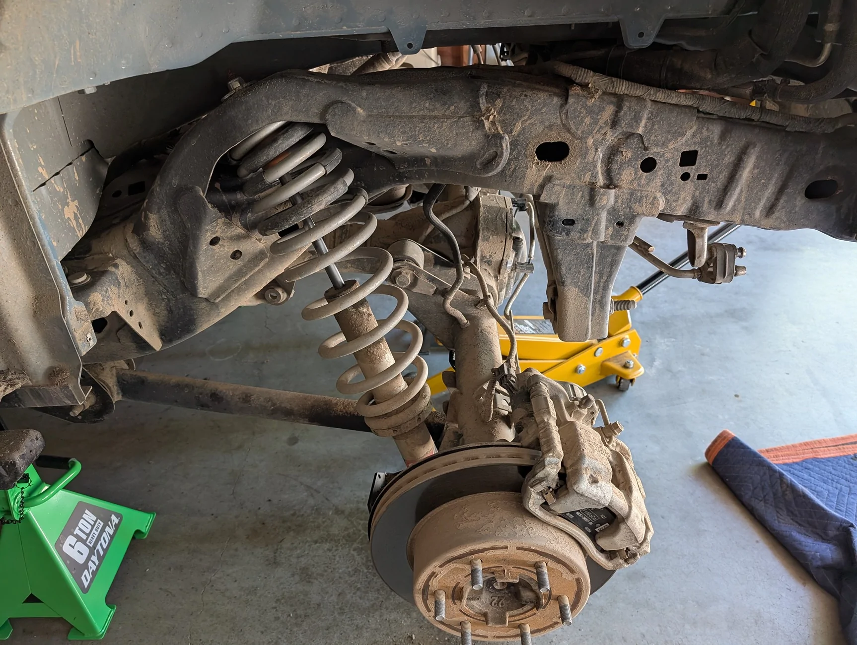

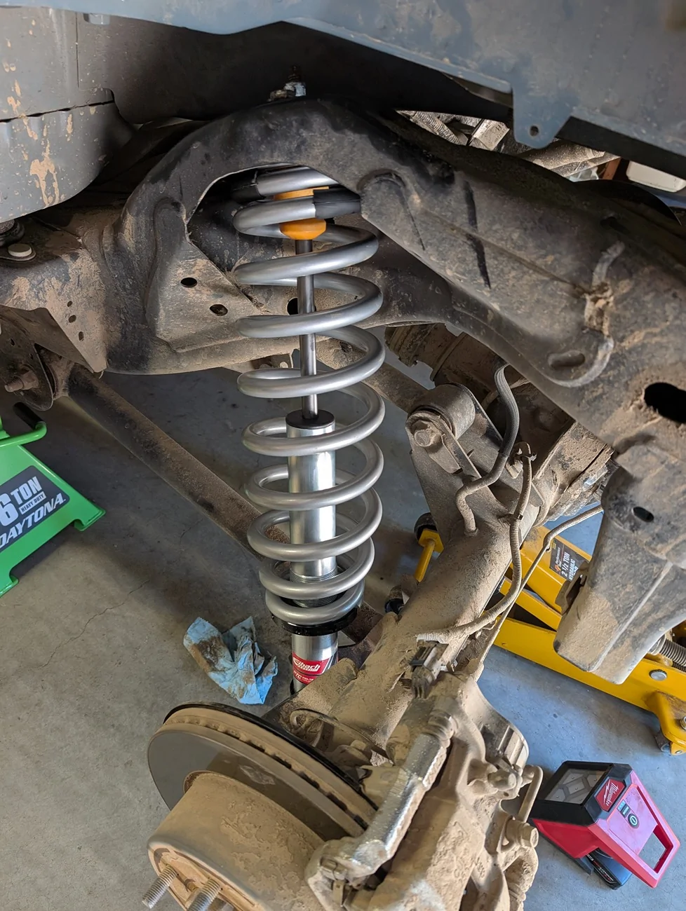

I'd say they are soft. It took me a bit to get used to it, but now with some time I have confidence in it. The springs are progressive, but the HD springs have very limited first stage wraps. The first pic is the rear standard spring I started with, the second is the HD spring. I had the HD spring on the front from the get go. A wee bit more compression damping in the rear would be good with my weight.

They are digressive like Bilstein. Which is why people some say more roll as they get softer the more they compress. Bronco is also heavy making them feel softer. Then add in shock angles and the 1.6 to 1 ratio on the front suspension you are getting a reduced dampening. Lot of reasons to buy 6100s over the 5100s and Eibach on this particular platform.
On a 4000lb 2 door jeep they are perfect because of the shocks being out boarded and near 1 to 1 motion ratio. This is why I went with softer Eibachs 2.0 over Bilsteins 5100. Also helps that I am only running small 33s (285/70R17) with aftermarket wheels which are heavy but not compared to true 35s and 37s. This is the reason so many people are happy with certain brands on other platforms but doesn't translate over to Broncos.
