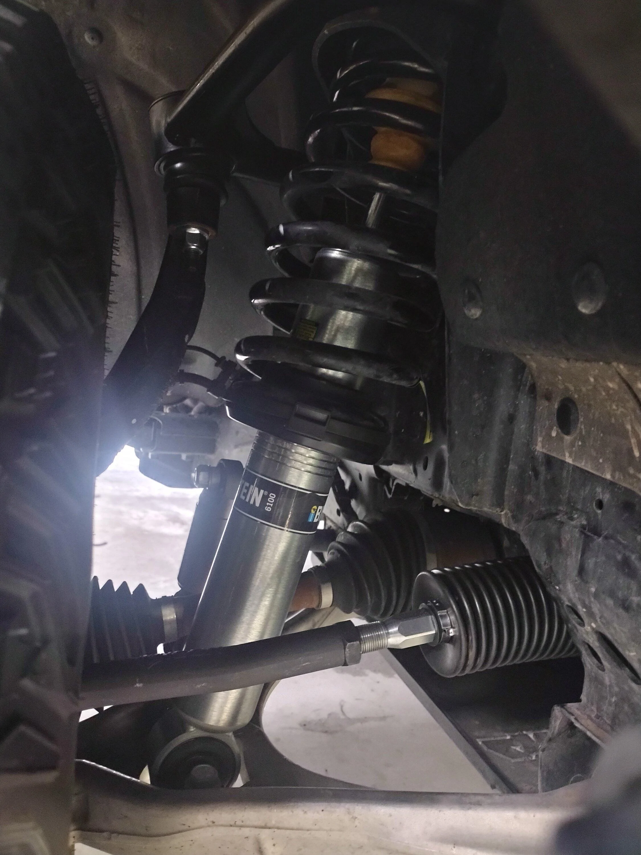

6112s from jeepandtruckparts.com
You get a 2.6 shock that won't nose dive when breaking rides much better than the 2.0 hoss and can be raised a total of 2+ in front and rear. Six different height adjustments. I did the 6100s and got rid of my 2.0s and it was perfect for good lift and level. Keeping 35s for now. They also have Fox 2.5s if you want to pay the price. Shock Surplus reviews all options and 6100s on there website article.

We just did the Bilstein 6100s on the front with Sasquatch Coils after installing a winch. Ride quality is still good. Great, cost effective lift. Another option is 4WP coilovers that actually cost less and have more adjustability.

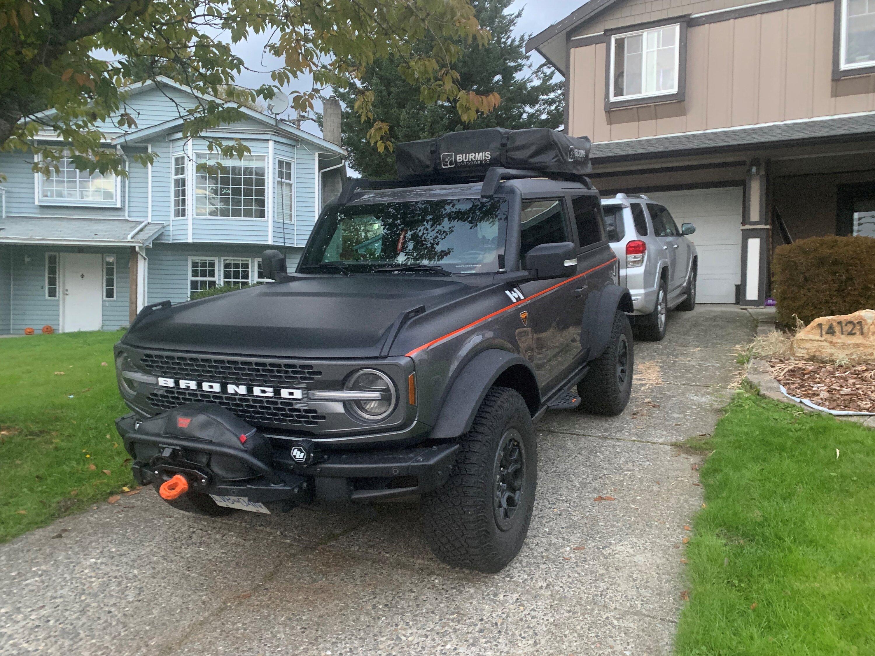

Any sag from adding the winch up front?
unfortunately, I didn’t take measurements before making the installations. However, the front is now 1 1/2 inches lower at the centerline of the fender flare versus the centerline of the rear fender flare. Again it was only an90 lb net difference so not a big issue and certainly nothing I’ve noticed on the road.
