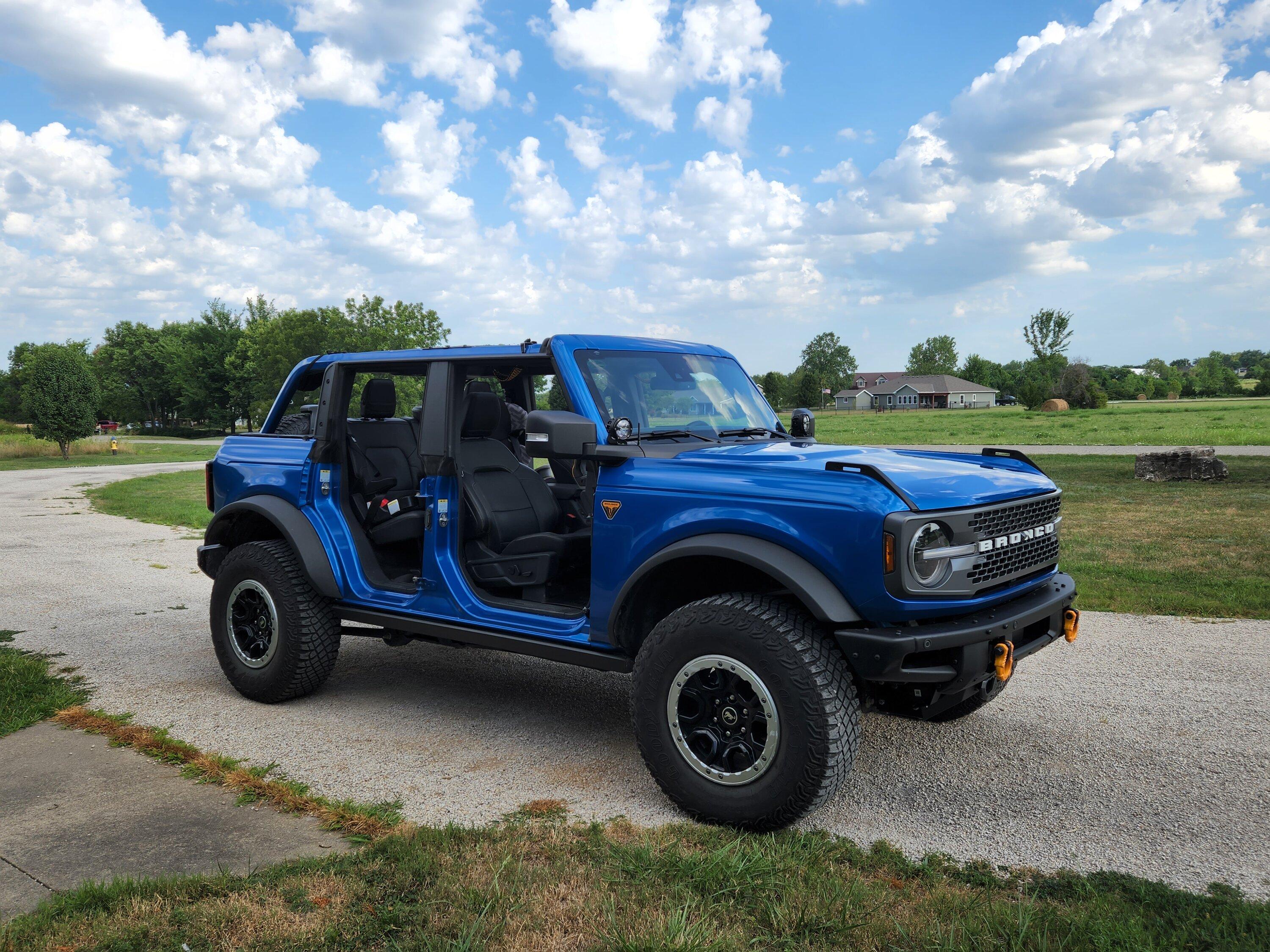

Yes, a leveling kit helps with the extra weight of a winch on the front. I have a RC 1" kit and with my winch, I'm at about the same height as stock. It's $60 and took a few hours to install.
1 Inch Leveling Kit | Ford Bronco 4WD (2021-2022) | Rough Country
The Eibach kit that other's mentioned is a great product (and I'm seriously considering it for my Bronco to fit 37's), BUT NOT A LEVELING KIT. OP asked about a leveling kit, not a $1700 after-market coil-over set.
This is what my Bronco looks like with the 1" RC leveling kit and my winch (hidden winch mount).
