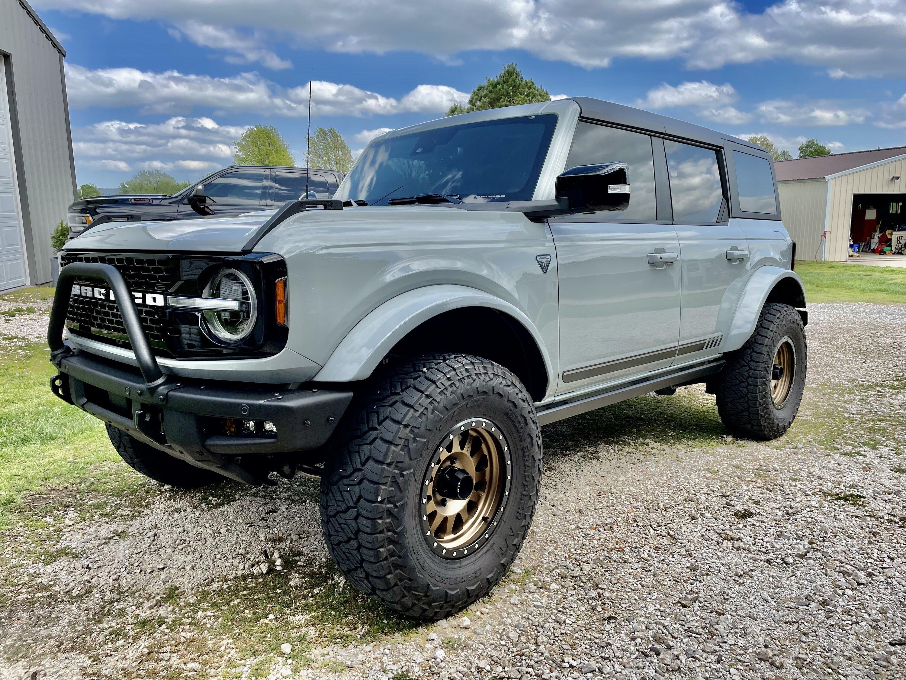

Went with the Fabtech 1.5 on my wife’s FE until Carli releases their kit for the Bronco.
Ford Bronco Front Leveling Kit options? 40695575-8234-4604-8FB6-65F3F947F56E

Hey guys, I noticed the Bronco has a slight front-rake. What are the options to even out the stance. Would it be a 1'' front spacer? What are you all doing?
First I'll say that some have some rake and some you'd really have to be looking for it. It's not like an F150 with very noticeable rake, so I think some believe it's needed based, on past trucks.
Anytime I'm seen an actual side photo ( on a flat surface) of someone who installed over a 1" level kit, they have a very noticeable Carolina squat going, IMO that looks horrible...some love it....like truck nutz, 20's, and fart cans. You do you.

With one 180 pound person in the driver’s seat, my 1.25” leveling kit gives me 1/4” less clearance (fender flare to tire)on the fronts than it does on the rears. If I ad a winch and/or something like a “safari” bar, the front will sit even lower. Many adding a leveling kit do it because the rake becomes more pronounced once you start adding the extra stuff to the front of the vehicle.
