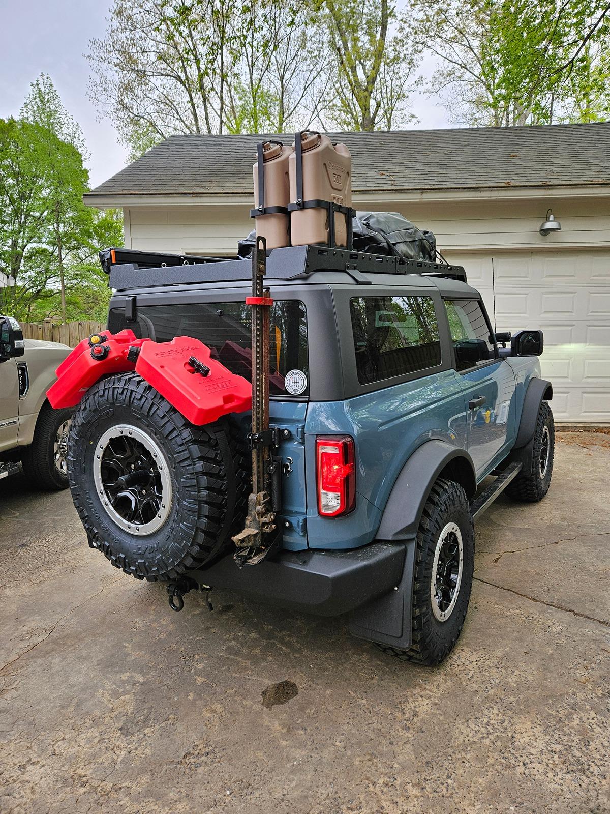

I have the eibach pro lift springs over SAS struts. Manufacture says I have 1.6” of rear lift in addition to the 2.3” front lift (I think this was closer to less than 2” in the rear to be honest). Problem is I’m basically level now so the moment I put any weight in the rear I have the Carolina squat. Can I add a spring spacer to lift the rear ~1”? at what point would I need or know I need a adjustable track bar? Can I use any “leveling” spacer like readylift or fabtech designed for the front on the rear shocks? Pics for fun
overlanding gear was messing up my "Stance"

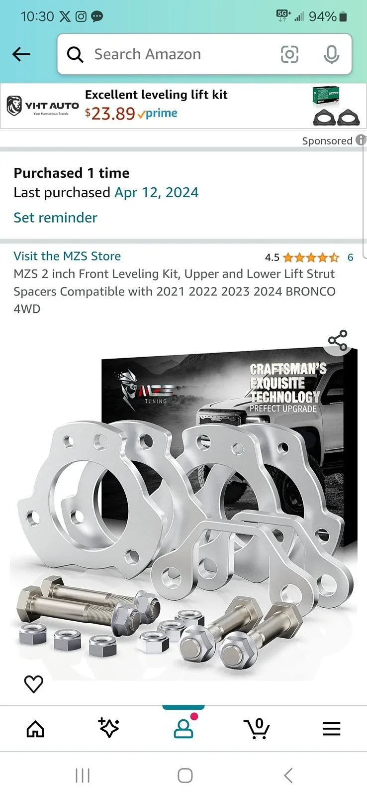

I just did this to the rear and did not want to drop too much coin.. It added about 3/4 inch of lift to offset for weight squat. Originally ordered 1" composite spacer but decided against due to droop/ tension under articulation would destroy it. I ordered cheap kit from amazon.
Ford Bronco Adding a front leveling kit to the rear? Screenshot_20240413_223054_Amazon Shopping

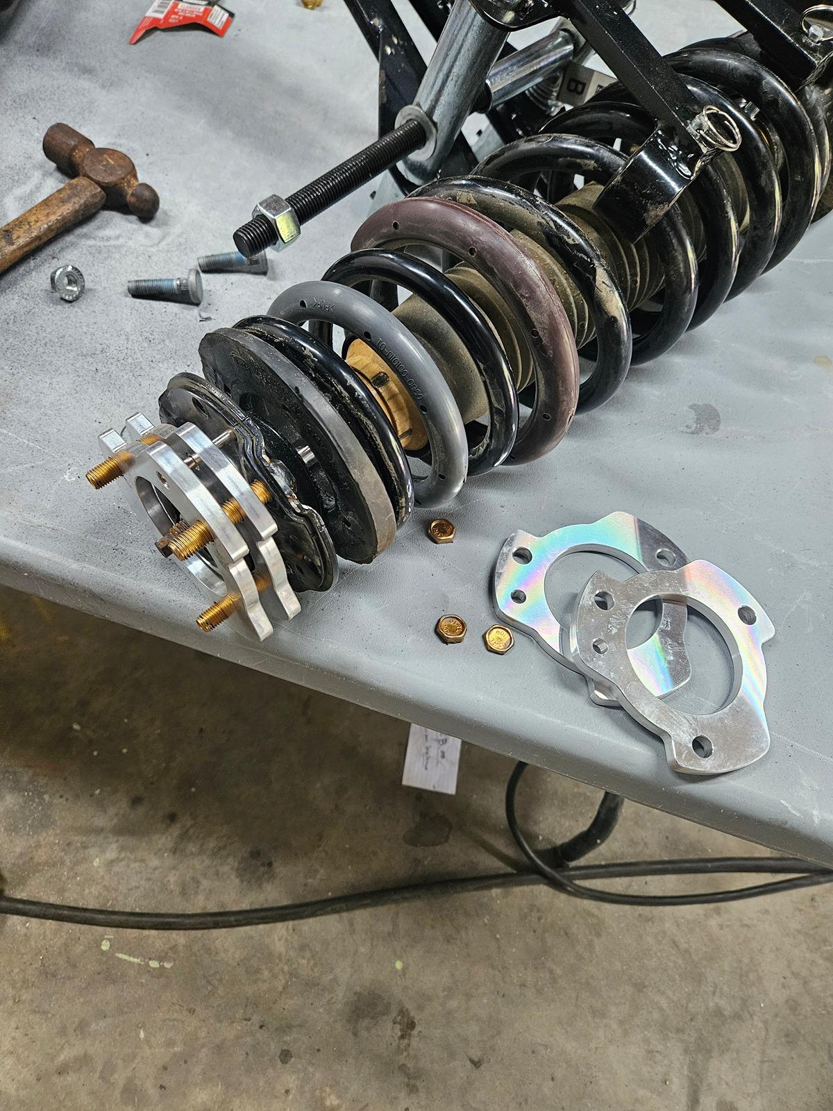

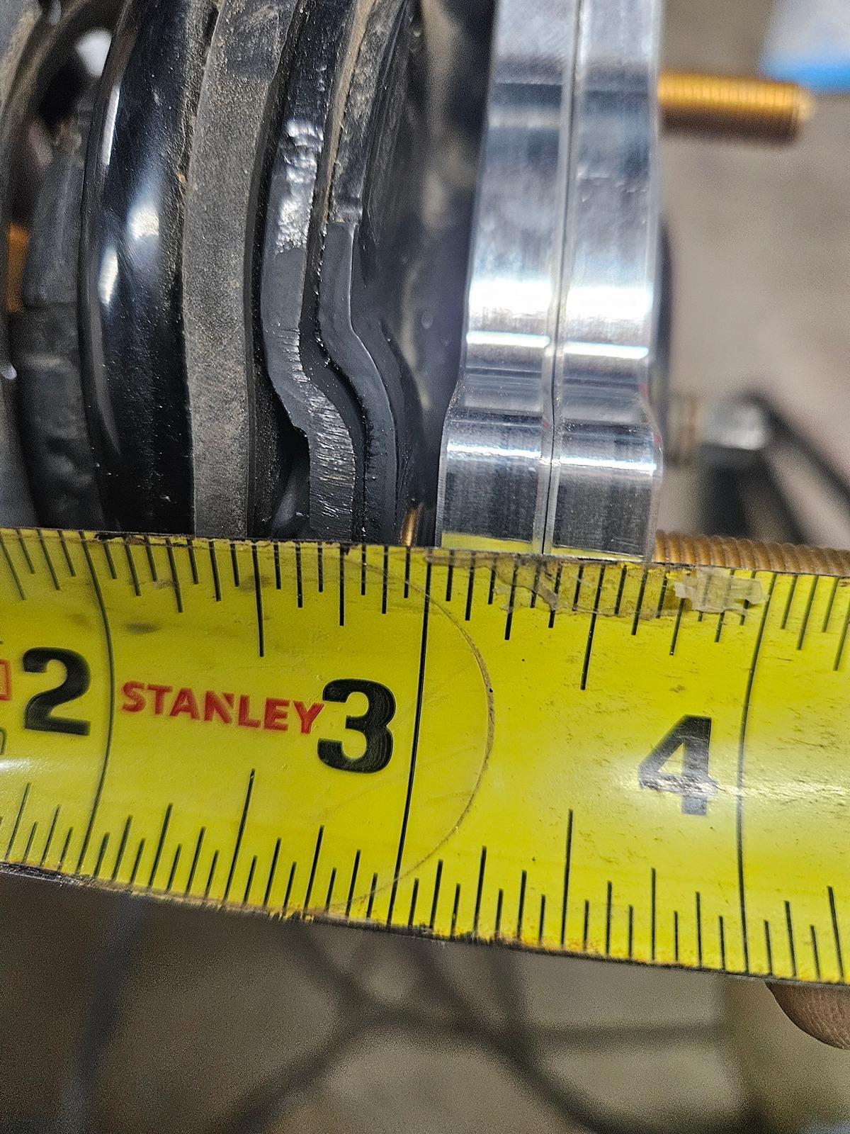

you can get 1 spacer on each side with factory strut bolts which adds about 3/8 inch. pretty easy but wanted to stack 2 plates per side. It sucked because I needed to compress the spring and install longer bolts
50mm
Ford Bronco Adding a front leveling kit to the rear? 20240413_144301

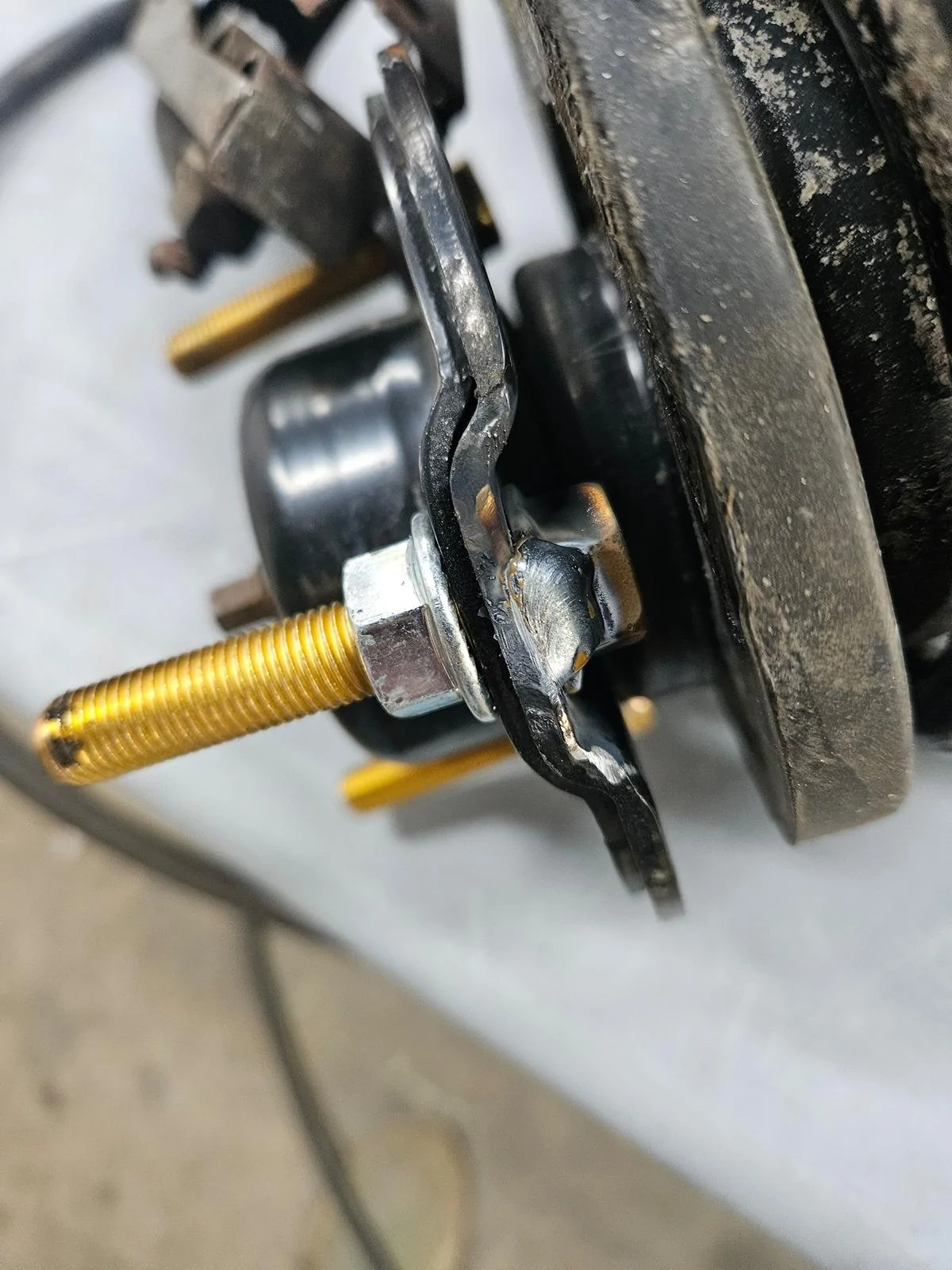

ground a side off the bolt to allow room to weld bolt to upper strut. Dont skip the weld or the bolt will freespin at some time in the future removal and there is no way to access under the coil bucket. Tech tip.. Run a nut on tight before you weld to keep the bolt true.
Ford Bronco Adding a front leveling kit to the rear? 20240413_144938

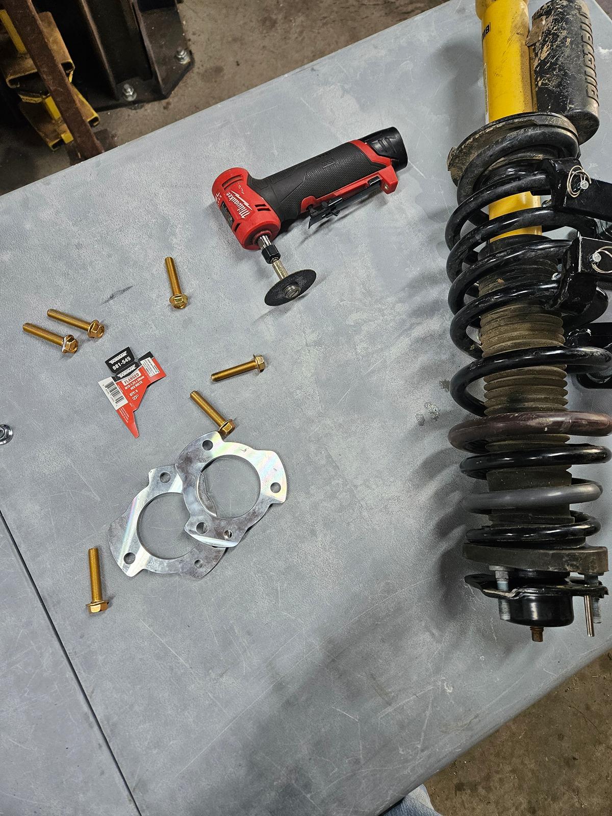

use cut of wheel to flush the back of bolt with indent to clear rubber spacer
Ford Bronco Adding a front leveling kit to the rear? 20240413_145849
Ford Bronco Adding a front leveling kit to the rear? 20240413_160457
double up spacers and install using factory nuts and you got your squat handled without it looking jacked up if you go with a 1 or 1.5 spacer when unloaded.
