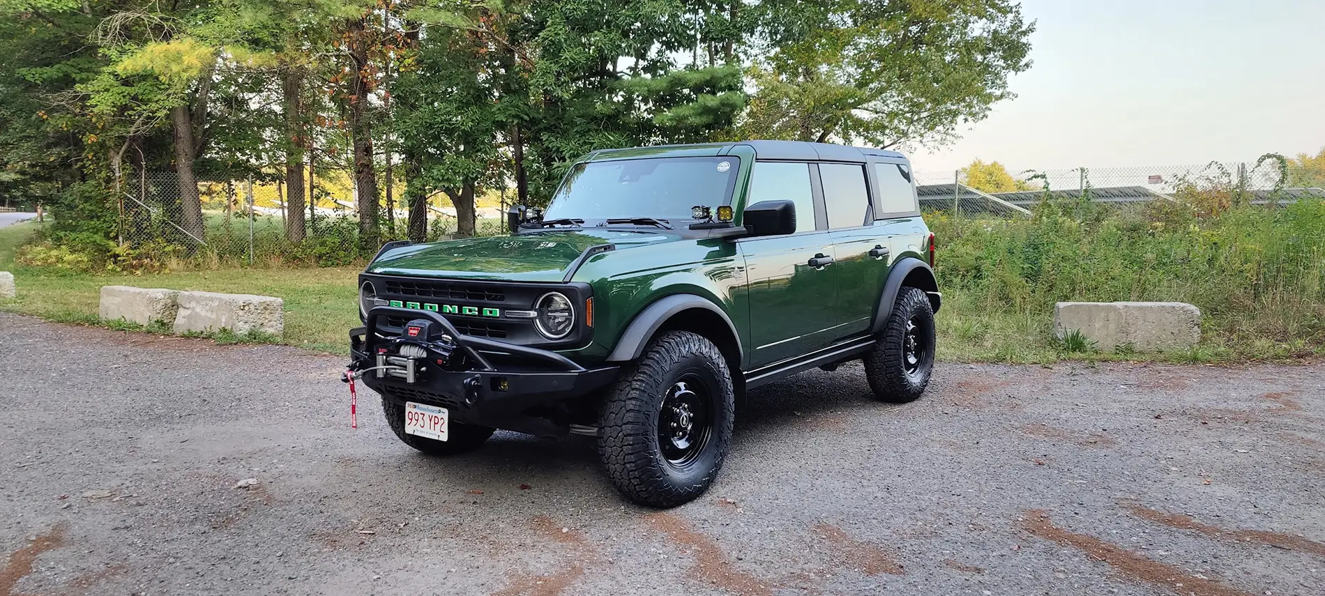

Sorry for the delayed response, and thanks for the feedback.
After I brought my Bronco in, they determined that both front lower control arms needed replacement (another tech later suggested ball joints, but either way, both LCAs were replaced). When the Bronco was parked and running, it would creak consistently while turning the steering wheel in either direction. That issue has since been resolved.
Before the creaking became constant, there was also an intermittent, fairly loud “ping” coming from the front end. I couldn’t determine whether it was coming from the wheels or more centrally near the front axle. It almost always occurred after being stopped or parked, right as I began moving again—especially if the wheels were turned. They were unable to replicate this noise, so no action was taken.
I do take the Bronco off-road fairly often, but I do not consider my use aggressive or excessively stressful. I did experience two front differential failures previously, which I believe were due to a design flaw in the system rather than abuse.

Soundls like you bought an abused previously owned first productions series vehicle.
S550 Mustang front LCA often fail at 30K miles with regular use so not unheard of.
Frequent mild offroad use should not accelerate wear much, however, with a load and on gmarly roads it will over many miles.
Most of the time its upper damper assy bearing failure first.
LCA are realtively cheap and fast / easy to change just get new OE ones since you dont really know what youre getting with aftermarket and warranty support is seriously hit and miss.

I am the original owner. I did put a lot of miles on it over a short period when I took it from MA to the Rockies. Towing the pop-up along the way.

Maybe ita a rebuild worth getiing the frame geometry checked at body shop but seems to be under warranty still....
