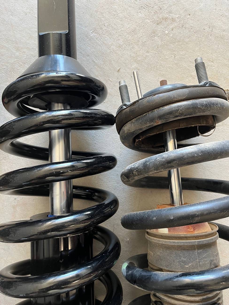

So far so good! Did my maiden voyage yesterday, heading up to CDT trail today. The Bronco feels great over slow speed and rocks. I ended up going with clip 5 front and back. I had clip 6 front and 5 in the back but the Bronco was too nose high and drove floaty without the rake. Now I have slightly under 1 inch of rake and the steering response is perfect. The suspension did settle some after getting some miles on them. Maybe it settled about a half inch or inch. I will take some measurements and pictures later today after my adventure. I will be solo so might be a difficult to get action shots but I will try my best. Biggest thing I noticed was I’m not scraping as much in the front and gas tank, the Bronco also feels less tippy and more in control that might be from my new control arms. Then I am able to go a bit quicker on the trail and not bottoming out so much on the front end. The stock suspension would constantly bottom out and feel like a pogo stick. With the 6112 it feels almost sport car like. Doesn’t dive, feels firm but not too harsh, going around corners on highway I can carry speed on the trail. Overall great upgrade. For most things I do the 6112s are a excellent upgrade. Reservoir shock would be overkill for slow speed rock crawling. Yeah it be nice to slightly adjust the compression so my Bronco is a tad bit softer on the rocks, but I honestly don’t need it. I do want the 8112s, but not necessary, maybe I might upgrade in a few years once they work out the bugs or another company hits my fancy.
You will need new control arms however what I learned from this upgrade if you want any decent lift for your Sasquatch Bronco. I had 2 professional 4x4 shops try and align my Bronco after the lift and they couldn’t get the caster over 2.2degrees while maintaining camber. My steering felt very float, light, and then didn’t return to center very quickly. Shop recommended high caster control arms. I got JBA control arms and so far they have been excellent. Steering returns to center very quickly even in 4 low going over rocks and it’s not so tiring driving the Bronco.

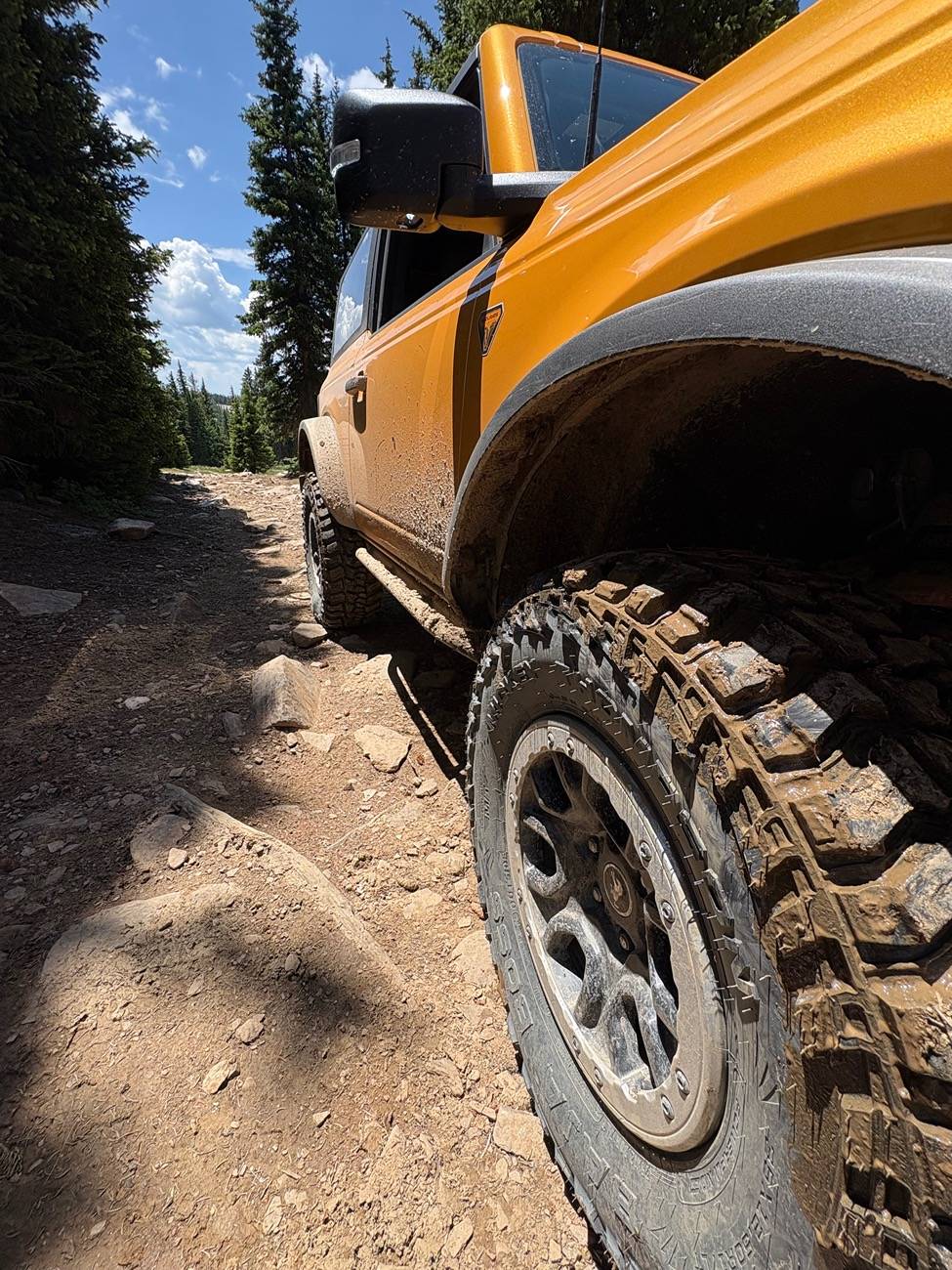

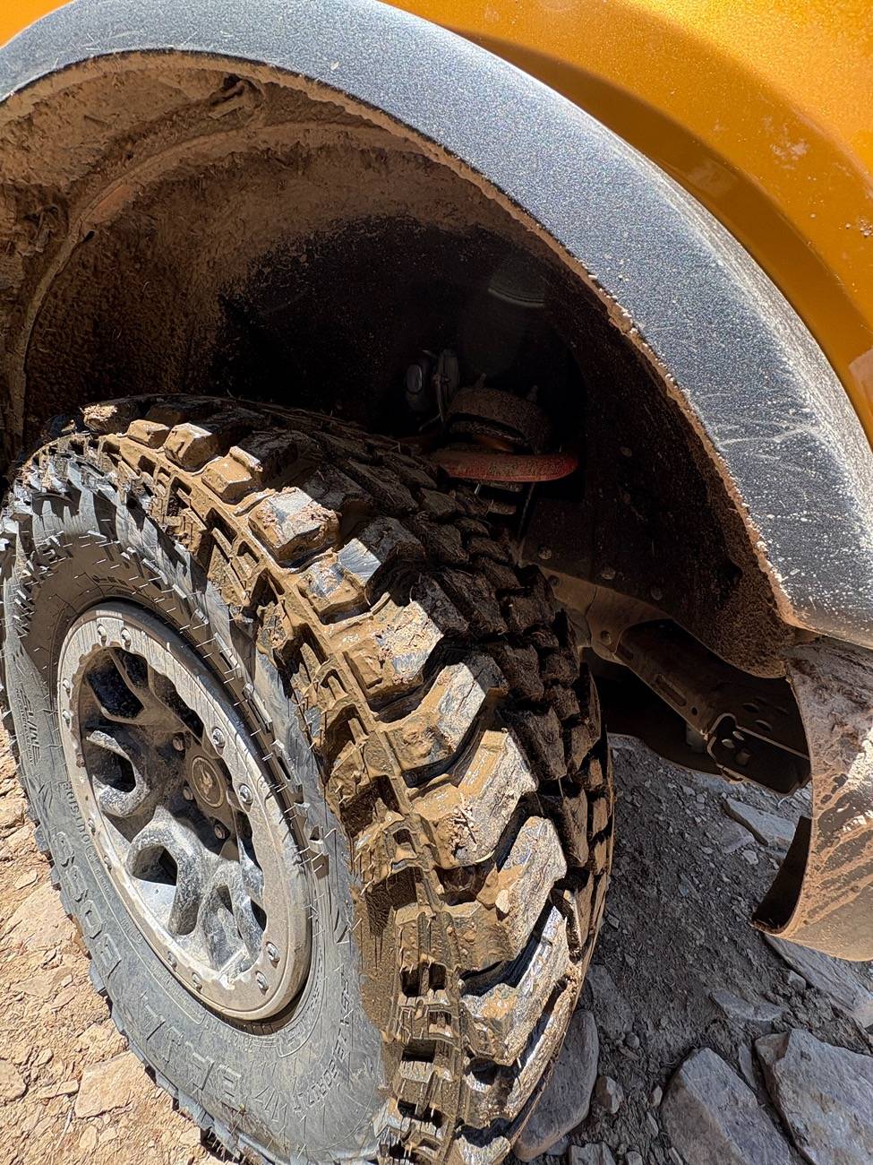

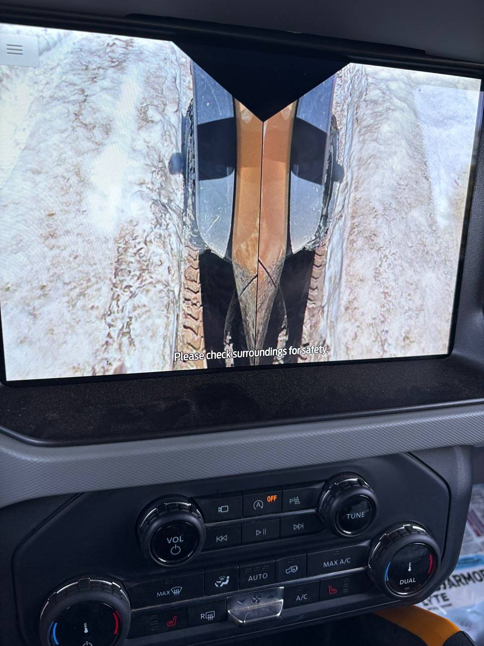

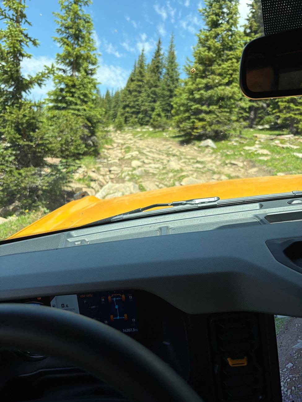

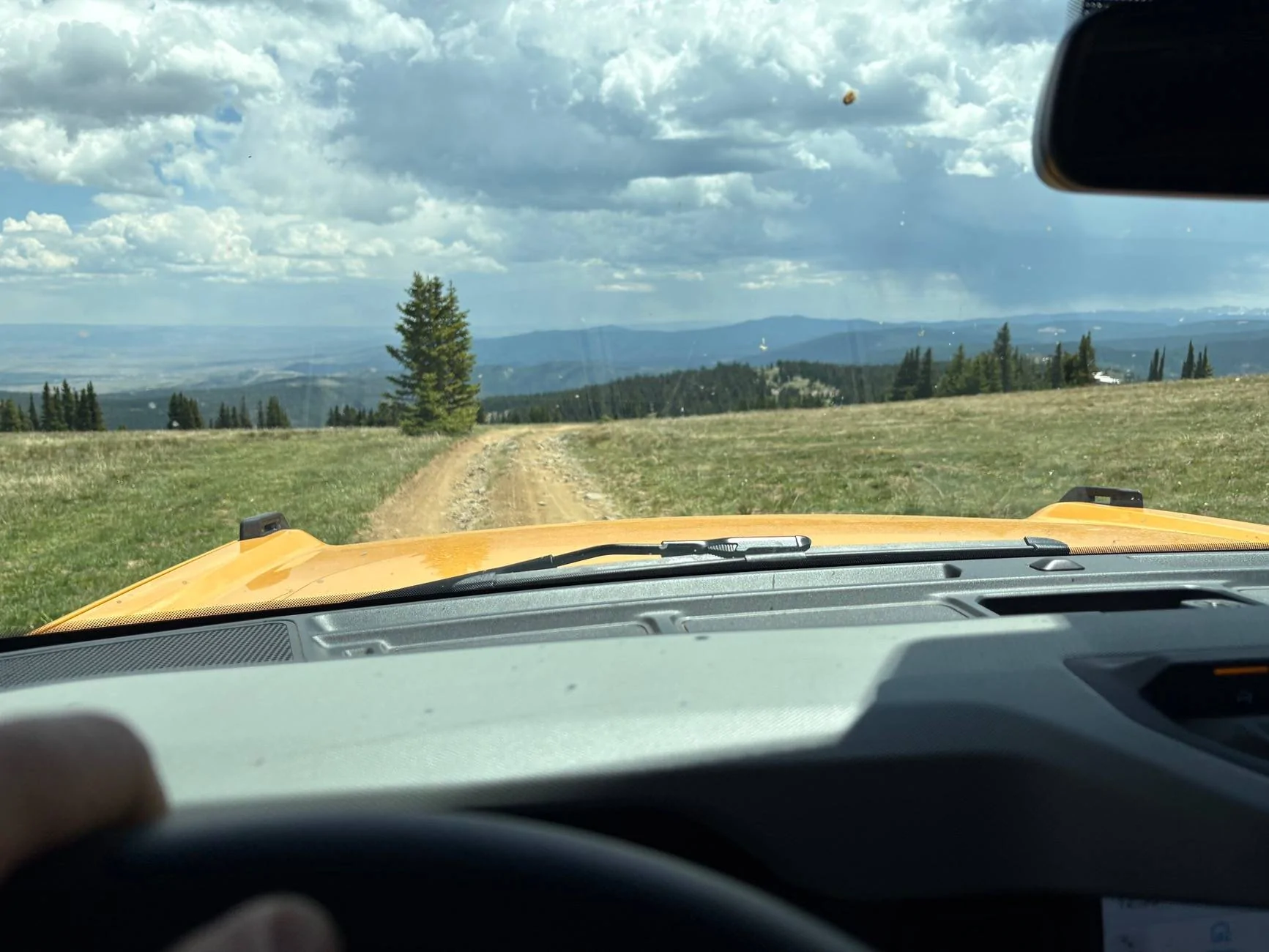

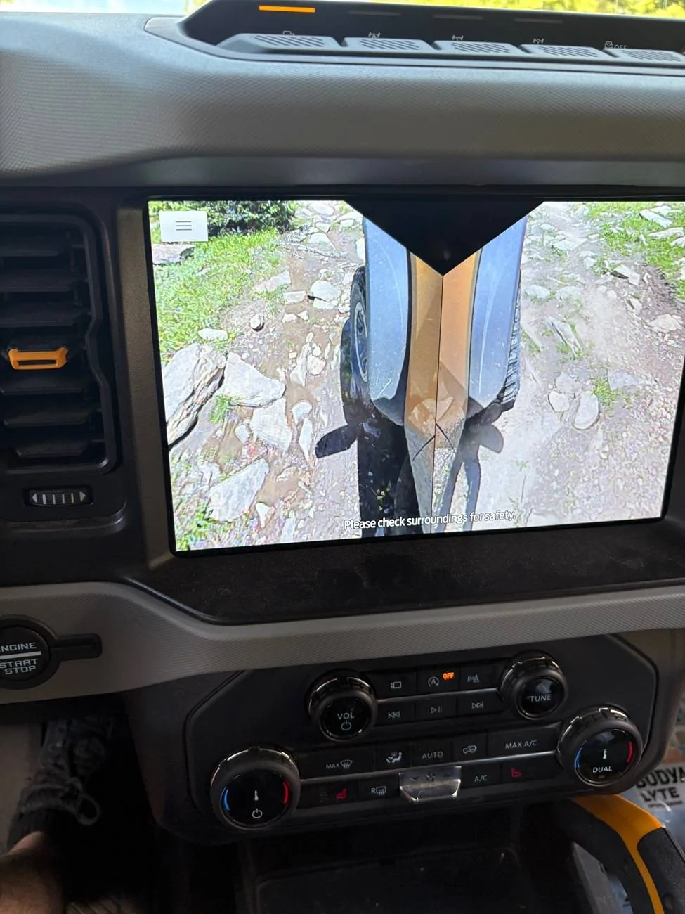

Well my pics suck but here ya go. 6112s did excellent. Sporty on the highway, feels firm but not harsh on the trail. I can pick up speed and not pogo or bottom out like the stock shocks. Feels very composed at slow speeds. Had to bust through some snow drifts. Hard to do action shots when solo. Average about 1-2mph on the rocks then picked up the speed to a whopping 7-9mph. It’s a fairly slow trail do to the elevation around 11k ft. As you start to go down elevation the trail smooths out. Mostly SXS and 4wheelers do this trail in Southern Wyoming. It’s a blast in Bronco!
