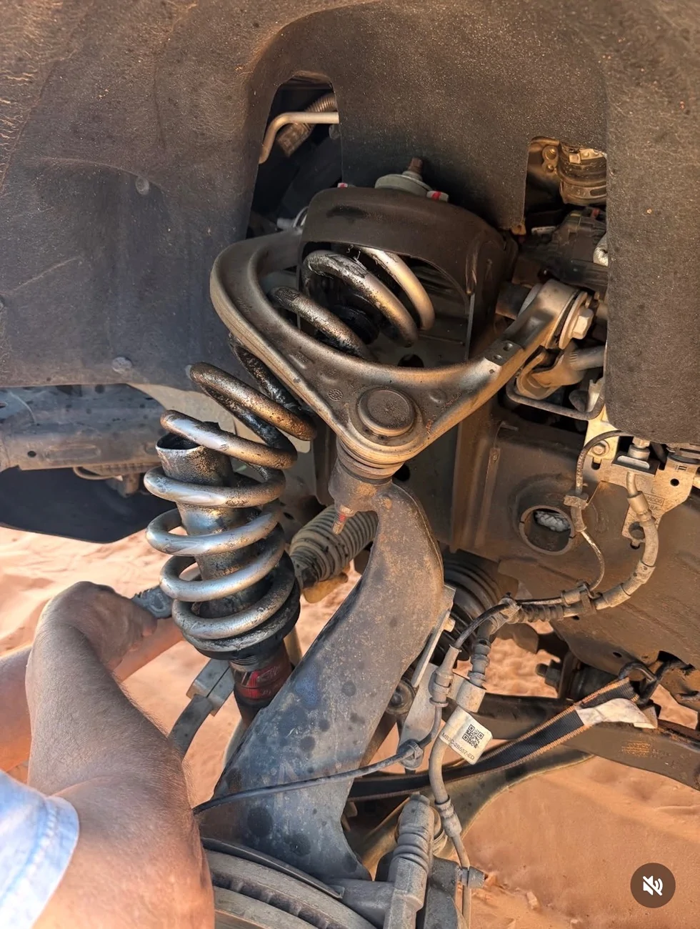

The important thing to keep in mind is that coilovers don’t break, so it’s unnecessary to do anything stronger than whatever size the company saying things like “coilovers don’t break” uses.
How TF did it snap in half with such a clean cut?? 🤔
I was going to say ORI too but not because I know better just because they're shiny and look nifty. 🤩
Brian_B
Sep 14, 2023
64
8,793
15,698
Central CA
Looks like it overextended and there wasn't a stop to keep it from just pulling apart?

I was told with authority by a shock manufacturer, on this very forum, that this isn’t a problem…
