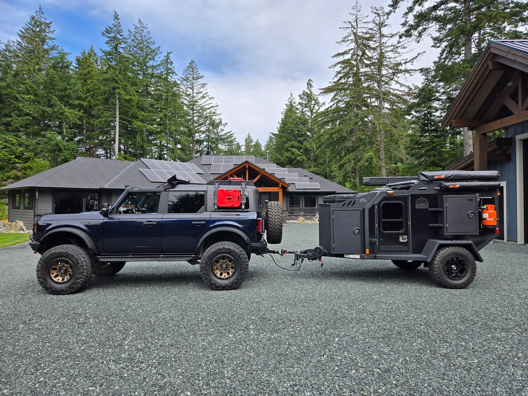

We have a 2021 Ford Bronco - Badlands with Sasquach pkg & Warn front winch.
Currently the shocks/coils are stock (Bilstein ESC-V)
As you all know, these shock have been notorious for the attached reservoirs to leak and/or fall off.
Aftermarket suspension changes that have been done so far:
I would like to upgrade/replace the stock shocks/coils with something better, BUT not make the bronco any taller.
I work from home - so not a daily driver but we do take it on road trips (pavement).
We do get out for a decent bit of off-roading. Mainly aggressive rock crawling/trails etc (not any fast offroading stuff like Baja).
We have a off road trailer we haul for off road camping (2022 Off-Grid - Expedition 2.0) https://ca.offgridtrailers.com/pages/expedition
and hope to road trip down to MOAB one day soon :)
Ford Bronco Suggestions for Replacing Shocks/Coils for our specific uses 1000037511
my question (s)...
what shocks/coilovers would you recommend to replace the Bilstein with, accounting for our current setup, off roading preferences & towing a trailer??

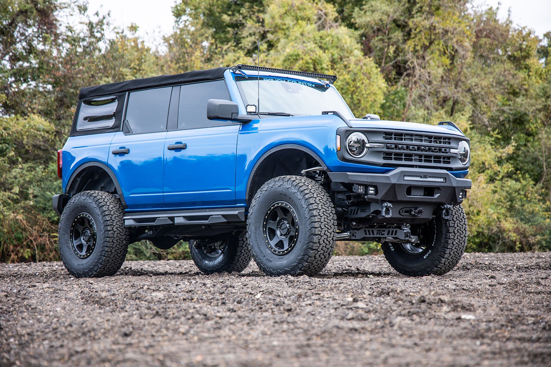

There is nothing wrong with the RC lift to start with. I have a 5" RC lift and the only downside I have found is the uca's. The point of that lift is to lower the front suspension entirely creating less drastic angles.
Brian_B
Sep 14, 2023
65
9,017
16,103
Central CA
Well it does have that front cross member and a diff drop to help keep the angles in check.
But that front cross member and diff drop also eat up a lot of the clearance gain you got with the bigger tires.... I'm just eyeballing it from the pics on their web site - it looks like it comes down what, 3 - 4" from the stock LCA mounting spot. So to make up from that, using my back of the envelope non-geometric redneck math - coming from 35s you'd need to run a 41"+ tire just to get back to the same amount of clearance you had before adding in that cross member.
So I guess I'd say there's nothing wrong if your goal is just to run bigger tires for the sake of looks. Which - don't get me wrong - nothing wrong with that. Just as long as you realize it isn't the same as something actually intended for going someplace where you'd want the clearance afforded by running larger tires.
