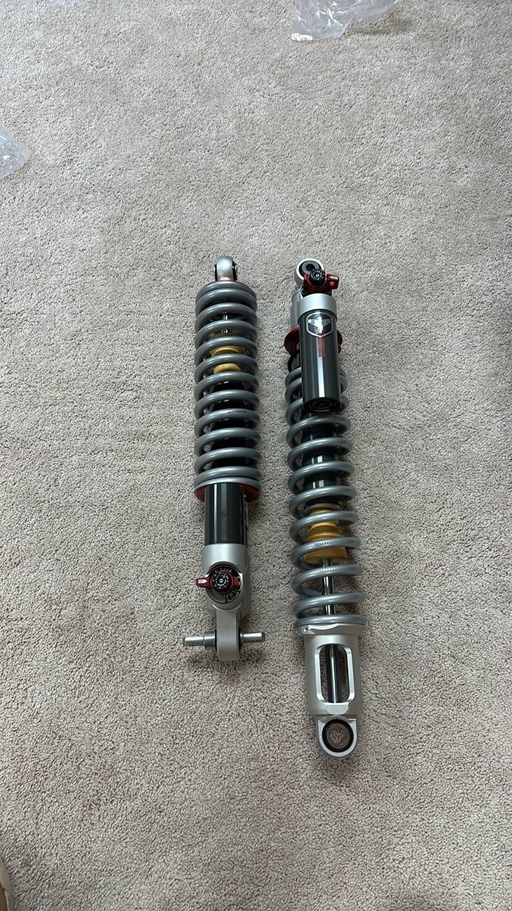

Appreciate the tag.
I agree with your summary. In terms of CV bind, I think the highest risk suspension are the ICONs - I think we all know this too, as an anecdote and single data point, so far the only CV break I've seen happen in person was on a bronco with ICONS. I think you're generally safe with most other options. One thing I've noticed installing various front suspension on the bronco is how much force the suspension does or does not put on the LCA when in full droop. For sure anything using a spacer/puck these forces are very high, and I think your odds of breaking a CV are also higher. I'm also positive you can't install a puck lift by removing the bushing bolts on the LCA and must go the axle nut removal route. 6112s and eibachs seem to naturally stop where the LCA binds and the Falcons needed a slight push up. Made them easer to install, but in my view less likely to bind a CV.
I've been extremely happy with the falcons so far, and I also feel good saying per $ spent I believe the Falcons offer some of the of the best value. Not saying you can't get more out of some Kings or other high end suspension. However with the added track bar bracket, and brake line relocation kit on top of all the features in the suspension alone including adjustability and full piggyback reservoirs they're a good deal.
The only decision to make when it comes to the Falcons is do you go with the "mid travel" for 37's or the "max performance" for 35s and just install 37s anyway. So far I'm not aware of any rubbing (JCR kit and rear track bar) as I went the max performance and near true to size Yokohama Mts , but I also don't do the fast whoops and stuff. That said, watch this newest clip where the Falcons go head to head with some similarly priced options on the Tacoma and maybe whoops are in the future?

You do need wheels that have more backspacing to clear the shock adjustment and reservoirs. Maybe they could have changed this up but personally I love the placement. Super easy to reach and change when I want. Much better than the front which has fewer options.
The gas tank should be trimmed, I did mine, that said on the 2-door I’m not 100% sure the drive shaft can make contact here. If you plan to do rear control arms you’re basically going to remove the skid plate anyway so for me it was not much extra work. My guess is if you run stock control arms this might be a none issue. In my view any long travel suspension/increase in rear articulation should have you doing this. I view it as Falcon just did more R&D to address the contact areas.
You are 100% correct that the Falcons do have more requirements then most, but most folks going this way are going 0 offset wheels anyway for the clearance and wider stance and probably don’t mind the labor. I appreciated the complete kit and clear instructions.

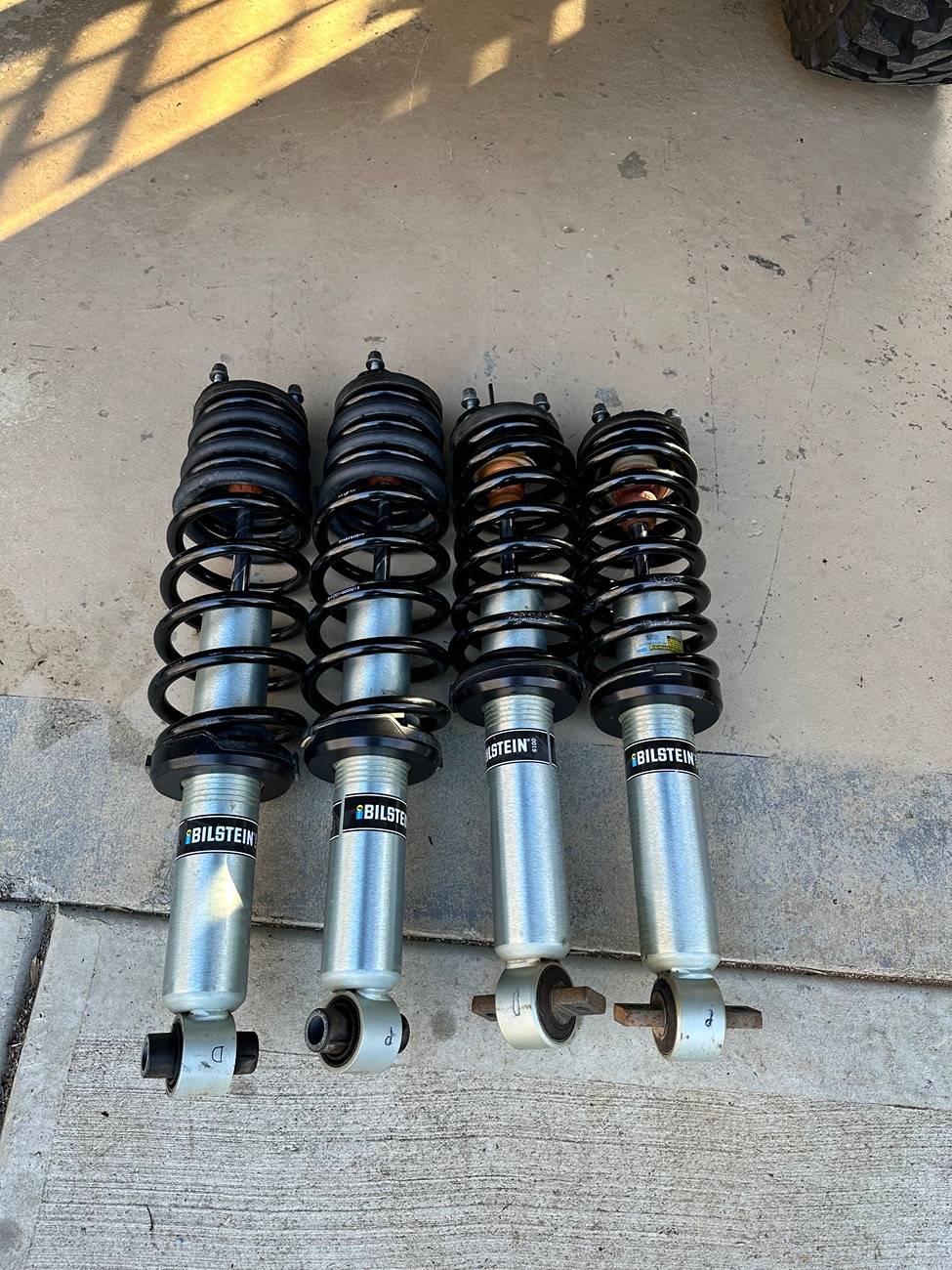

I have to disagree, there is considerable travel to be gained between the “best and worst shocks.” Yes the front is somewhat limited, but keeping considerations/options within the stock mounting locations there is ~10% front travel and >40% rear travel to be gained just by selecting the appropriate suspension. Bilsteins 6112 are a good coilover but run stock to less than stock suspension stroke up front and only marginally increased travel in the rear. Most offering with some exceptions provide longer coilover travel. (King, Icon, ADS, Falcon, Rock Krawler, etc.)
Long travel mods are certainly a way to extend travel even further but through mods most of us are unwilling to do (yet).
There are others examples but these are are two brands I have direct experience with and I wish I had these in the same photo, but simply compare an increased travel rear suspension like the Falcon vs the 6112 and the difference it’s pretty obvious. Even accounting for the area of the falcon that extends beyond the shock tower there is still ~3in in length on the 6112 for rear travel.
