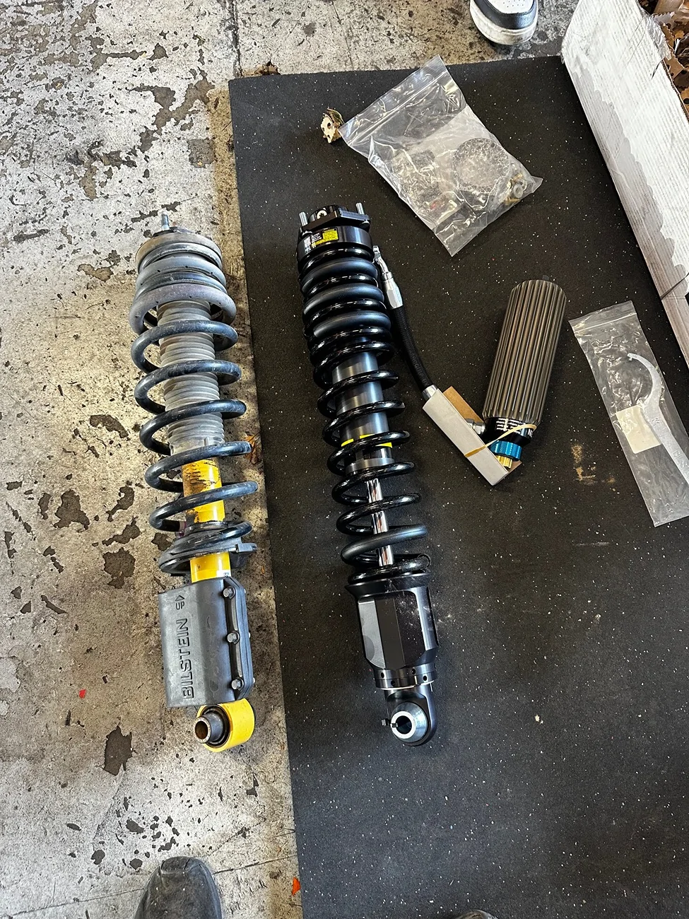

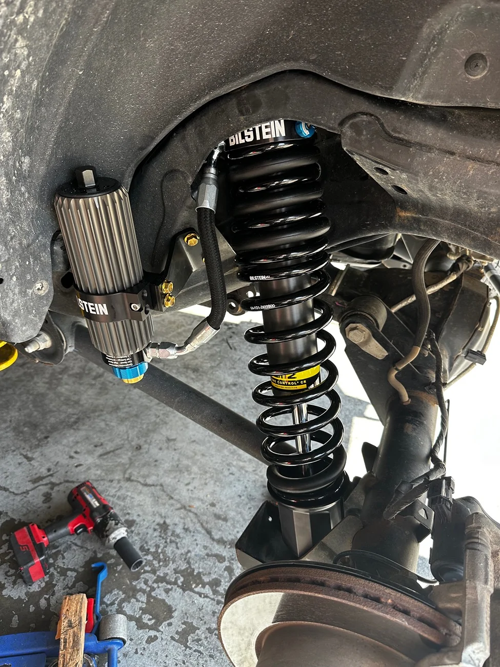

Bilstein 8112 install in progress on my non-sas Badlands 4dr. More to report in late October after off-roading them. Also includes upgrade to 35s (Falken Wildpeak at4) and Method bead grip +25 wheels.
Feel free to play with these in the dirt. I took the liberty of tuning and dialing the settings, listed them here.
