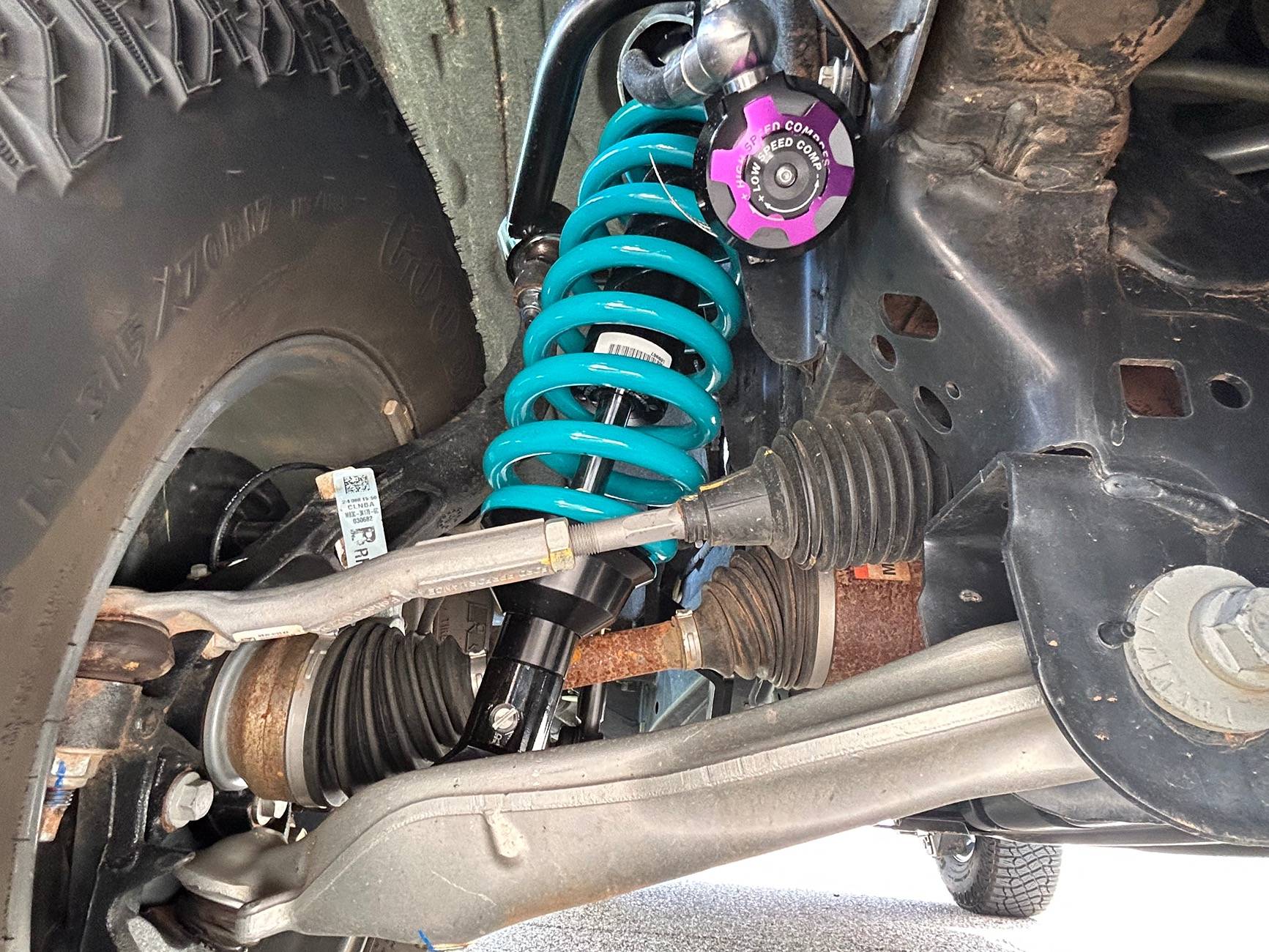

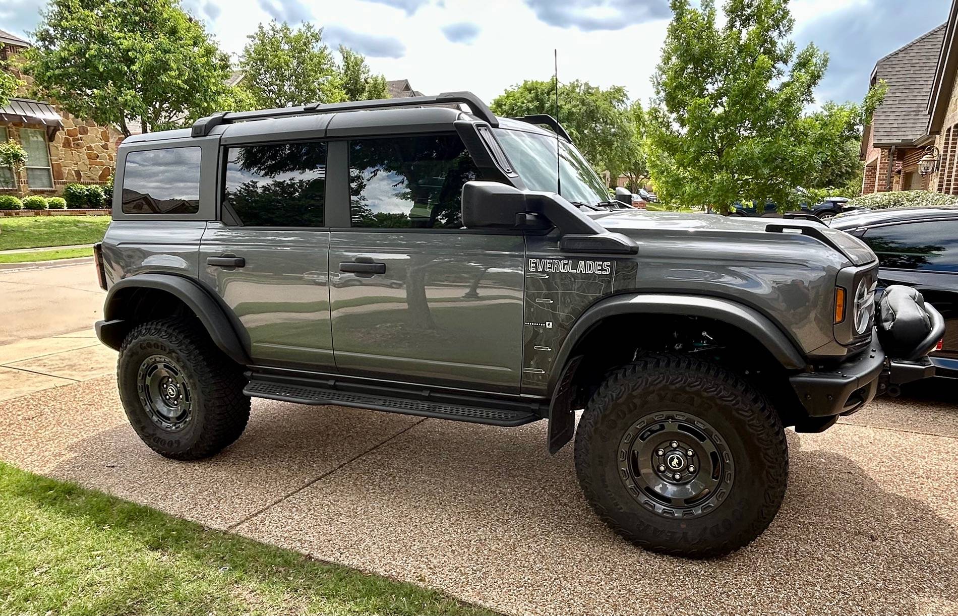

Ford Bronco 2025 Suspension Recommendations (by Snacktime) IMG_0408
Ford Bronco 2025 Suspension Recommendations (by Snacktime) IMG_0411
Ford Bronco 2025 Suspension Recommendations (by Snacktime) IMG_0410
Here are a few I did not install diff drop but may add. The shop that installed said angles were fine. Also shock vendor said not required.
It looks great with the extra height. I wonder how much droop you have in the front now. The angle looks ok at rest. Are you going to be able to measure how much droop you get compared to stock?
Thanks, I’ll get measurements this next weekend.

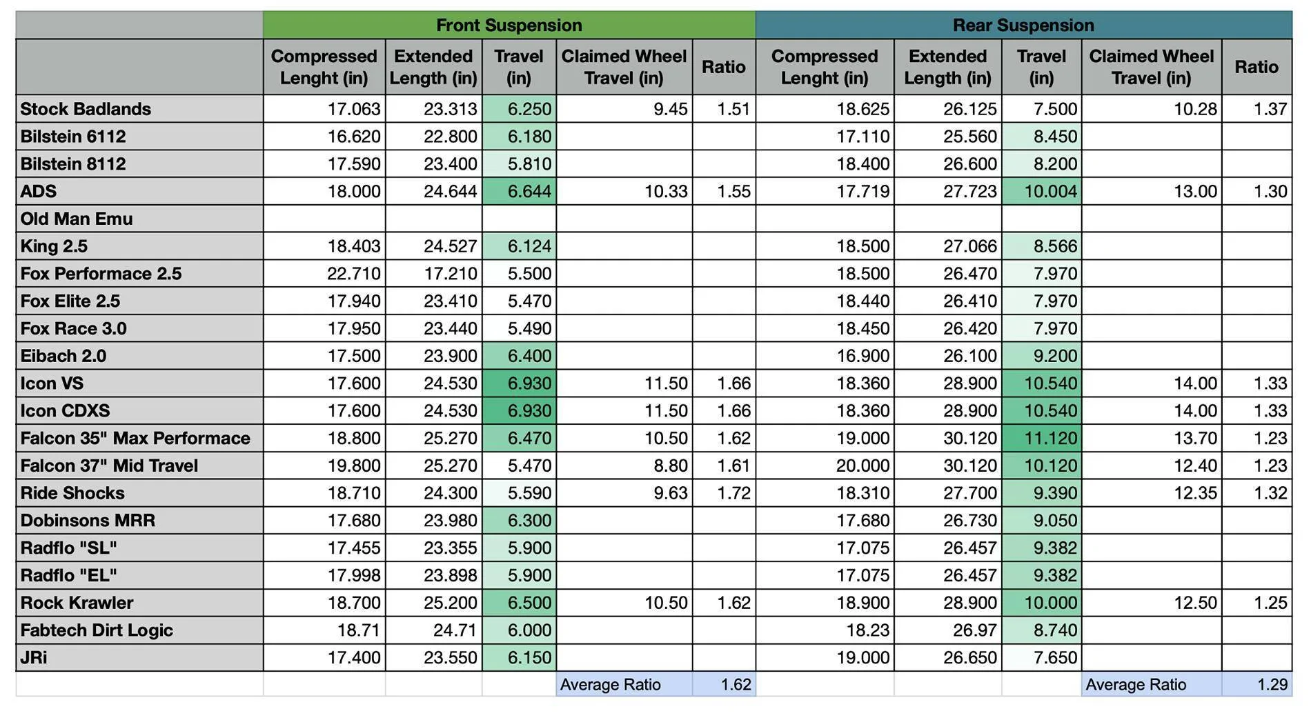

It's not everyone's cup of tea, but I have the Broncbuster 1.5" shock spacers and 315's on my Badlands. It sits about an inch higher than a Squatch.
Spreadsheet for specs if you care. Add 1.5" to the BL shocks and lengths are in the ballpark of the aftermarket.
