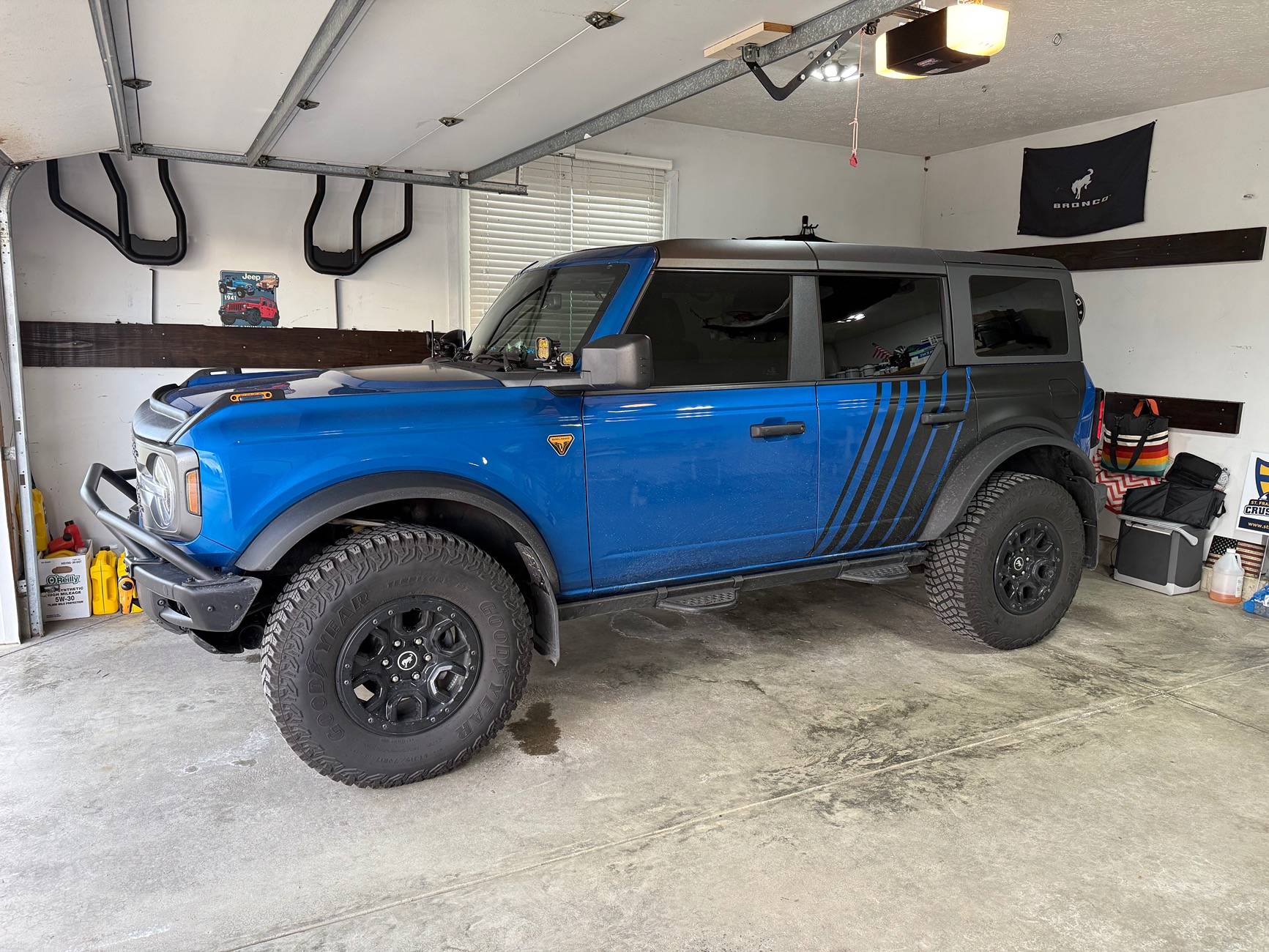

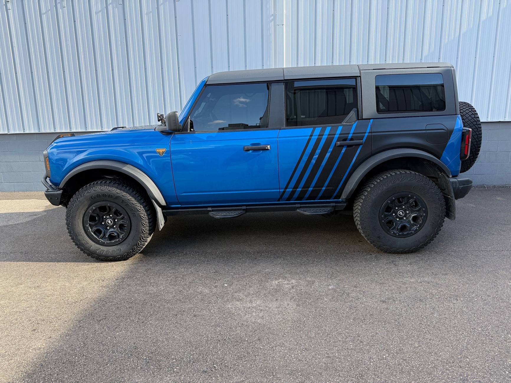

We had it put on Thursday and I’m happy with them. It netted about 1“ taller in the front and 1.5” in the rear. Yes it was expensive but to me it was worth what i was going for. We were .43” lower than a factory sas with wildtrack wheels, we are now .5” taller than a factory sas. The ride is much better with the 2.5” shock body on the 6100’s. It actually feels less harsh and little bumps feel more subtle and it eats up bigger bumps much better! No more nose dive on braking and cornering is much improved. Now i don’t have to worry about the factory shocks going out and I’m within spec on CV angle but got enough lift to do anything I’ll be doing with ours. If the Eibach pro truck setup was any softer than this i don’t think I’d be happy with it. The 6100’s with factory SAS coils might have been slightly better for the adjustability to go a little higher but then you risk CV angle issues and for me that just wasn’t worth it. Overall the improvements in ride and height were exactly what i was going for and I’m glad I had it done.
Glad to hear this worked out well for you, and the results were exactly what you wanted. Hard to put a price on satisfaction.
Good luck on the trails. Look forward to seeing photos and videos of your future adventures.

@Trilifter7 It's always good when you are satisfied with the outcome (y) .
Keep in mind, the lift will settle in a few weeks of driving. Remeasure thereafter & report back your findings if you would to help others 🤠
