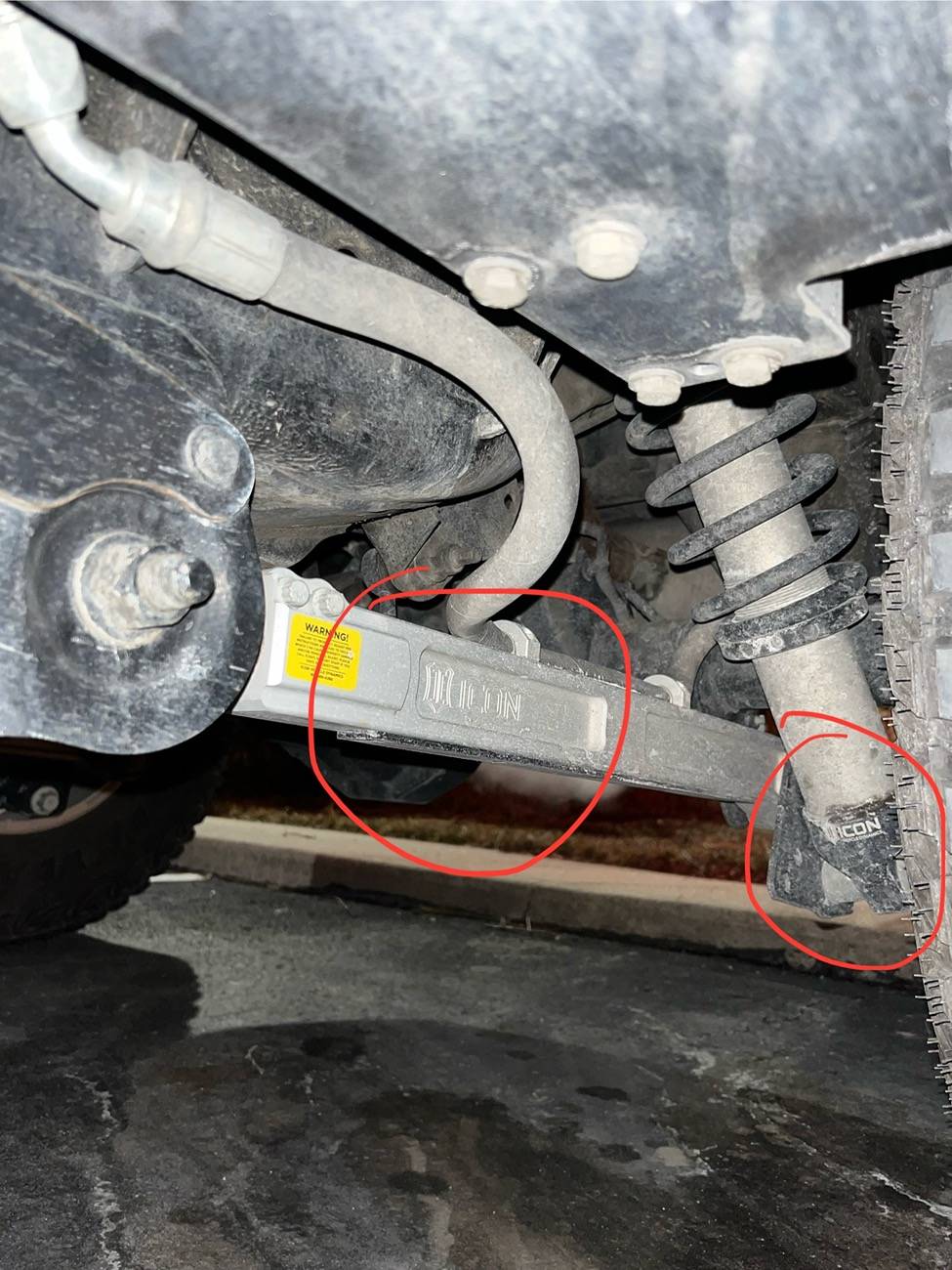

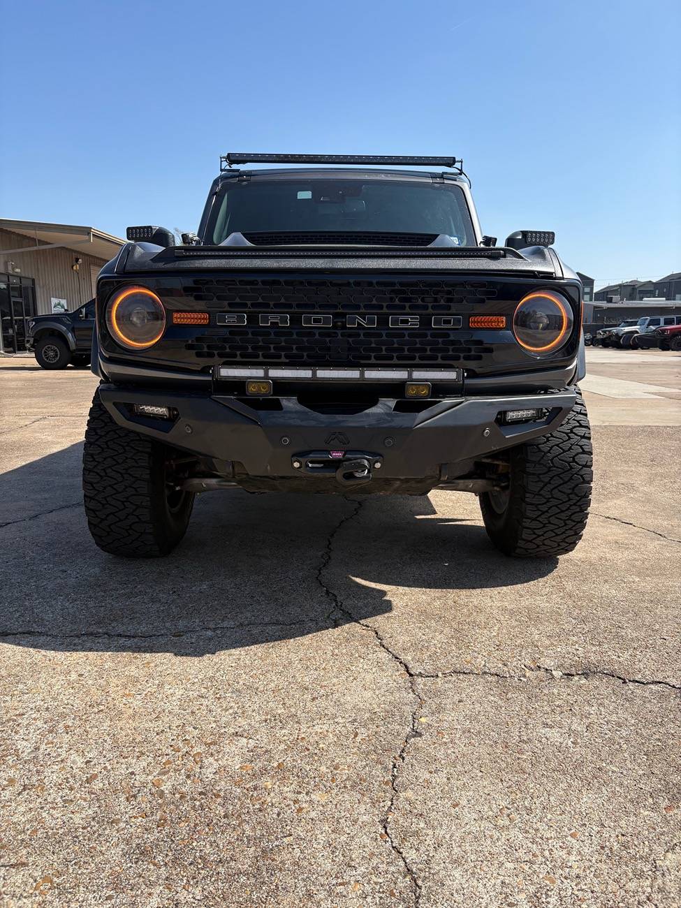

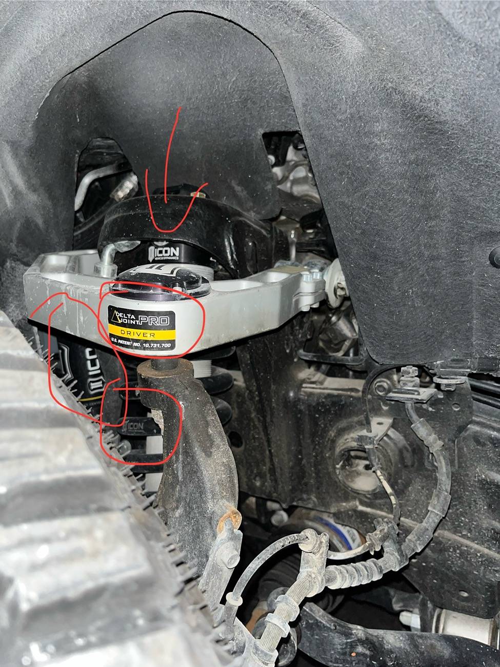

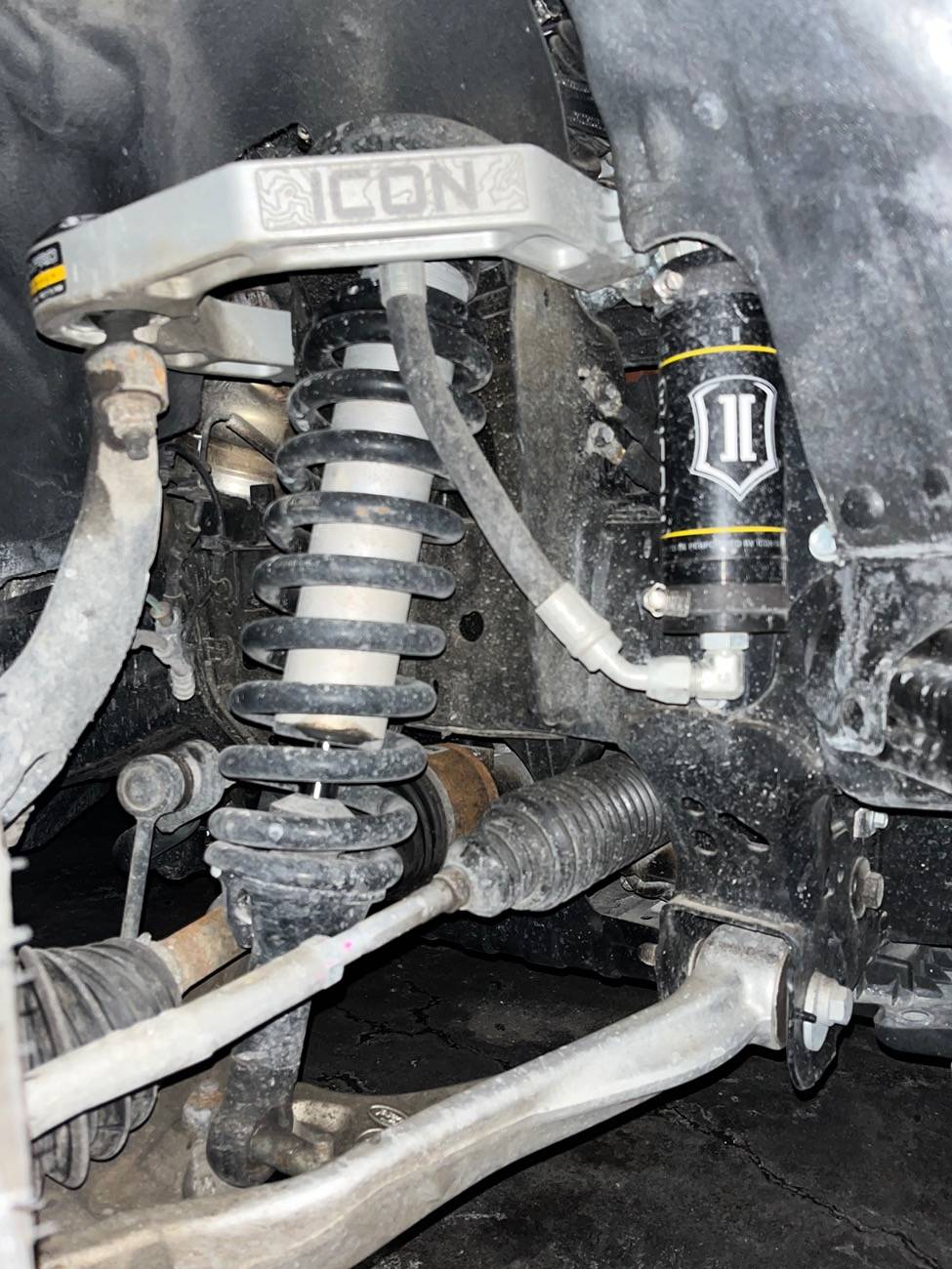

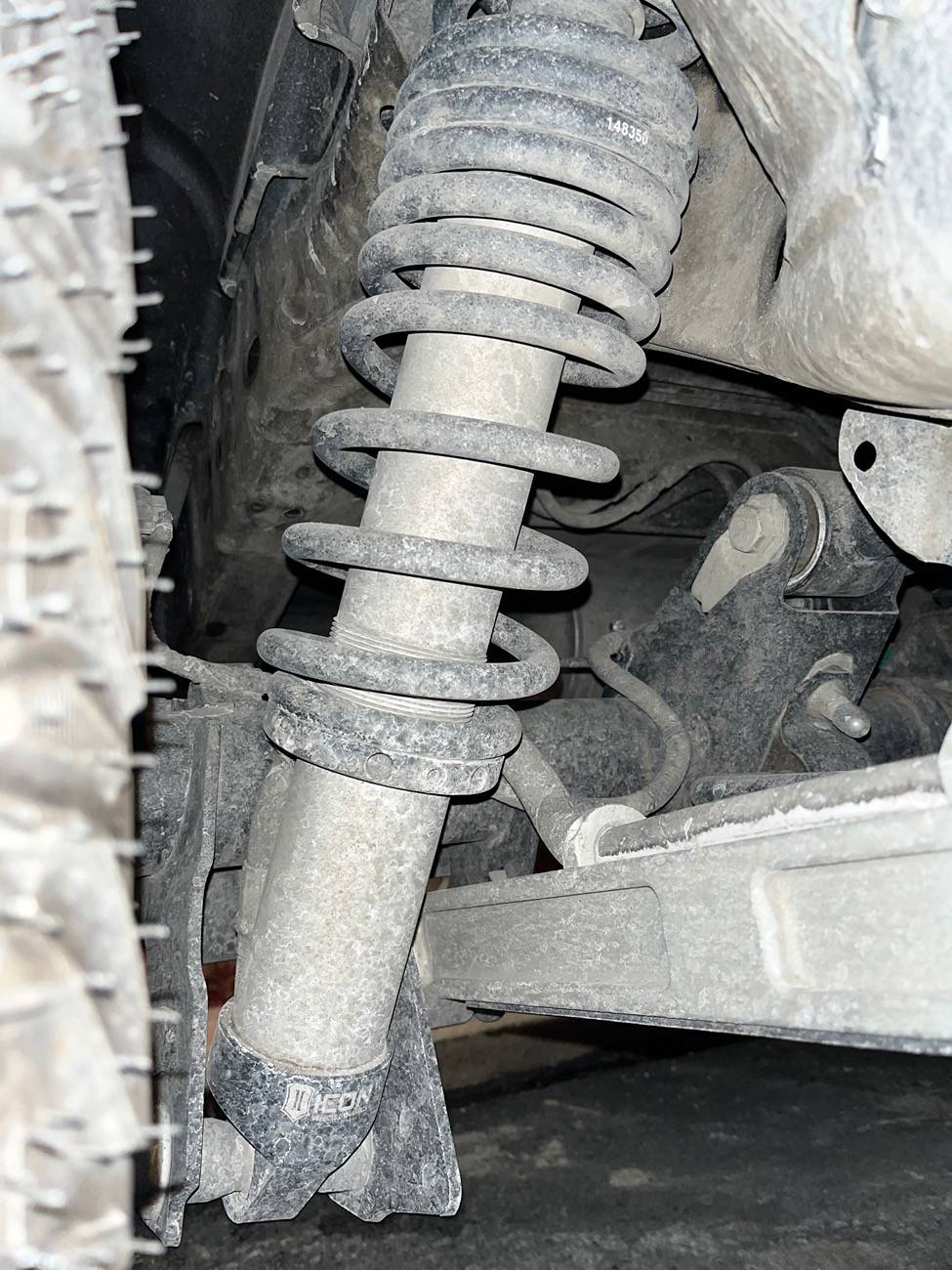

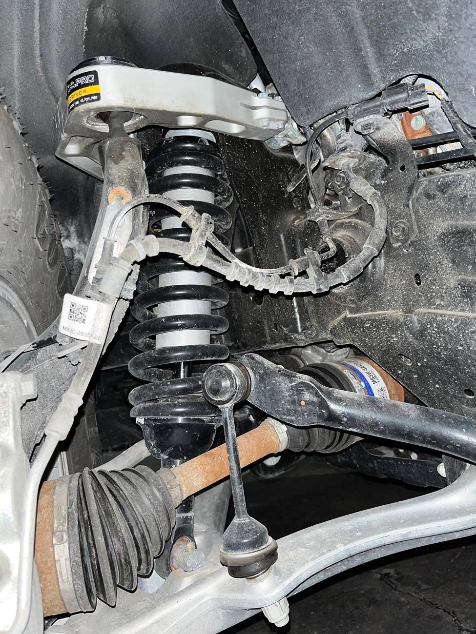

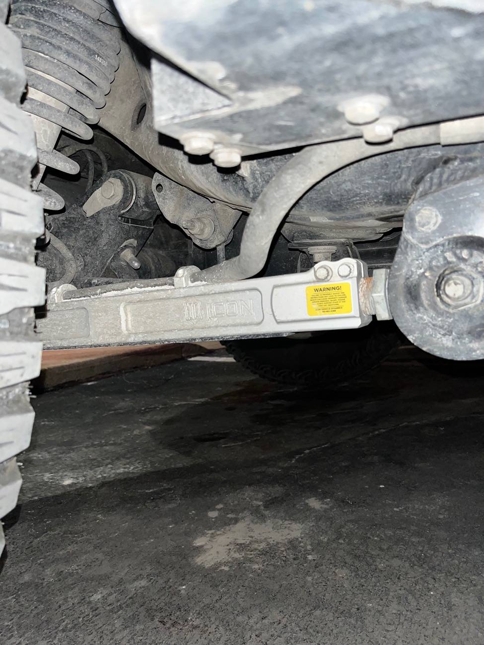

Cut me some slack here as I am new to the forum and Bronco community in general…
So I recently purchased a ‘22 Wildtrak w/ Sasquatch pkg., and noticed some Icon suspension hardware, I suspect it to just be a lift but;
1. I am new to the bronco community so I am not entirely sure what I am looking at.
& 2. The more I look at it the more Icon logos I see under there…
Curious if someone would be able to help identify what I am working with as the dealer is unsure what the previous owner had installed too.
mpeugeot
May 14, 2021
9,147
18,929
post some pictures
