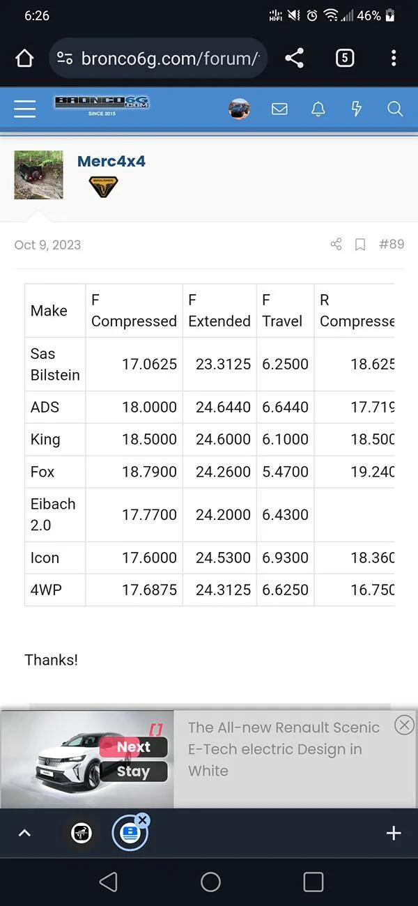

0.3” is probably negligible and it greatly depends on your use case. If you never cycle the front suspension much then not a concern really. If you do aggressively cycle the front I would imagine that there would be more severe wear on the CV internals.
AccuTune sells the king shocks with an internal limiter that reduces the extended length to 24.3” just to be safe. It is described in detail on their website if you are interested. Easy to find if you hunt around.
Makes sense. Thanks for the input. I read somewhere that 24.6" was the limit.
I'm interested in the RK shocks myself, but I'll worry about that in the future. In the meantime, I'll keep long term testing my spacers, lol.

The Kings exceed the factory limits. Are owners with King shocks stressing the cv's? Or is 0.3" negligible?
Maybe I,m reading it wrong, but @87-Z28 chart has the King’s extending almost a full inch over OEM…not sure how significant that is to CV wear compared to .3”

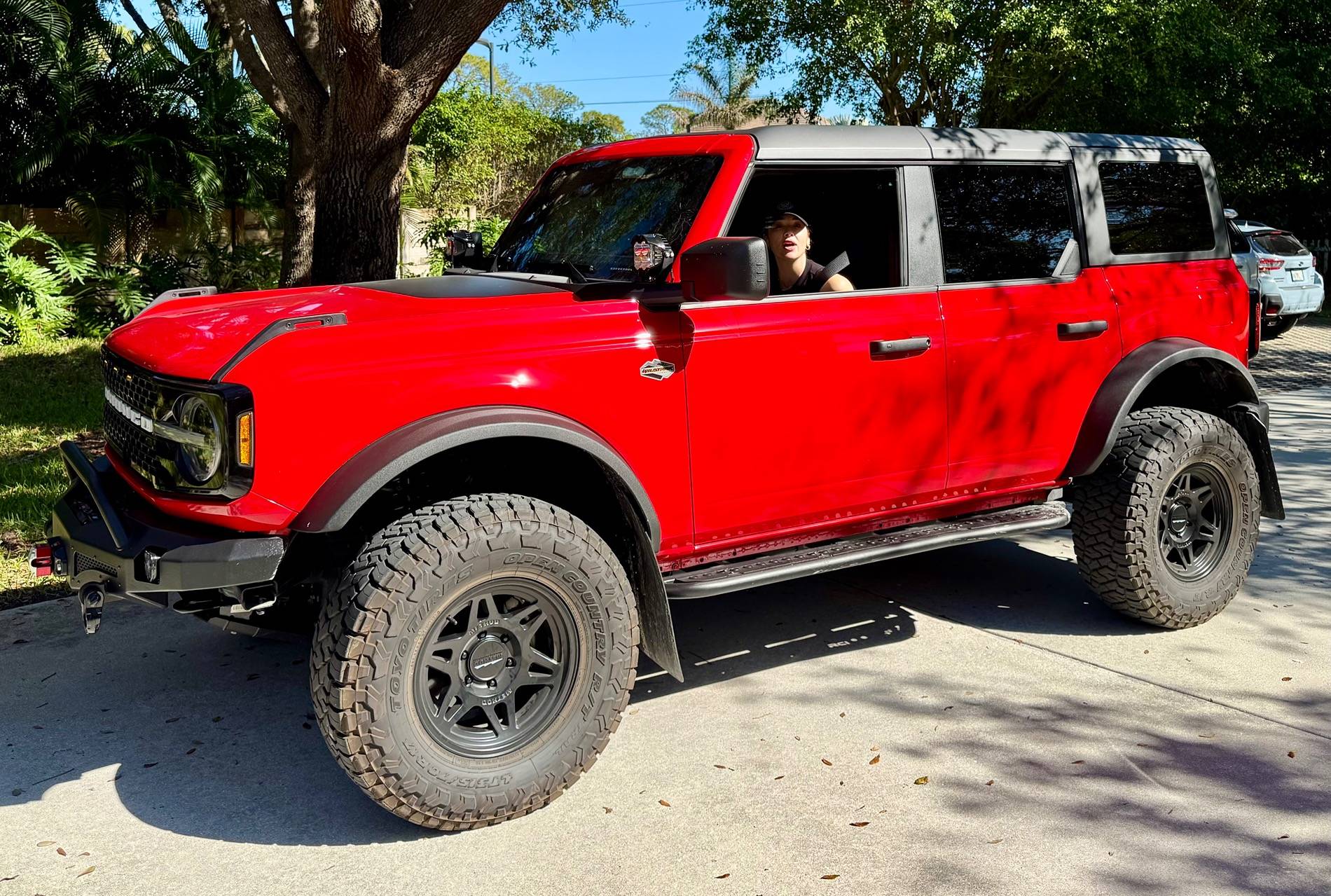

I’m running the Dobinsons IMS coil overs on my 22 Wildtrack 4 door. They have multiple springs available depending on what weight you have added. I selected the heaviest springs front and rear to better support the metal bumper with winch, full steel skids, frame mounted rock sliders, plus whatever other crap I’ve thrown in the back. Not much basis for comparison with other mfgs, but I’m happy with the ride and quality of the Dobinsons kit.
Dobinsons USA IMS kit…
https://dobinsonusa.com/products/do...ft-kit-ford-bronco-4-door-2021-on-dsskit22fb/
Dobinsons USA MMR kit…
Off The Grind has YouTube videos on the Dobinsons IMS and MMR.
My 22 Wildtrack running stock size 35” tires on Method zero offset wheels.

Here's a other chart showing some other shock lengths compared to factory.
Some of the shocks are pushing 24.6". Rock Krawler's front shocks are at 25.2". They say that's when they noticed the cv's got tight on rotation.
I have 1.5" spacers on top of Badlands non squatch shocks, so that makes them 24.5" total length. Around the aftermarket shock lengths.
Correct. The post said the limit was 24.3", and king maxes out at 24.6. 1.3" over factory length, and 0.3" over the limit.
I know vendors have noted the issue with King front shocks, and some supply spacers for Kings to avoid the CV bind that can happen with them.
