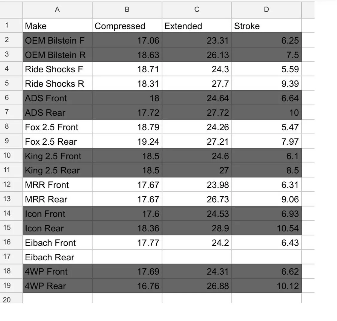

here is some data on shock lengths. Shown are fully extended and fully compressed. The difference is the shock travel. Notice that most of the shock manufacturers limit extended length to around 24.3”. This is directly a result of CV binding that occurs for lengths greater than 24.3”.
Then the aftermarket game becomes increasing shock travel by decreasing shock compressed length without causing tire/fender interference at full compression for the 37s everyone wants to run.
Edit. also notice that stock length is 23.3”. That is why snacktime says adding a 1” spacer on top of stock is fine. You will still be under the accepted aftermarket shock length limit of 24.3”.
I don’t have numbers for the 8122s.

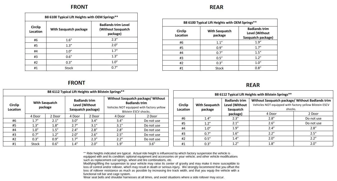

Shown below is some info on the circlip adjustments and related ride heights for the 6100 (uses the stock SAS springs), and the 6112 (comes with a new spring). This came from Bilstein's installation guides for the 6100s. As mentioned in a previous post, changing the circlip changes the spring pre-load. Increasing spring pre-load makes you ride higher but also changes ride quality - not necessarily better or worse ride quality, just different depending on your overall weight, tires, etc.
Ford Bronco 2025 Suspension Recommendations (by Snacktime) Bilstein 6100 vs 6112
The Kings exceed the factory limits. Are owners with King shocks stressing the cv's? Or is 0.3" negligible?
0.3” is probably negligible and it greatly depends on your use case. If you never cycle the front suspension much then not a concern really. If you do aggressively cycle the front I would imagine that there would be more severe wear on the CV internals.
AccuTune sells the king shocks with an internal limiter that reduces the extended length to 24.3” just to be safe. It is described in detail on their website if you are interested. Easy to find if you hunt around.
