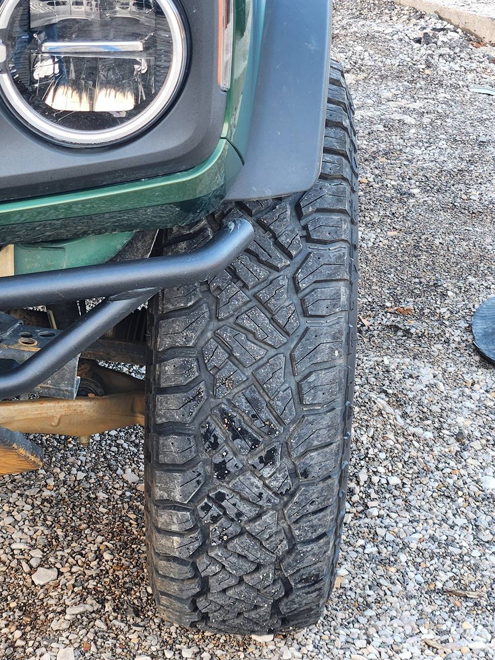

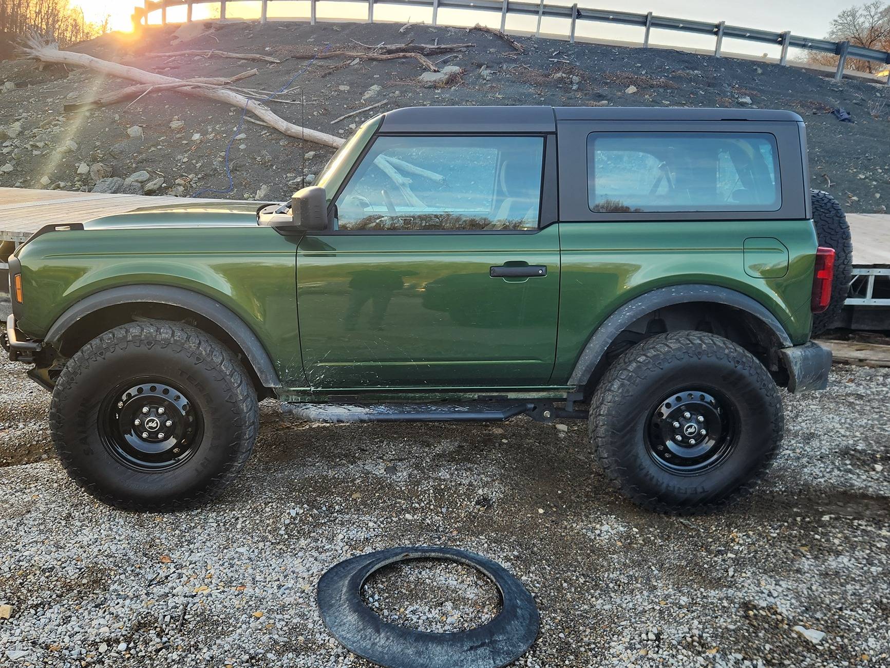

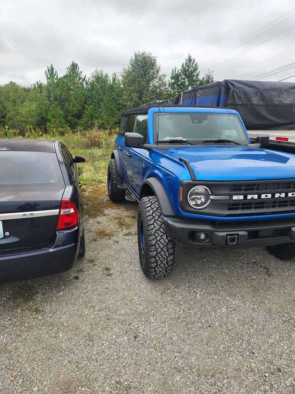

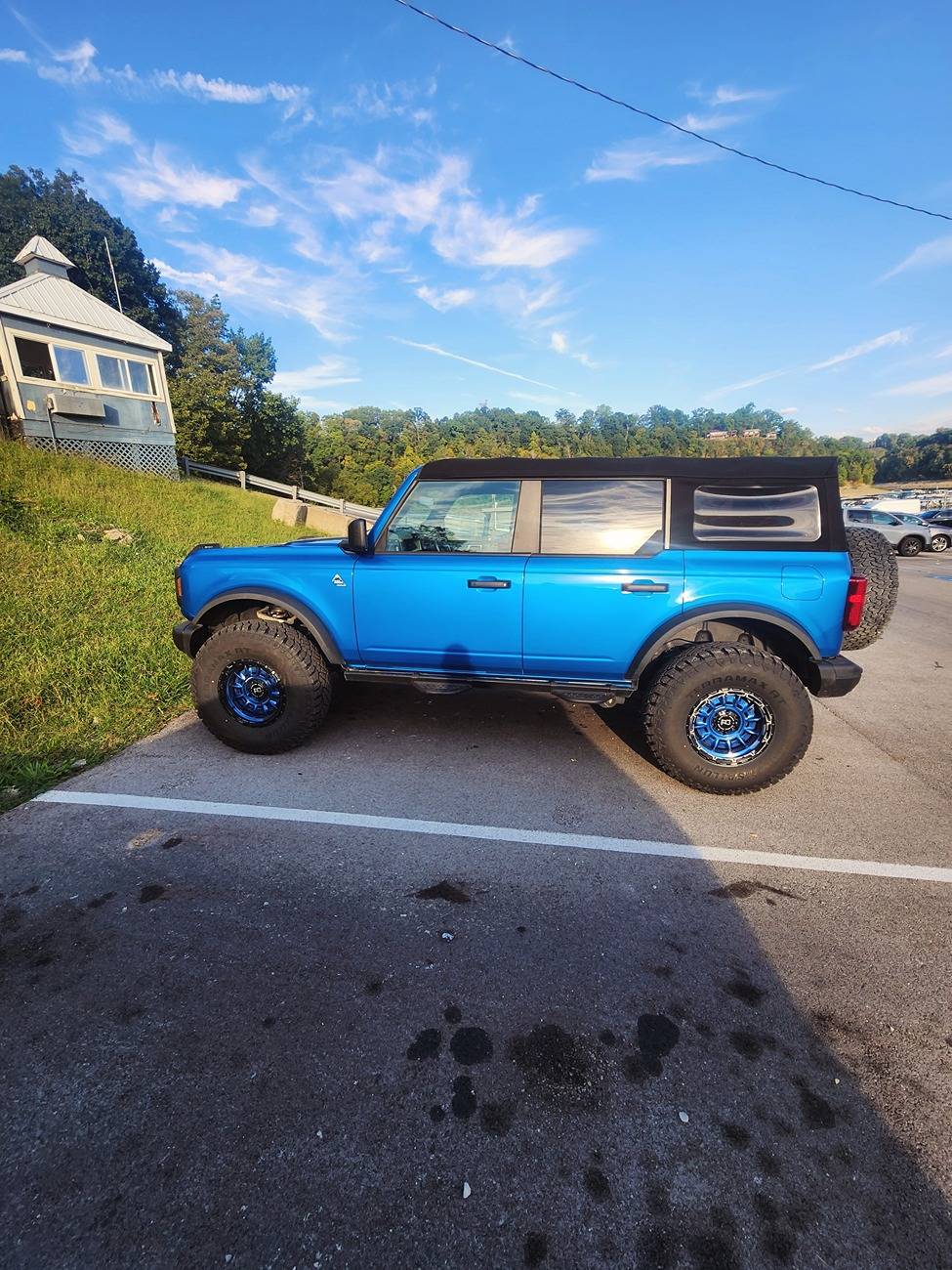

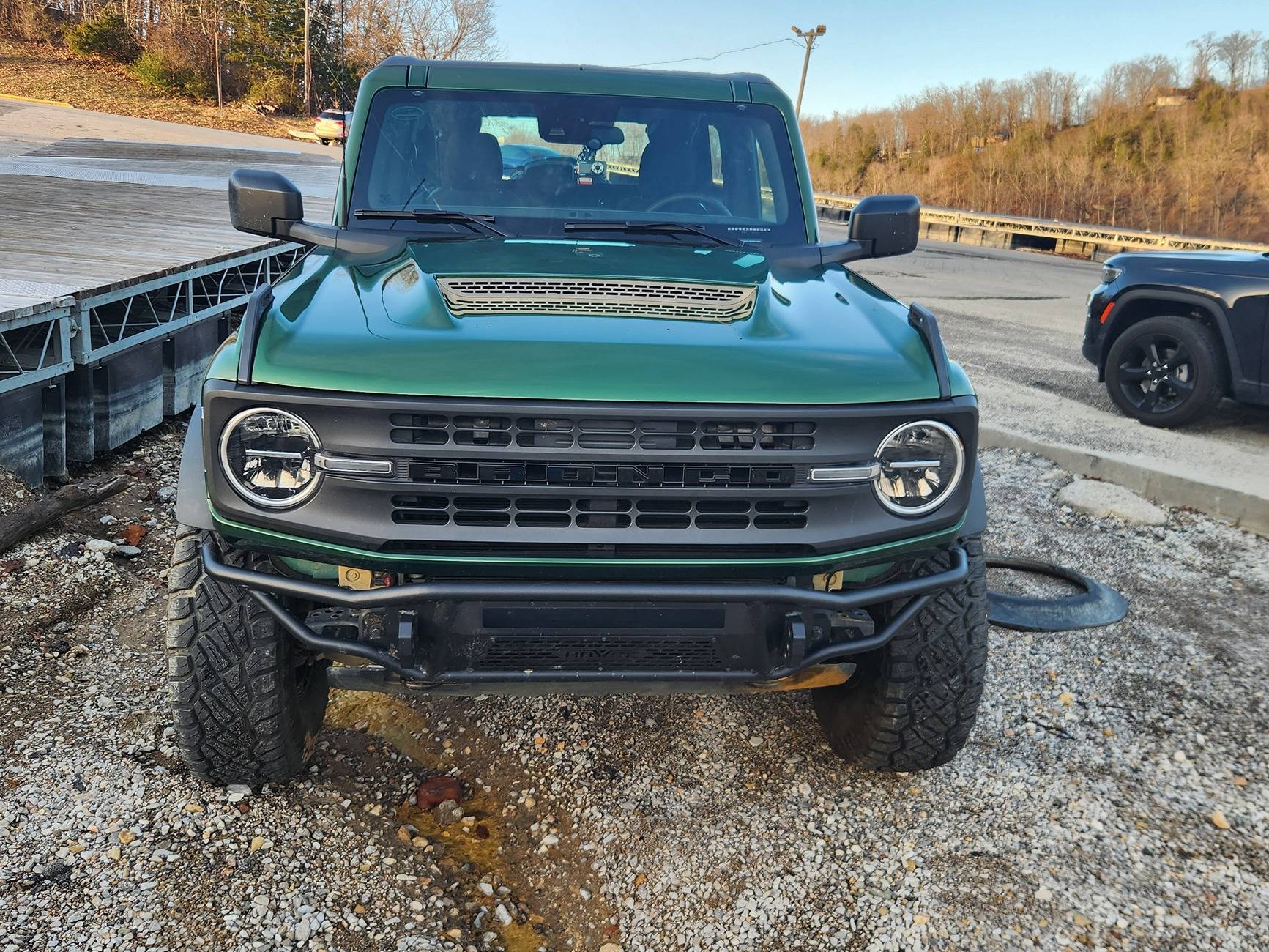

37s 2 in spacer lift 1 in over sas no rub tire ar terramax rt the run skinny tread is 9 wide weight 60 pounds d rate . lcg build . this is a base 7 speed no boxes marked. the blue one 2.5 lift withdiff drop same tires rims black rino 8.5 wide -12. . the green one is.in the water crossing video
