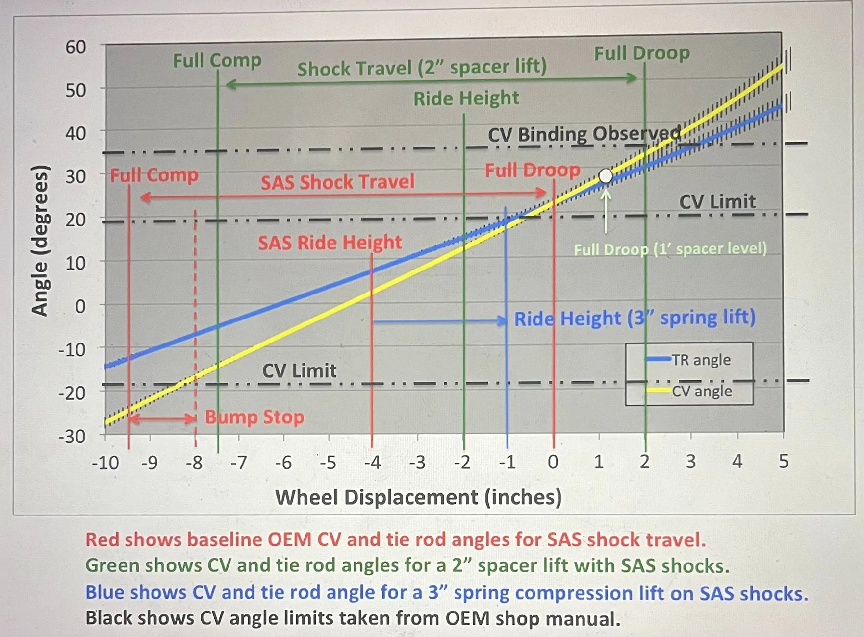

My understanding of a diff drop is that it corrects severe angles in your CVs and axle. Drop the diff with a lot of lift (3-4" according to this) to recover some of that angle, basically so your CVs aren't at their max angle with the diff.
I can't seem to find the graph right now (was sure I'd saved it!), though it's been posted here various times. IIRC, with the Badlands the CV joints have little room to safely handle more droop than under stock conditions. It seems to me, looking at that graph in the past, that adding 2" of lift would push the CV joints entirely out of the safe zone, at least if you're going to full droop. I'd be happy to be wrong about this.

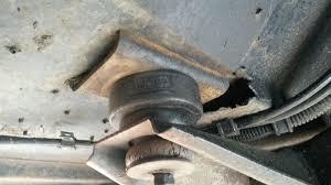

What body lift options are out there besides BroncBuster? I've only really come across that option, and they start at like 1"
Or is it just get in there and stack fender washers under the rubber bumpers?
Well, there is always this old school option........
Ford Bronco 2025 Suspension Recommendations (by Snacktime) 1738900549540-of
.........the good old fashion hockey puck. Gives you about 3/4 of an inch per puck. :wink:
This one?
Yeah, I don't know. I've heard 2" (or more specific 2.2") is safe for a couple years now. Snacktime's guidance is 3" or more. So I don't know.
