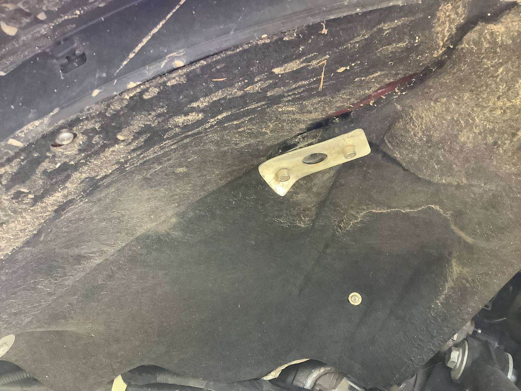

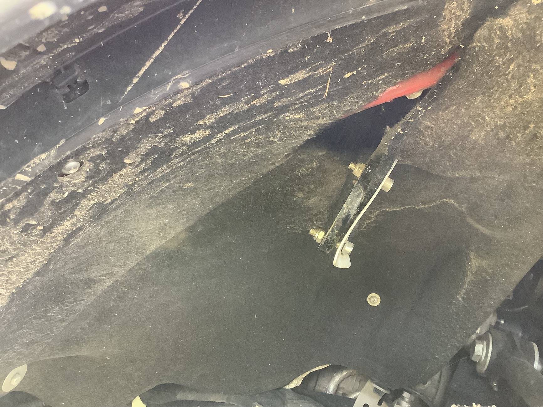

looking at the compressed length on my procomp front coilovers and hearing/feeling a rub at speed over some bumps with 37s I ordered a 3/4” body lift but did not get it installed before snow run last weekend…hit a good hole and seriously bottomed out..tire hit rock light mount and tore inner liner up…haven’t actually heard of bottoming problems with procomp and 37 but here is mine…anyone have opinions on dv8/hook/stock liners…
