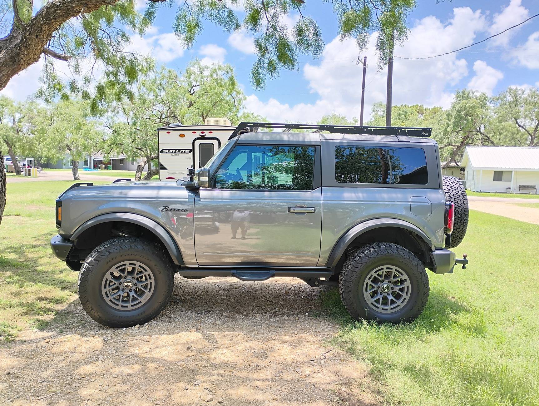

I owed you picture.
The center lower lip of the fender is apx 40.75" both front and rear.
Ford Bronco 2025 Suspension Recommendations (by Snacktime) IMG_20250708_133238565_HDR
That's how they look out of the box with the standard springs in the Eibach Pro-Truck 2.0 kit.
