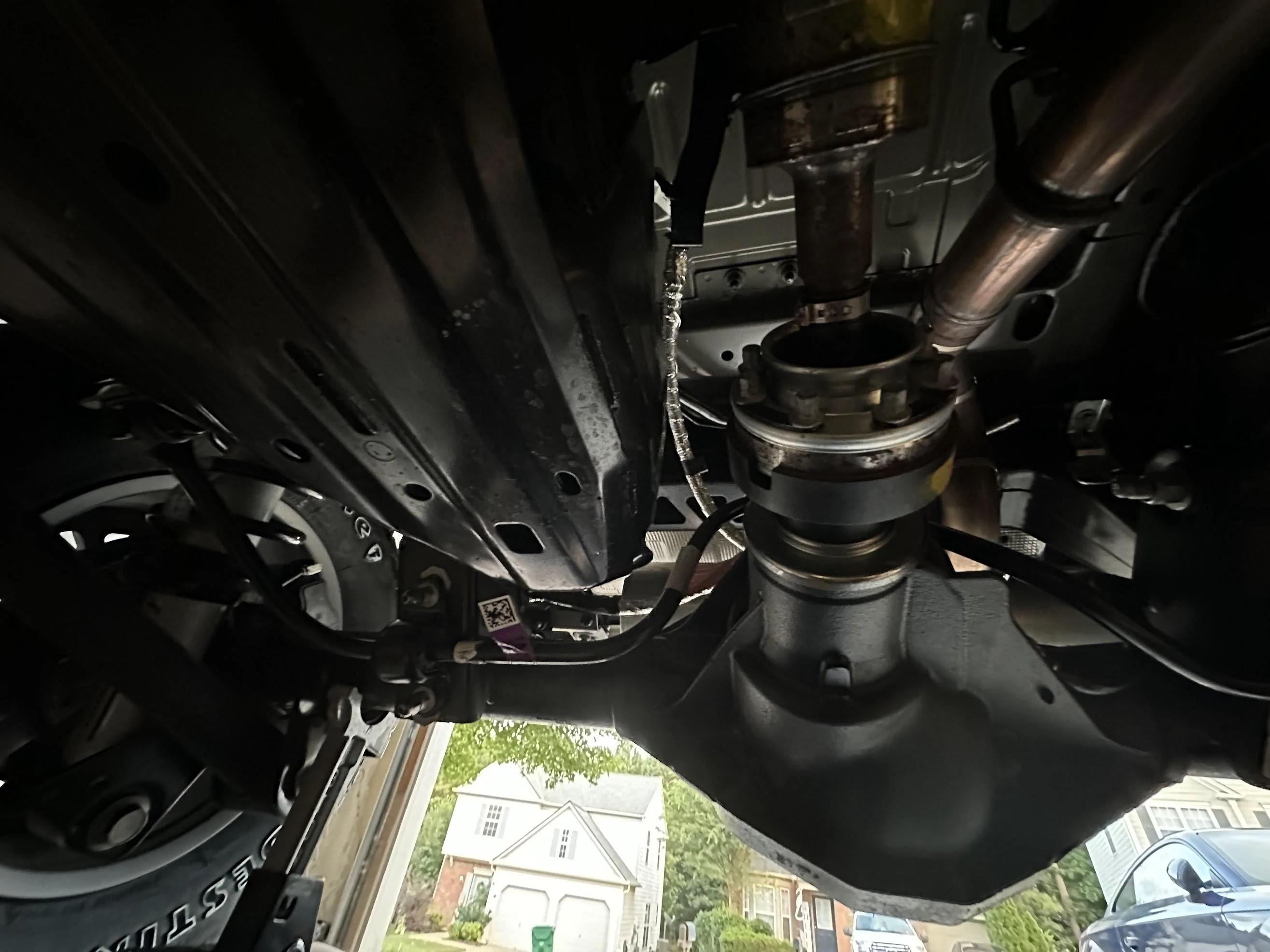

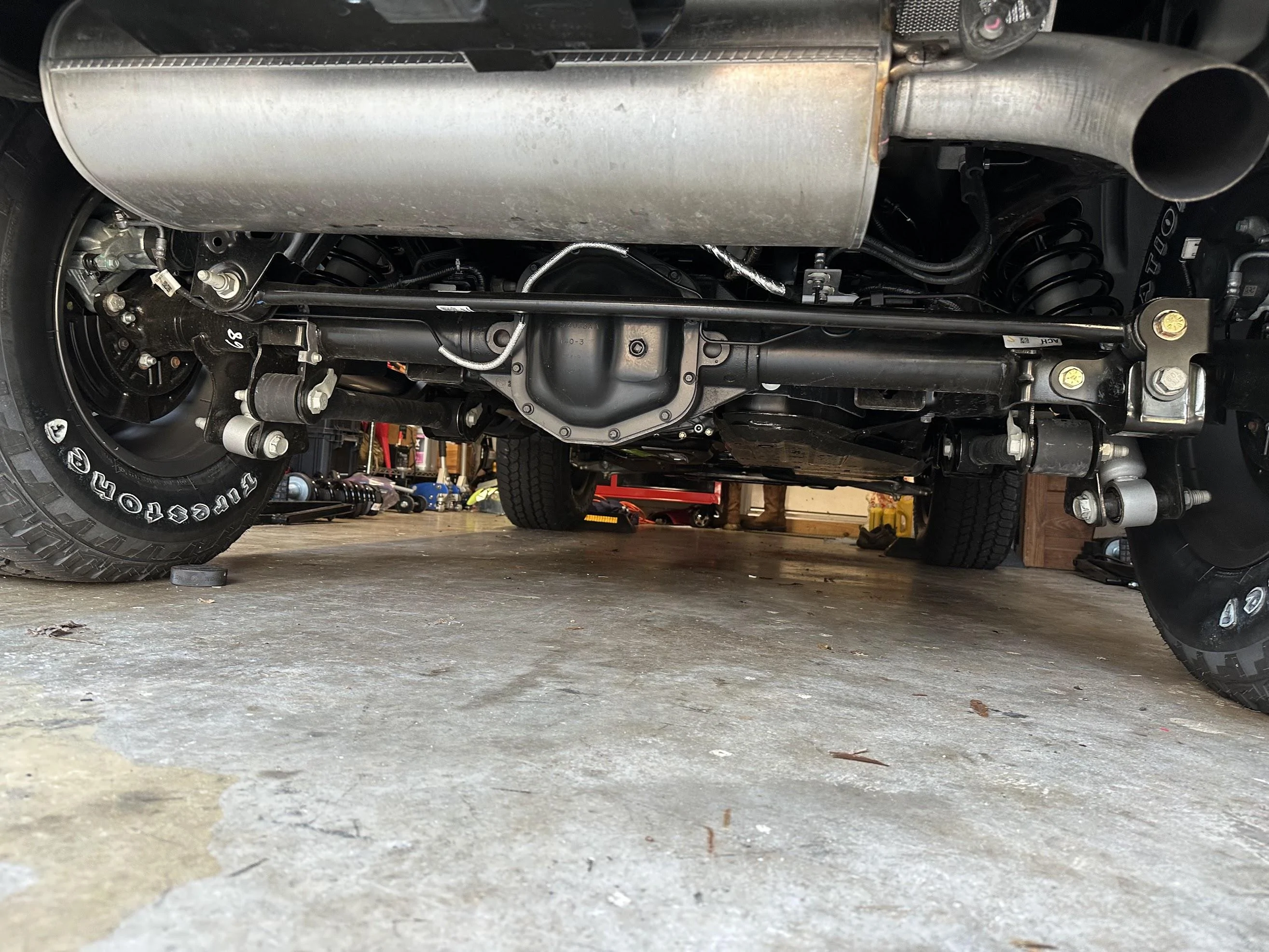

I have the Ford Performance 2" Lift aka Bilstein 6100s.
Without the trac bar relocation bracket I was getting rear bump steer.
After the bracket, it drove much better.
Then two days later, aka TODAY, I installed the rear sway bar and with both of those, the driving dynamics are night and day different. No more rear bump steer, no more pogo stick, no more uneasy rear end feeling, way less body roll, less nose dive under braking.
I highly recommend doing both. A rear sway bar is still good for offroad in case you are worried. It can actually help the front end flex out more (Front sway bar disconnected).
Which rear track bar bracket is this?

I ended up with a Boss4x4 bracket. Putting it on next month.
Curious why you opted for the Boss4x4 one over the RockJock? They are near identical but the RJ includes a brake line bracket whereas the Boss4x4 does not.

I went with the Fabetch bracket and I am generally happy with it. It's super heavy duty and the rear end feels very planted and minimal body roll in the turns. Only thing to note is that the welds on mine were pretty sloppy and uneven. Aside from having weld spatter everywhere, the welds actually prevented the bracket from fitting/seating in the stock trackbar mounting location. Decided it wasn't worth the trouble to return and I just ground it down and sprayed it with some black paint.
