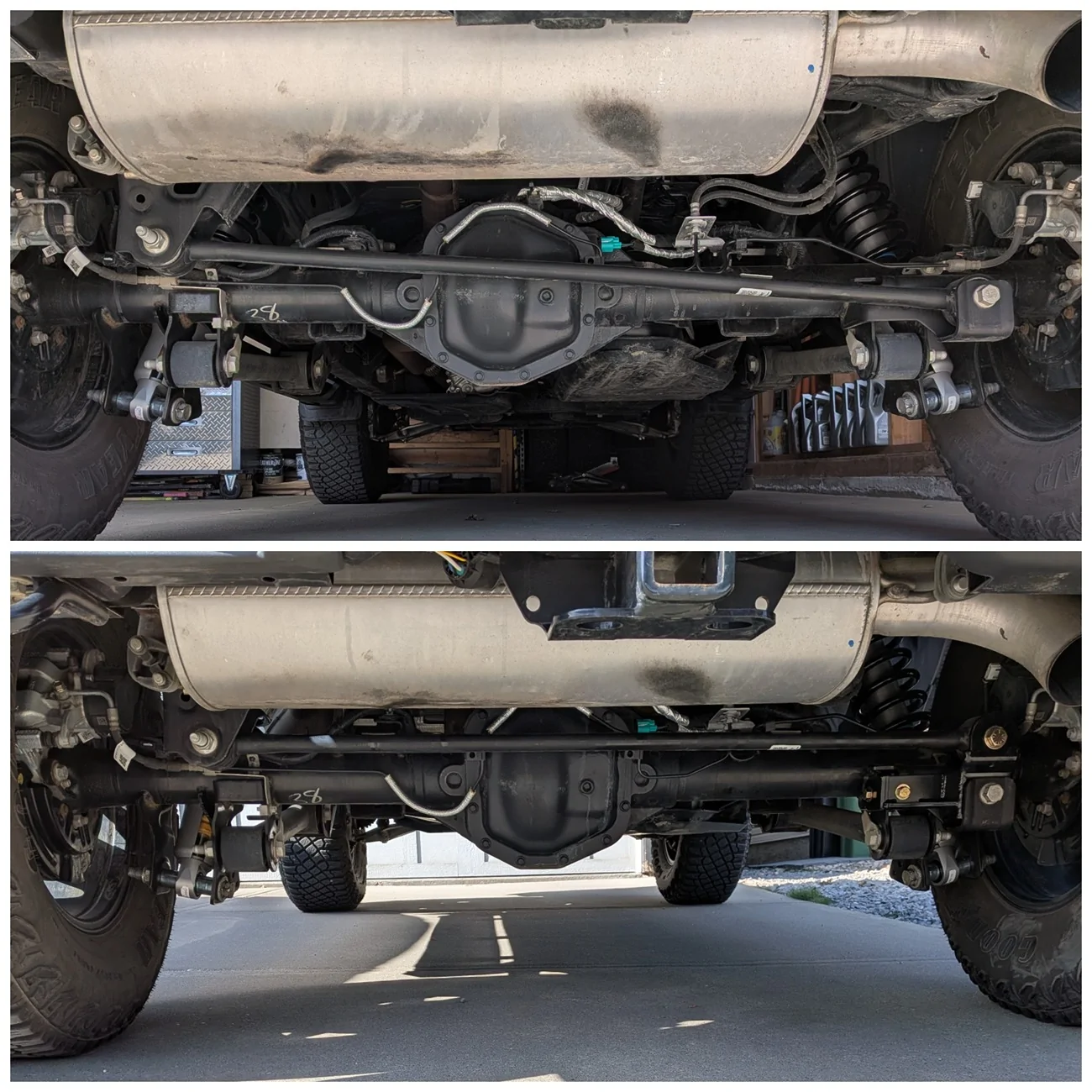

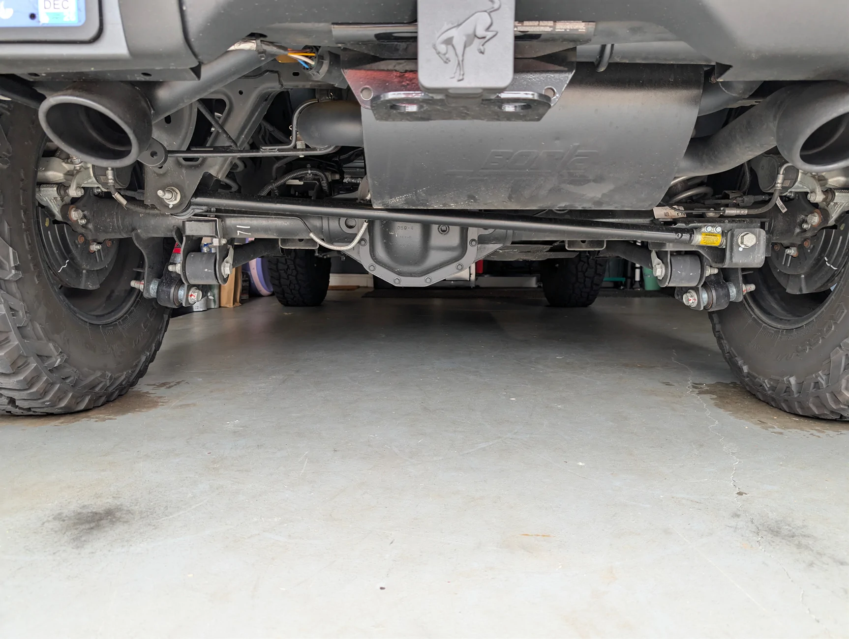

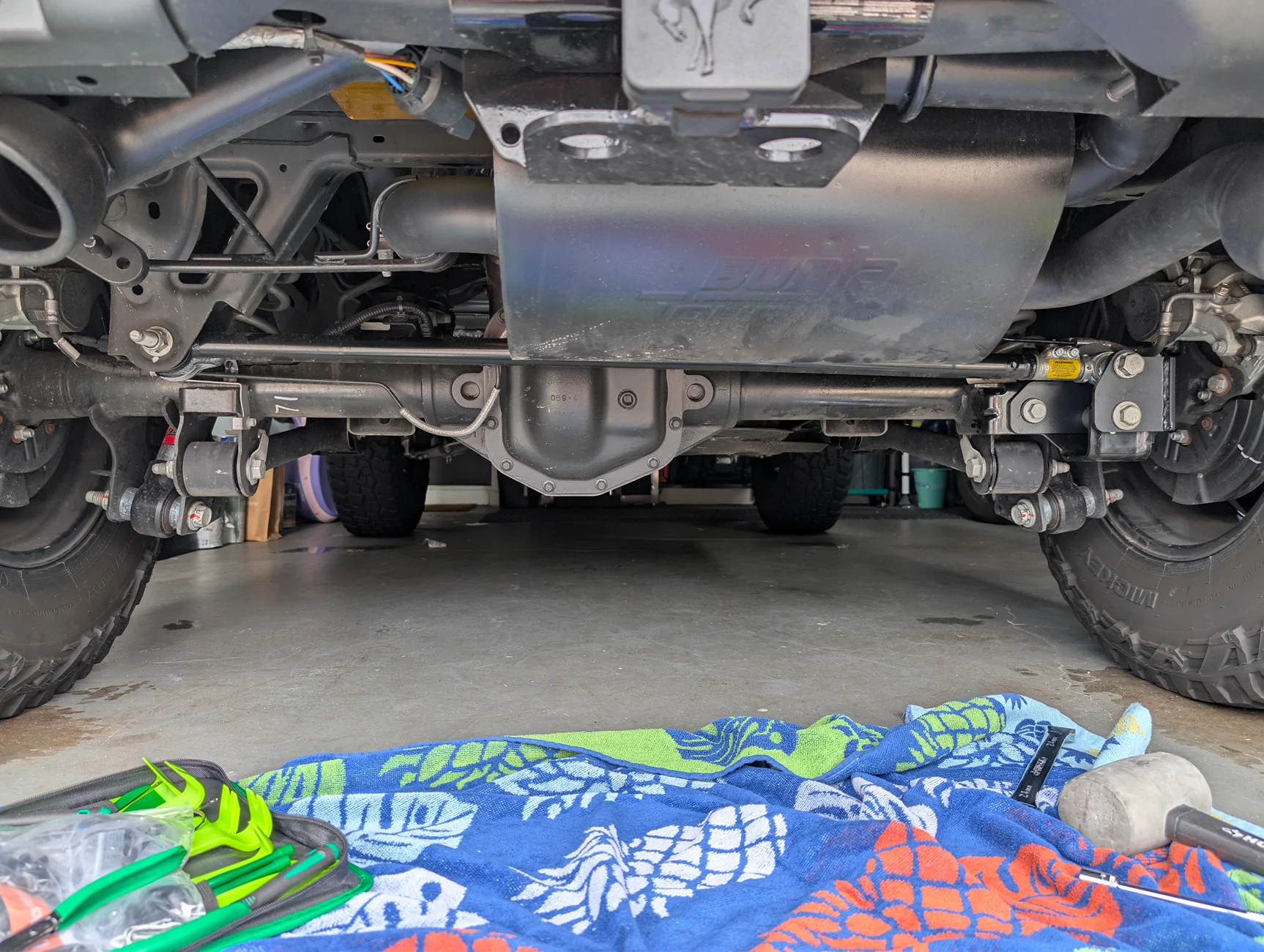

Just put on my Terraflex relocation bracket today - as the others have said I am surprised at the difference it made - very noticable. Back end feels more "planted" and the little wiggle I had in the back over bumps is gone. Before and after pictures below.
I did it in my garage without lifting the truck and it worked out well, other than it's a bit hard to get good torque on the bolts laying on the ground (I just used the impact wrench). The Terraflex kit comes with a brake line relocation kit as well that is needed and the whole setup is real nice. Tracbar is Icon adjustable.
Thanks to the others here who posted about install and gave me the confidence to do it myself. Not a challenging install at all, even with the brake line relocation.

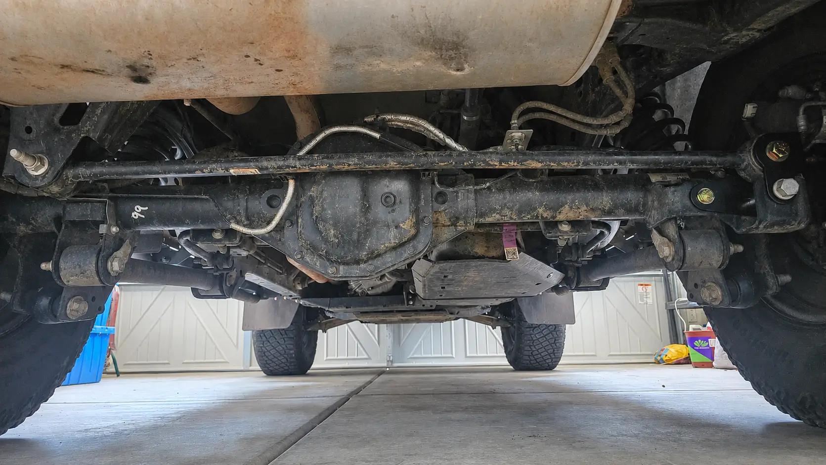

Installed today. Overall easy install, did have to use ratchet straps to align holes once.
Overall I'm not sure I'd say it makes a night & day difference, cruising down the road and going over small bumps and grooves still feels the same, but I have one large bump near my house and some train tracks, the rear did feel more planted going over those. Maybe I'll notice more as the week goes on.
Update: Since I've put more miles I would say definite improvement with the big bumps and grooves that previously made my rear-end feel like it was wobbling. Small bumps, mostly the same; big bumps, much improved.
But overall not a bad addition for $100~

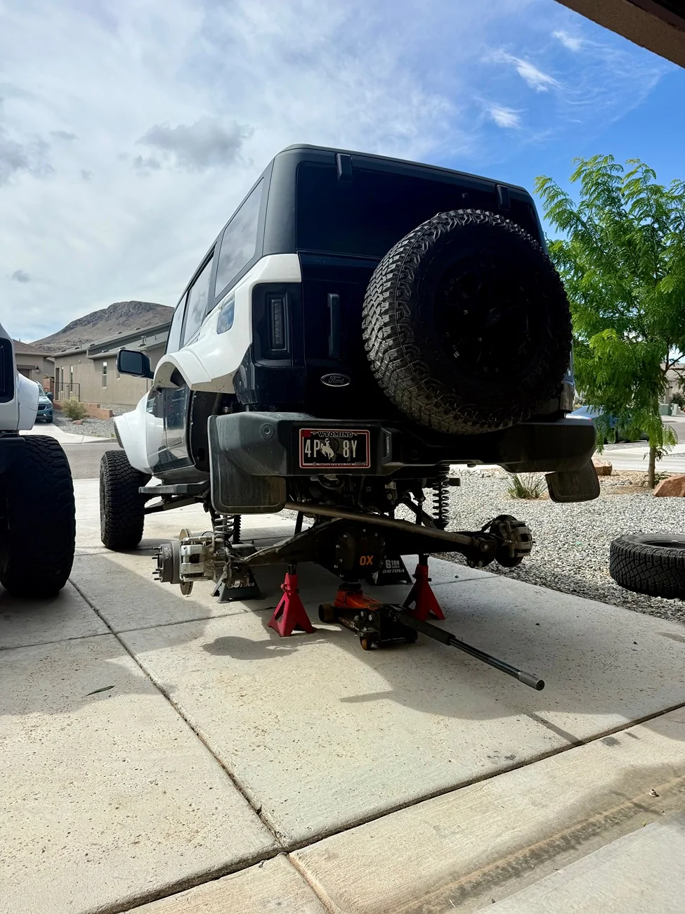

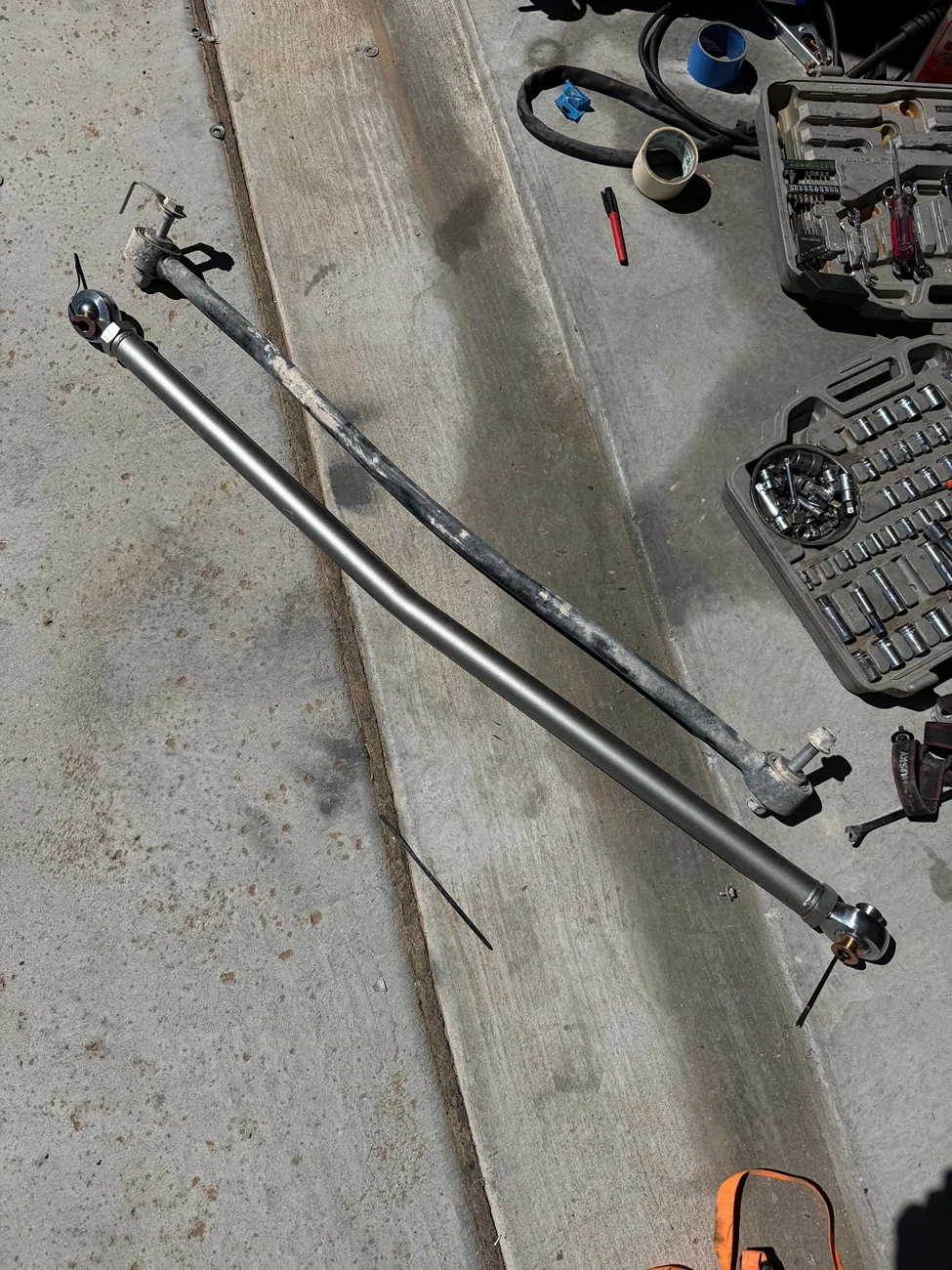

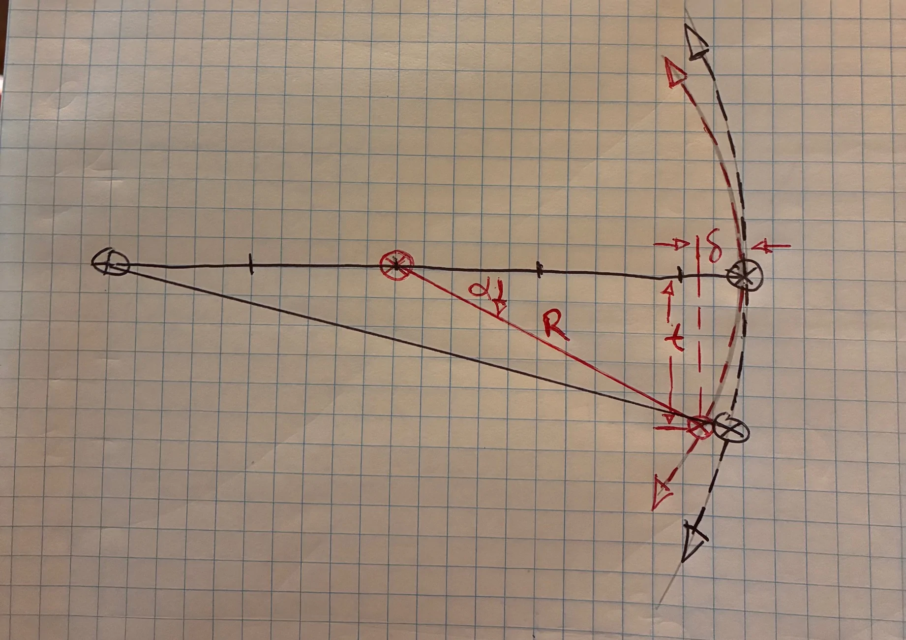

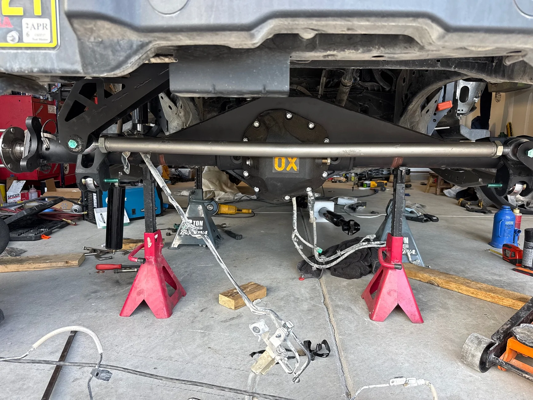

When doing my adult education on suspension, particularly track bars, I learned about Sagitta. When Vasher and I were going over options to keep the OEM fuel tank while trying to extend the trailing arms but not wreck the pinion angle throughout 20” of travel, we decided on a conventional three link. To reduce sagitta, we took advantage of the axle being +9” wider than stock and stretched the panhard out an additional 9” over stock. Vasher designed a new panhard mount for the frame as well as a mounting setup for the axle. He did a damn good job, resulting in only 1” of lateral axle movement throughout the entire range of travel. Panhard bar flat as can be at ride height.

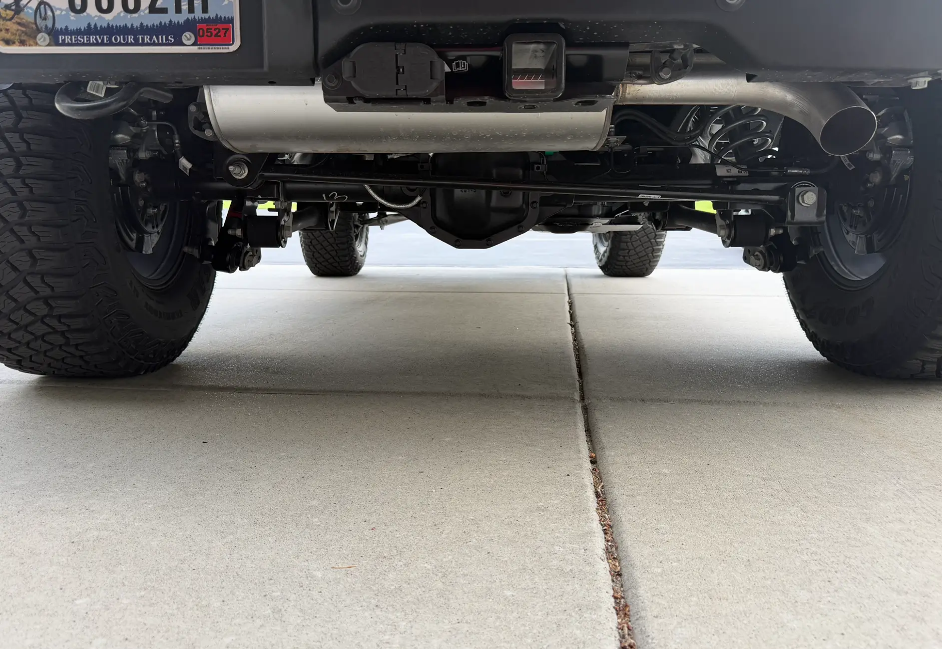

I’ve got the standard springs on Eibach 2.0 coilovers set at the lowest setting, do you think I would benefit from adding the Rock Jock bracket? Didn’t measure but pretty sure it was just over 2” of lift.

I’ve got the standard springs on Eibach 2.0 coilovers set at the lowest setting, do you think I would benefit from adding the Rock Jock bracket? Didn’t measure but pretty sure it was over 2” of lift.
I would measure each side/bolt from the ground. If there's a 2 inch difference, the Rock Jock would be the one for you. If it's 3 inches or more, I'd look into the Fabtech one. Mine was a 3 inch difference and the Fabtech bracket aligned it almost perfectly parallel to the ground.
Keep in mind the Fabtech requires you to drill 2 holes for additional bolts, but the kit is really solid. I'm really happy with it.

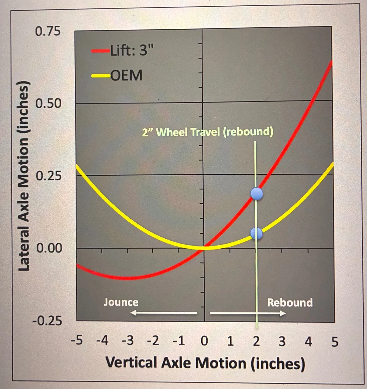

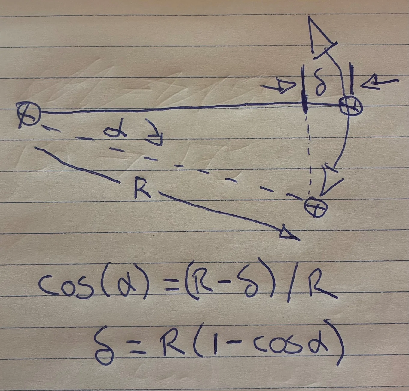

3” lift is gonna produce much greater lateral axle motion if Panhard is not leveled. See plot. Especially during rebound travel. Delta in equation is “Sagitta”, fancy word.
As wheel travel increases, lateral axle travel starts to become a bigger and bigger problem. Think 20ish inches of wheel travel in a long arm build. Only solution is to make Panhard bar longer. Like vasher rear long arm design @SierraBronco mentioned.
See plot of two different bar lengths, notice sagitta increases significantly as bar length decreases. Since arc motions become very different.

Yes. I have the same coilovers set at the lowest setting on the rear and I use the Rock Jock relocation bracket and it made my panhard bar perfectly level, which is what you’re after.
Thanks for the info, bracket ordered!
Yes you would. My lift is about 2.5" and bringing that bar closer to "level" does help.
