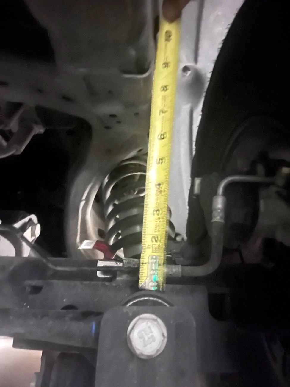

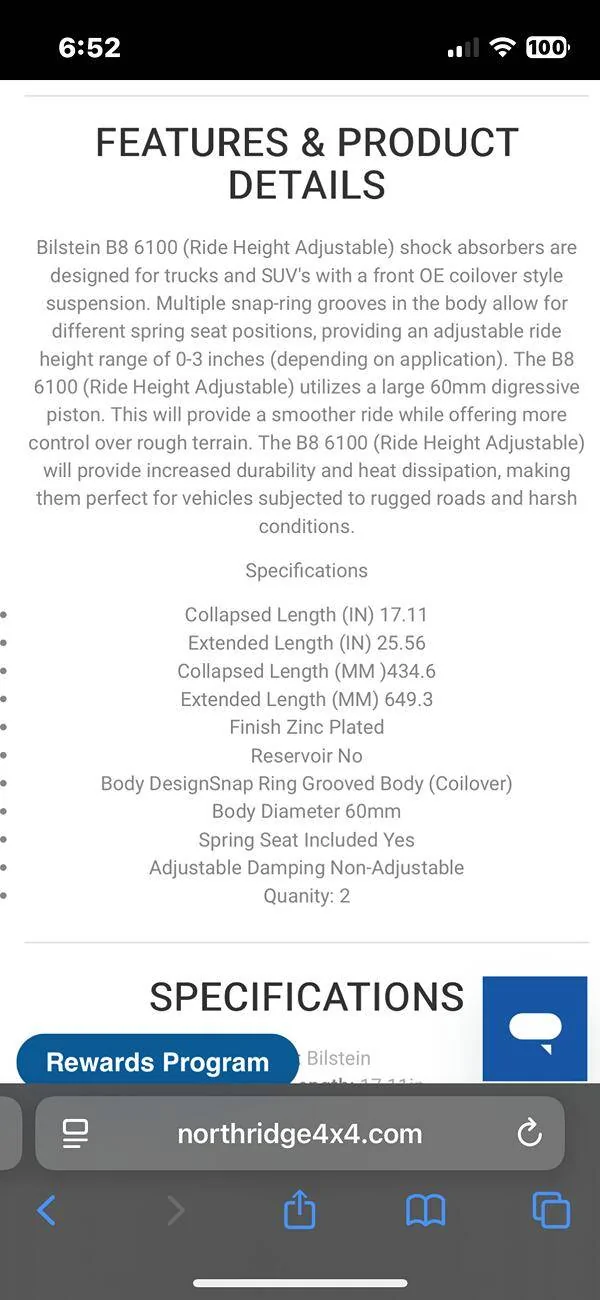

On my Bronco with the 6100 bills that have a compressed length of 17.11”, there is 7” of clearance between Panhard bar axle mount and frame at ride height. I have the oem bump stop and there is only 2.5” of jounce available before bump stop is engaged. So at most I can get 3” of full compression. Including a 1.1 motion ratio for oem rear control arms (3.3” of axle motion), that leaves a 3.7”clearance with frame. A 2.5” additional panhard bar mount leaves 1.2” of available clearance.
Easy to measure with a tape. I suggest you convince yourself all is good in the world. I think you will find that you have sufficient clearance, especially if you have an oem bump stop. Them suckers are big and inhibit the full compression from the manufactures specs.
