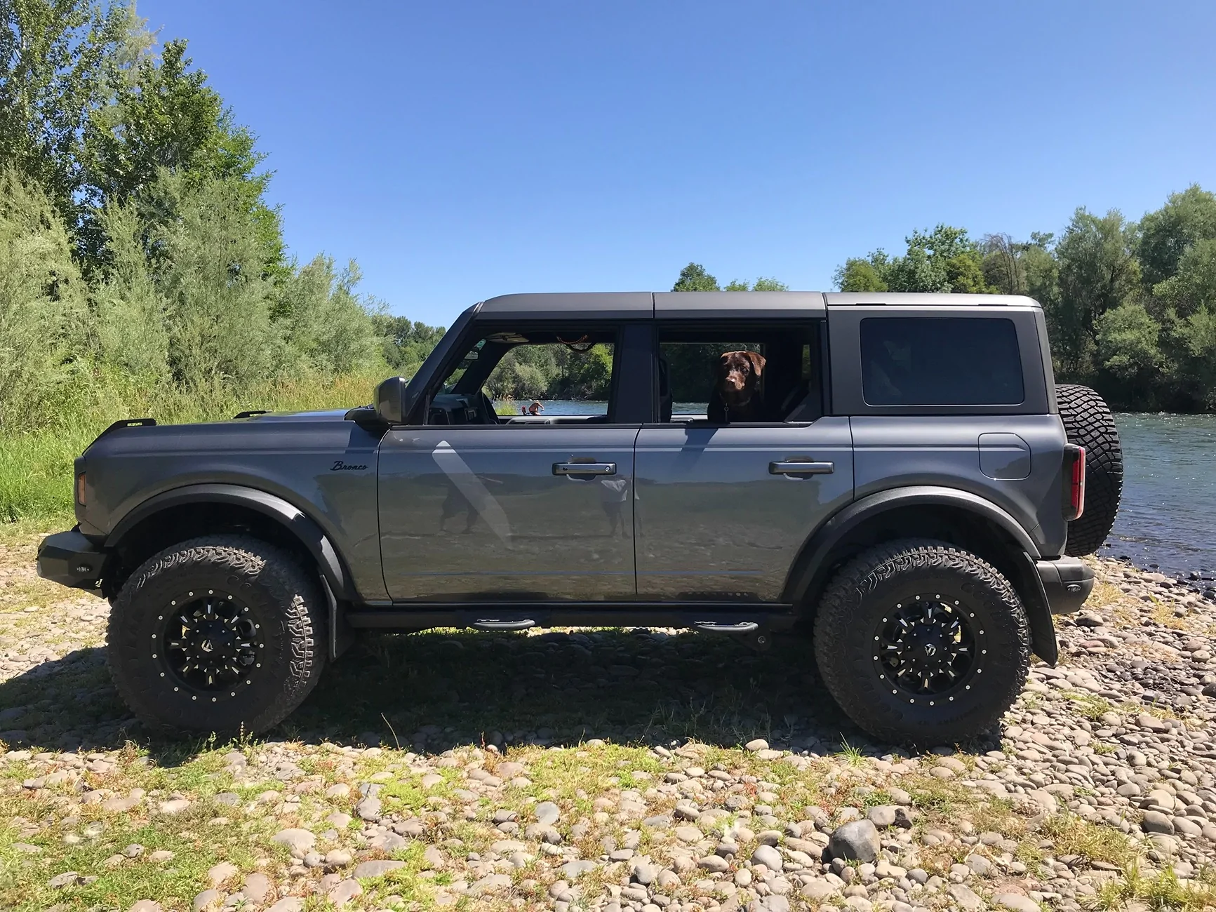

Sorry if this is a simple question, have not been on here in a few years. My 2022 Badlands has Bilstein 6100's with 34.0 tires, just a bit over stock height. I noticed that the rear axle is shifted to the passenger side about 3/4" on flat ground. How close to center should this be? Would it be beneficial to install an adjustable rear track bar and center it up? If so what brand would you recommend? I am not up to speed with recent Bronco parts, some seem very cheap and poor quality. Thank you for any expertise.

It should be centered…3/4” is a lot…a relocation bracket may work and a good addition after a lift…but why is it off center?…I just got a Core track bar (along with control arms but haven’t installed yet) because mine has been off a little after lift (have relocation bracket)…probably overkill…

The part i find out of sorts is the axle is 3/4" to the passenger side direction. The track bar is not at a crazy angle in part because I am only lifted one inch in the rear. I tried a RockJock relocation bracket but it moved the bar up to far. My OEM track bar is 44" center to center. Correct me if I am wrong but I need to shorten that length to center the axle. Does the Badlands Bronco start with the axle shifted to the passenger side from the factory? I have never had any issues, I just happen to notice this.
If that is actually the case I would get it checked out by a good frame/alinement shop before throwing money/parts at it…good luck!

Will have it checked tomorrow. Thanks
