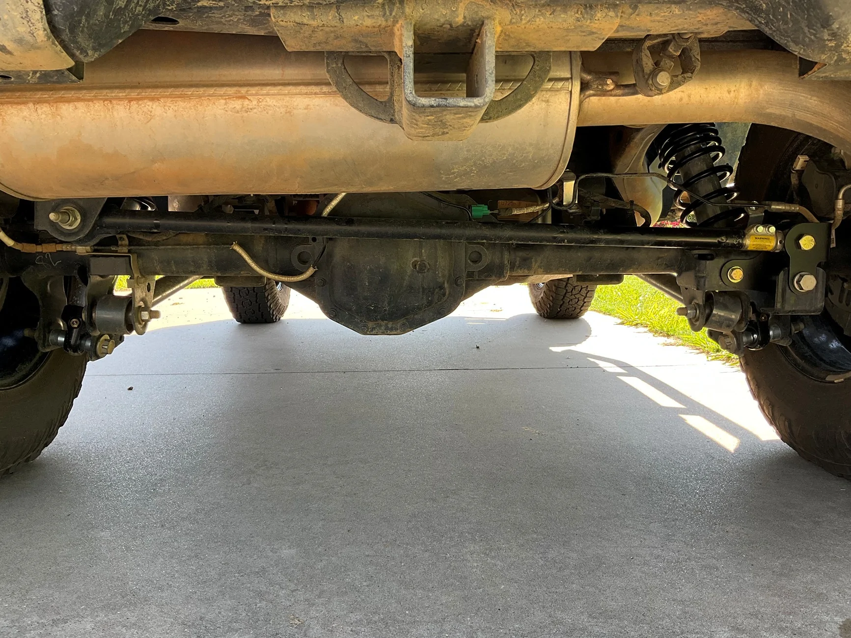

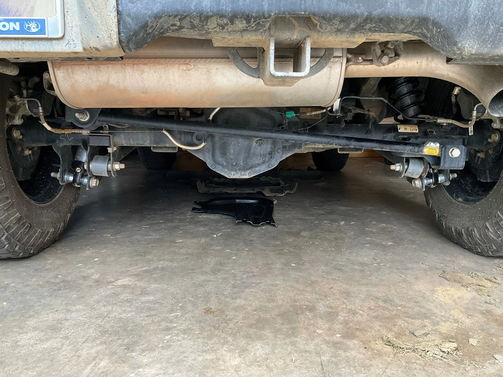

Eyeballing is close enough.
My bar was obviously not level after lift but came close enough after the relocation bracket.
Ford Bronco Adjustable track bar question bar
Ford Bronco Adjustable track bar question bar1

Not needed if your Panhard bar is near level at ride height.
This. To expound, I installed the Icon Stage 4 and my track bar (not made by the French company Panhard) was not level when I set the Bronc back on the ground. I got a track bar relocation bracket and it went back to level.
I did drive it a couple miles before I put the relocation kit on and it was "off" in a funny, noticeable way.

For me, the benefit of the adjustable track bar was the better joints that added articulation over the hard rubber ones on the factory bar.

How high was your lift?
Hard to say since there are so many stock suspensions that all sit at different heights.
I have Icon coilovers that probably sit an inch or so taller than sasquatch suspension. I've posted my axle to fender measurements before but can't recall what they are now.

Thanks. I’m putting my relocation bracket on later this week. I’ll see my what my track bar looks like now against your “before” picture. Just curious how level it will get.
