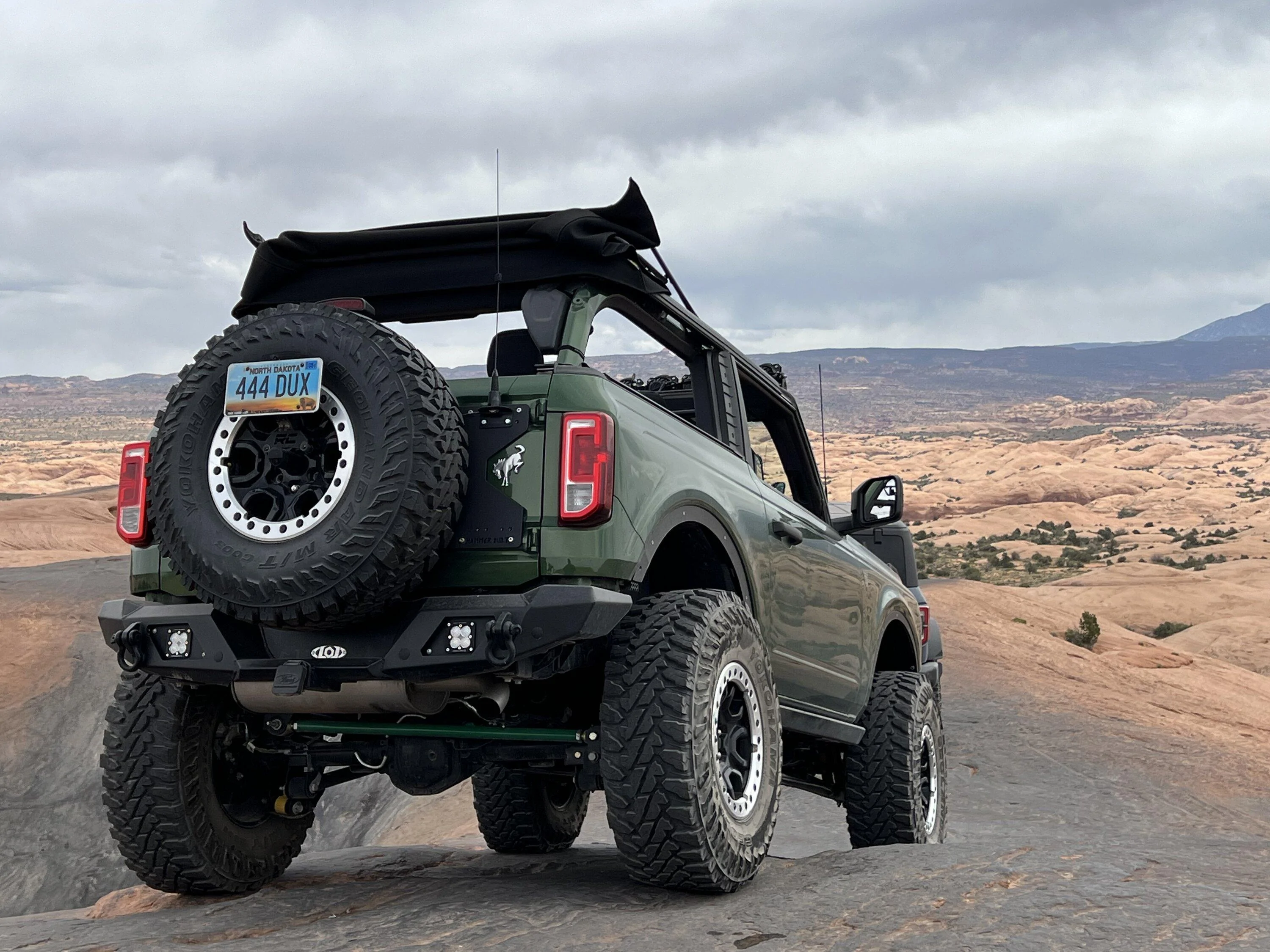

I run an adjustable track bar from Core 4x4, and the bracket from Rock Jock. Ran with just the adjustable bar for awhile, but handles a bit better with both. Here’s a peek, the bar runs more parallel with the axle with the bracket.
