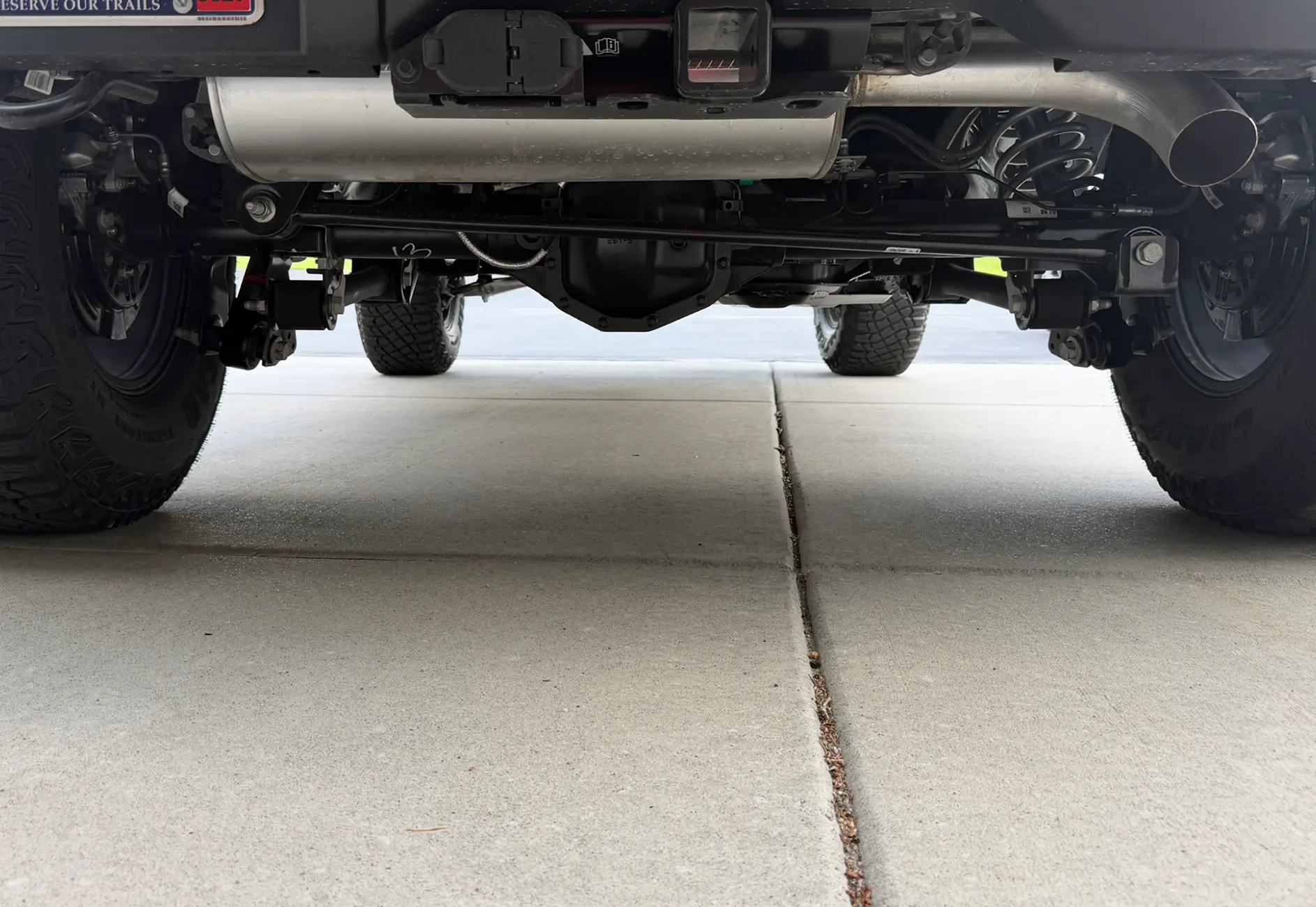

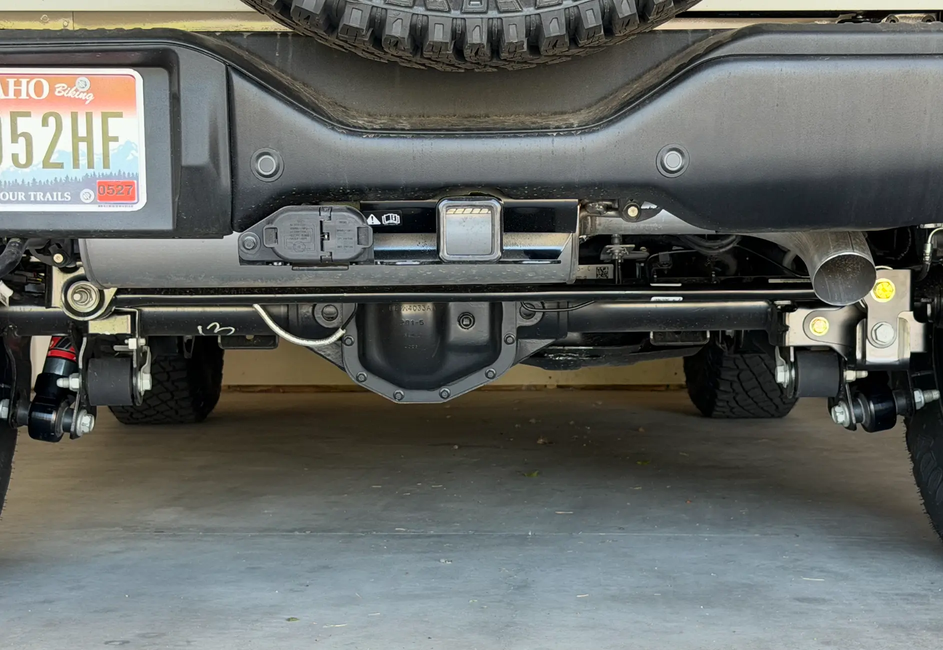

Installed the bracket, track bar is very level. Eibach coilovers at the lowest setting…..
Before
After
Nice!!!! Now when you turn at speed (not crawling), especially off-road on uneven terrain, you will notice the handling being more precise. Specifically - when it comes to "pointing" the vehicle while turning. Ride safe and enjoy the ride!!!! :)

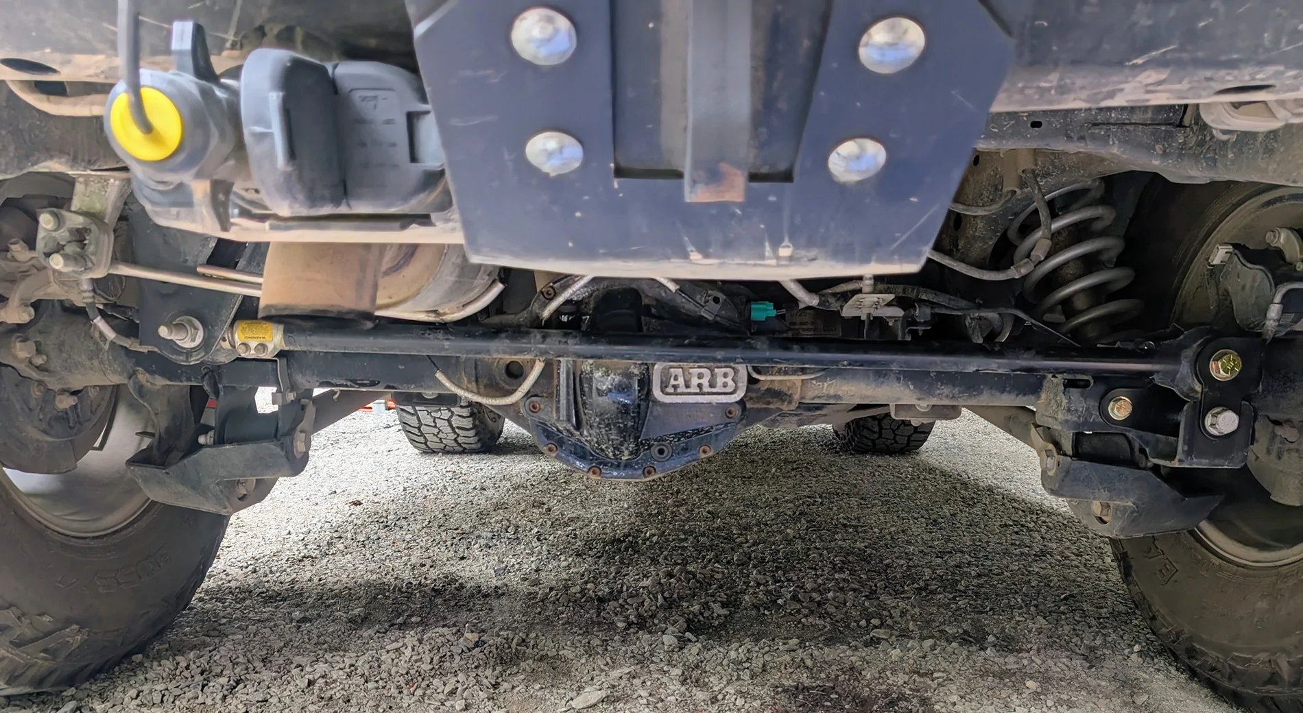

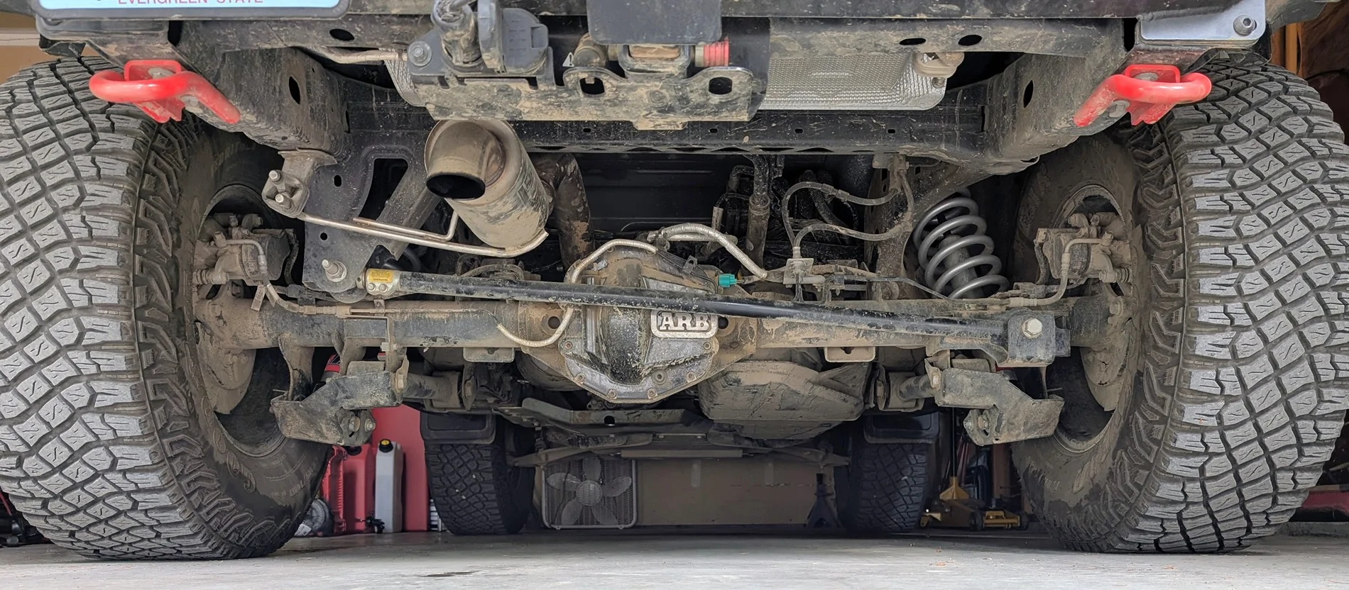

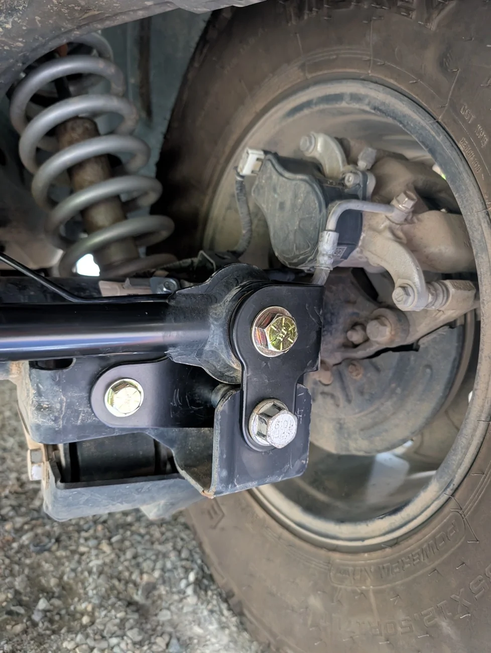

I installed the Rock Jock track bar relocation bracket today. I have the Eibach 2.0 Pro Trucks with the HD springs. It's about 2" of lift in the rear of my '22 2-dr WT at the lowest perch setting. I didn't think the track bar mislocation was significant, but it definitely flattened it out. I didn't drive far with it (on road only), but there were definitely some instances were the handling felt different. The rear suspension felt a little freer and turns tracked better. Super easy install. It seems it was a good $120. I'm also happy to report it can be installed with the RCI low shock mount/lower link skids in place.
