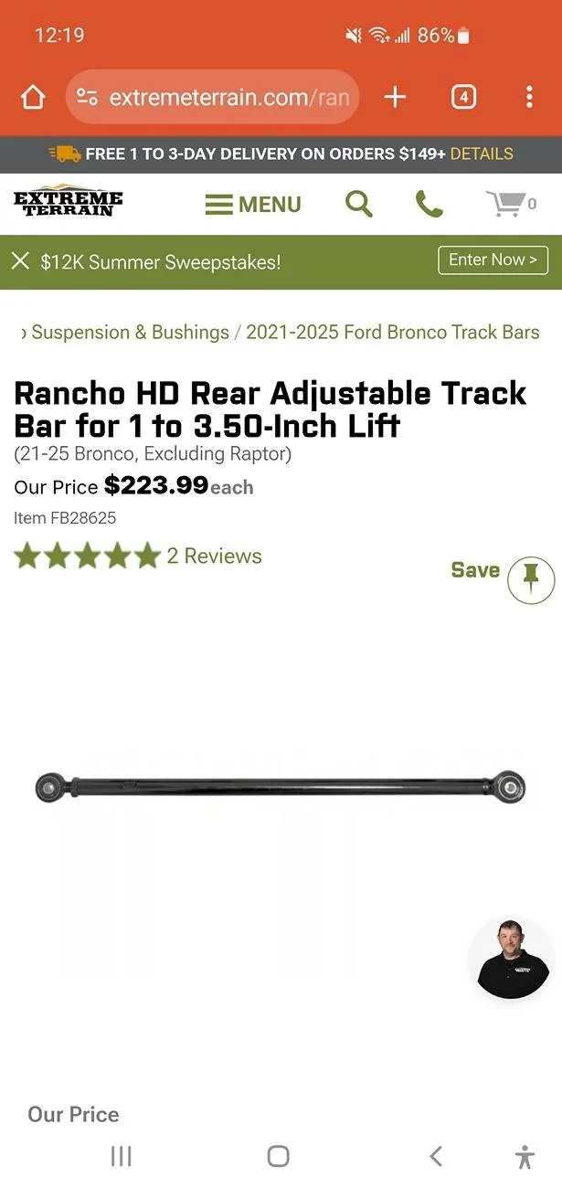

Appreciate it guys. I ordered the following, not breaking the bank.
Ford Bronco Rear track bar drop/relocation bracket necessary for 3" lift? Screenshot_20250620-121958_Chrom
Ford Bronco Rear track bar drop/relocation bracket necessary for 3" lift? Screenshot_20250620-122130_Chrom

RockJock relocation bracket and Rancho track adjustable track bar installed. Took 1.5 hours. There is definitely a noticeable difference in driving feel. Corners and curves feel tighter and less mushy. I thought the truck drove fine without the relocation bracket, I was wrong. Though not an accurate way to measure axle center, I measured the distance from outside of tire to fender and each side shows 2.25"
Thanks for the guidance.
