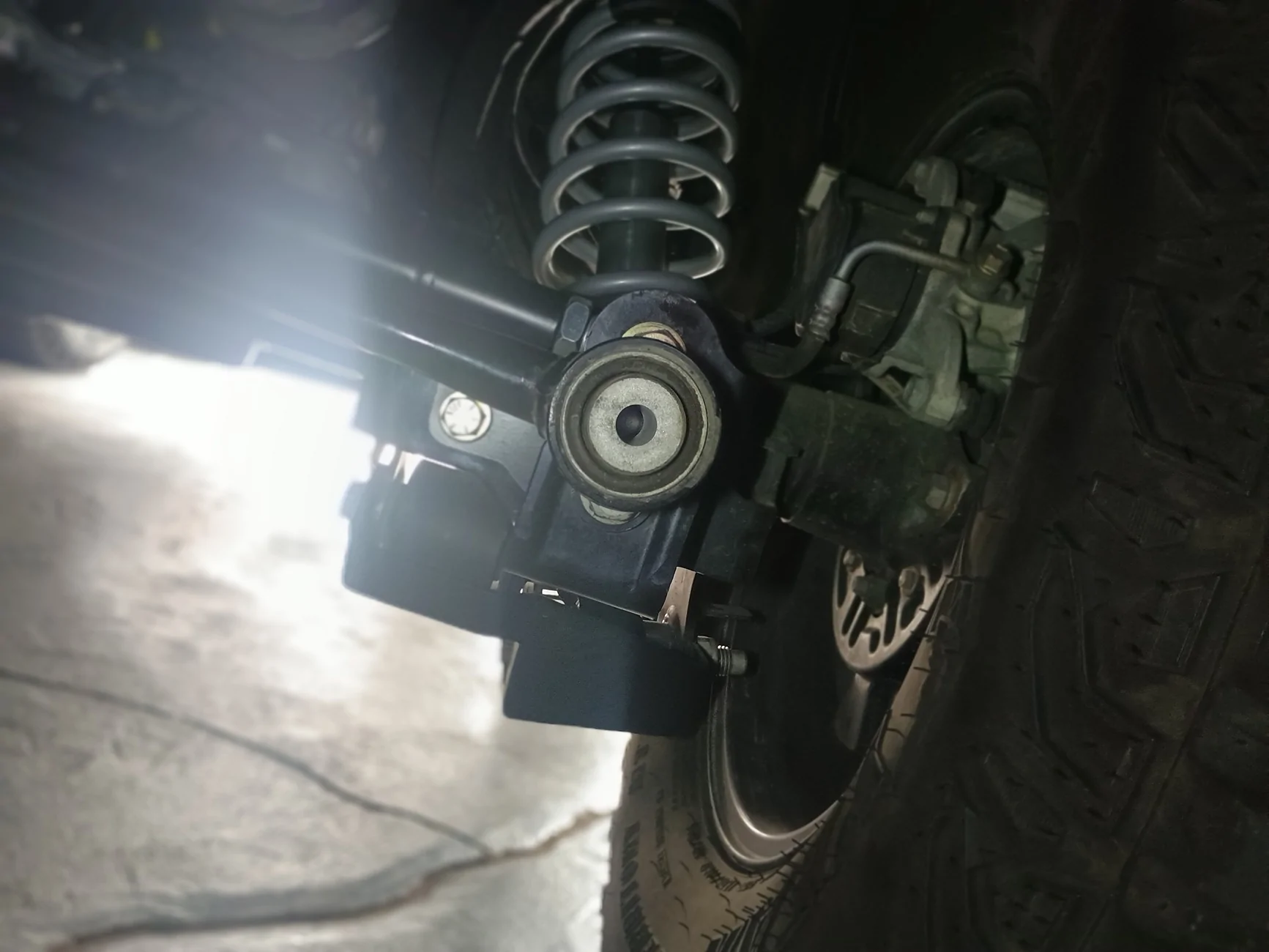

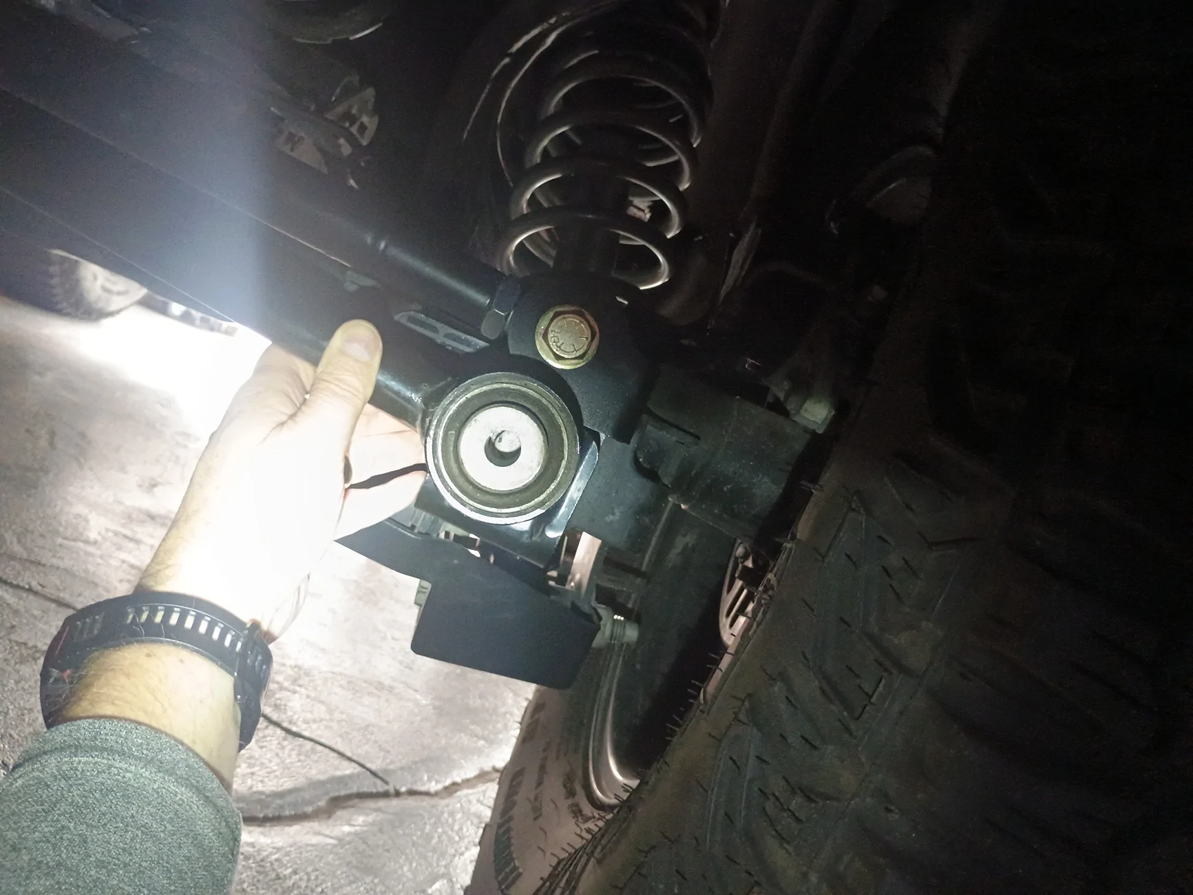

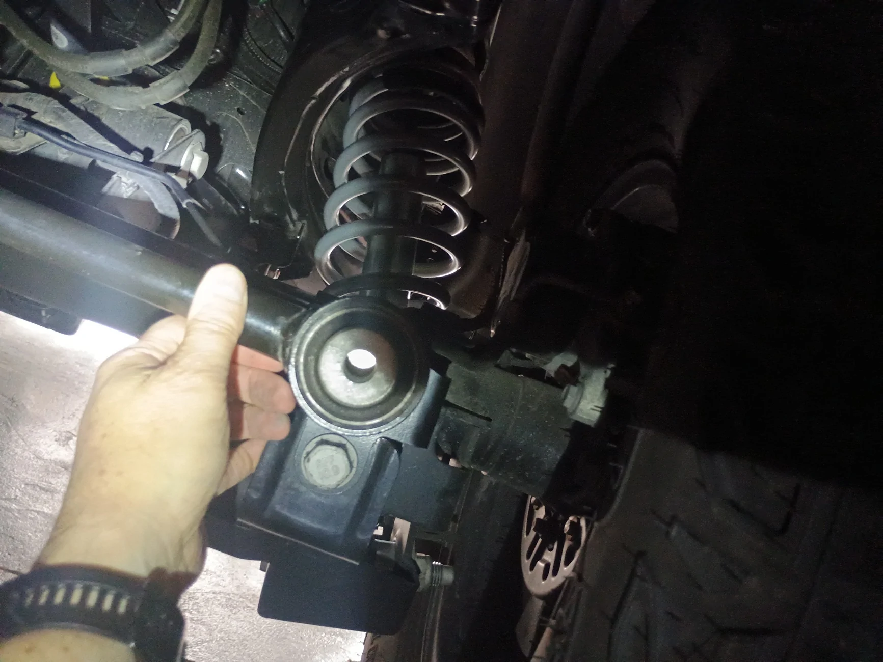

Thanks for the info. I thought since the ADS bar is supposed to work with zero to three inches of lift that if would have enough adjustment. I didn't think the relocate bracket would make enough difference that it wouldn't work. The ADS was adjusted very close to factory length for a starting point. It had about 1/2 of an inch of adjustment shorter left at stock length. It is now adjusted as short as it will goo. I will check the stock bar again but I don't think it will work with the relocator either. Good luck with your Bronco build.

ADS bar does not adjust very much shorter than the factory one. See photos. Not very adjustable at all.
Typically when you lift a vehicle the track bar has to be extended because the axle moves to the driver side. You need to measure from your frame to the outside edge of your tire. Use a small piece of wood or wood ruler then a long straight edge against the tire. Measure the distance than compare the other side. Then lengthen your track bar until axle is centered. An alignment can get it more accurate but that’s the cowboy way to do it.
If it’s adjusted shorter than factory and your axle is to far out on the passenger side you don’t need the relocation bracket.

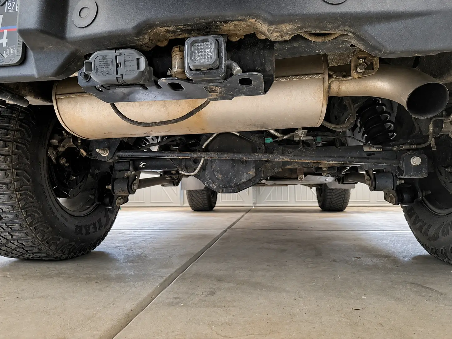

I'm surprised it's pushing out to the passenger side. It looks like they are the same length so maybe you don't need the bracket. How much lift did you get over Sas with the coilovers? I have the adj ProComps and the minimum setting gave me 1" over Sas and I could feel the rear jumping around and the bracket fixed most of the problem. My bar is pretty level with the bracket. Mine is a 2 door and it looks centered.

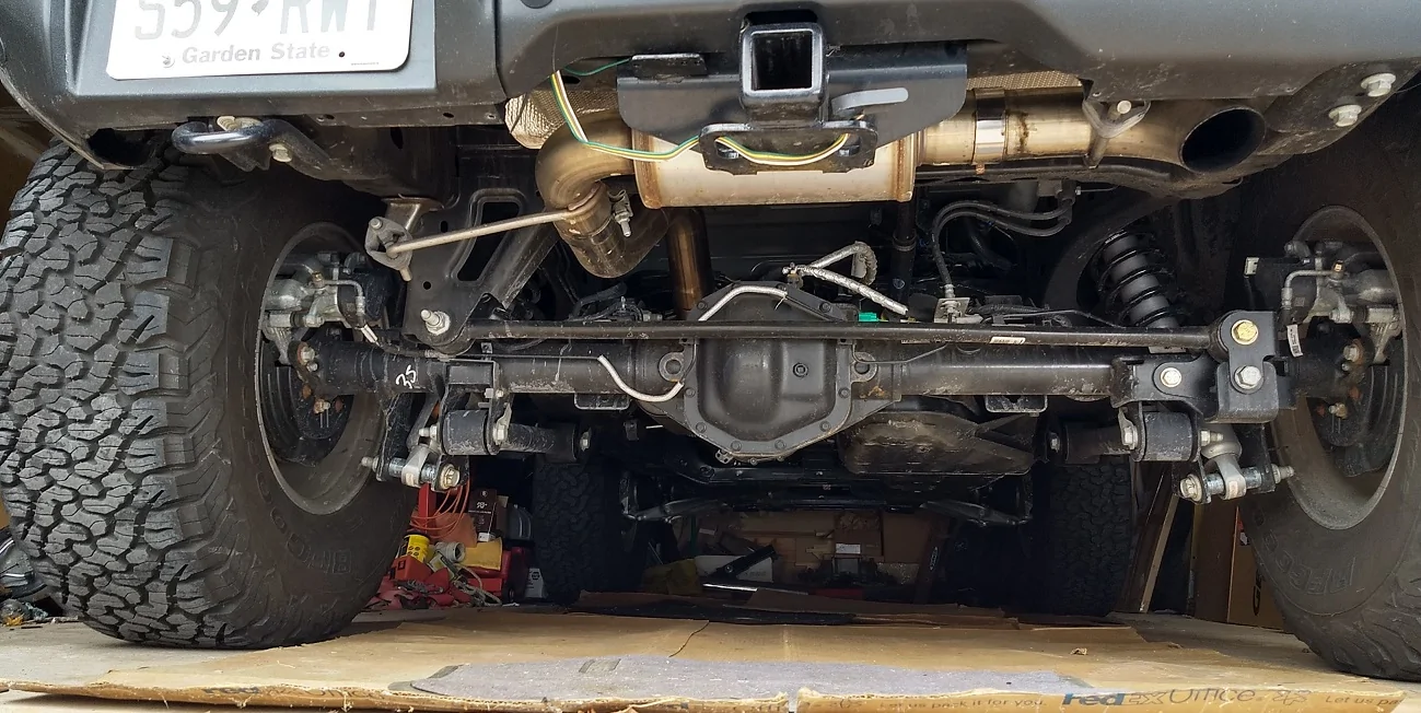

Man there's so much information here, I'm still undecided. I have a Wildtrak with HOSS 3.0 running the Zone 2.25" lift kit. I haven't measured for any offset yet but the rear bump-steer/shimmy I get when hitting bumps on pavement is dreadful, even notice it going down the highway.
Per Zone the rear only lifts for 1.25" while the front is 2.25" to reach that leveled effect.
Is 1.25" too little of a lift to consider a bracket and would a bar be better?
As it sits currently in stock configuration.
In my unprofessional opinion, a relocation bracket will help you. Also, in my unprofessional opinion and personal experience, maintaining some rake helps with the bump steer/shimmying. Since lifting my Bronco and adding a relocation bracket, I ended up raising the rear just a tad more than what the Fox's provided out of the box, to get close to the factory rake. My handling feels way better having some rake. Before reintroducing some rake, my front-end felt a bit "floaty" when hitting bumps.
Leveled looks good, but rake is good.
Yes, I only went up around 1" in the rear and you could really feel it. The bracket helps a lot, but there will still be some jumping around on bigger bumps on the highway.
My front end feels well off and planted so far, I've been on this lift for a year but reached the point where I've had enough of the rear shimmy and bump steer. I have one particular spot in the road by my house that when the rear hits it it shimmies and my passengers almost always go "what was that?" LOL.
That's good to hear, I ordered the RJ bracket for now. Will consider a new bar in the future once I see how it feels with this bracket.
