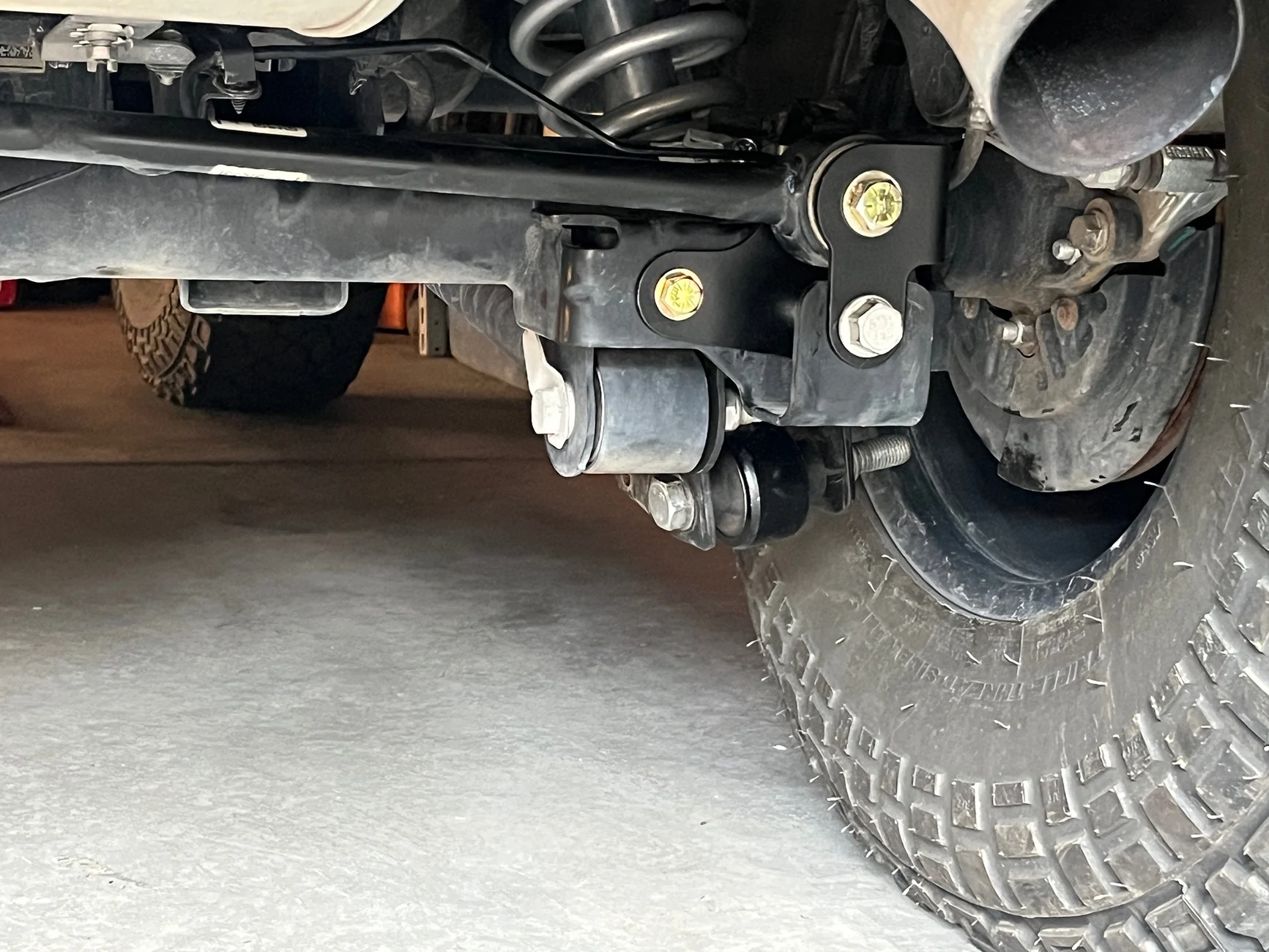

Installed the RJ relocation bracket this afternoon. I’ll take it for a spin tomorrow to see how it drives. Time will tell if the bracket contacts the frame while wheeling (Eibach Pro Truck 2.0 HD coilovers)
I’m contemplating swapping the relocation bracket for an adjustable track bar instead to avoid the frame contact possibility. Any track bar recommendations?
Rockjock / Metalcloak / Carli / etc.

An adjustable track bar doesn’t do the same thing as the relocation bracket which corrects the geometry. Adjustable track bar is used to center the differential, it does nothing for the geometry.
That being said, you must really have the adjusters cranked way up for your track bar to be at that much angle still. Too much lift in the front will be hard on your CV’s and steering, just an FYI.
Thanks for your reply. Yes, I’m aware (about the CVs). I’ve had the RJ relocation bracket on my bench all summer, but recently swapped my suspension from FOX coil overs to the Eibach Pro Truck 2.0 HD coils. Long story, blew up one of my FOX coils about 500 yards from the top of Engineer Pass in southern CO. I purchased the RJ relocation bracket long before I made the switch to Eibach. Hence my concern that the RJ bracket may contact the frame. My logic around swapping the relocation bracket for an adjustable track bar is that it may be my best choice without having to worry about smashing the bracket at full stuff.
Oh yes I agree, my truck is sitting high right now. These are the factory settings from Eibach and they tower above my 37’s. I plan to drive it back and forth to work a few days and then crank them down a bit. This way it may settle a bit first. 100% agreed on the CV’s.

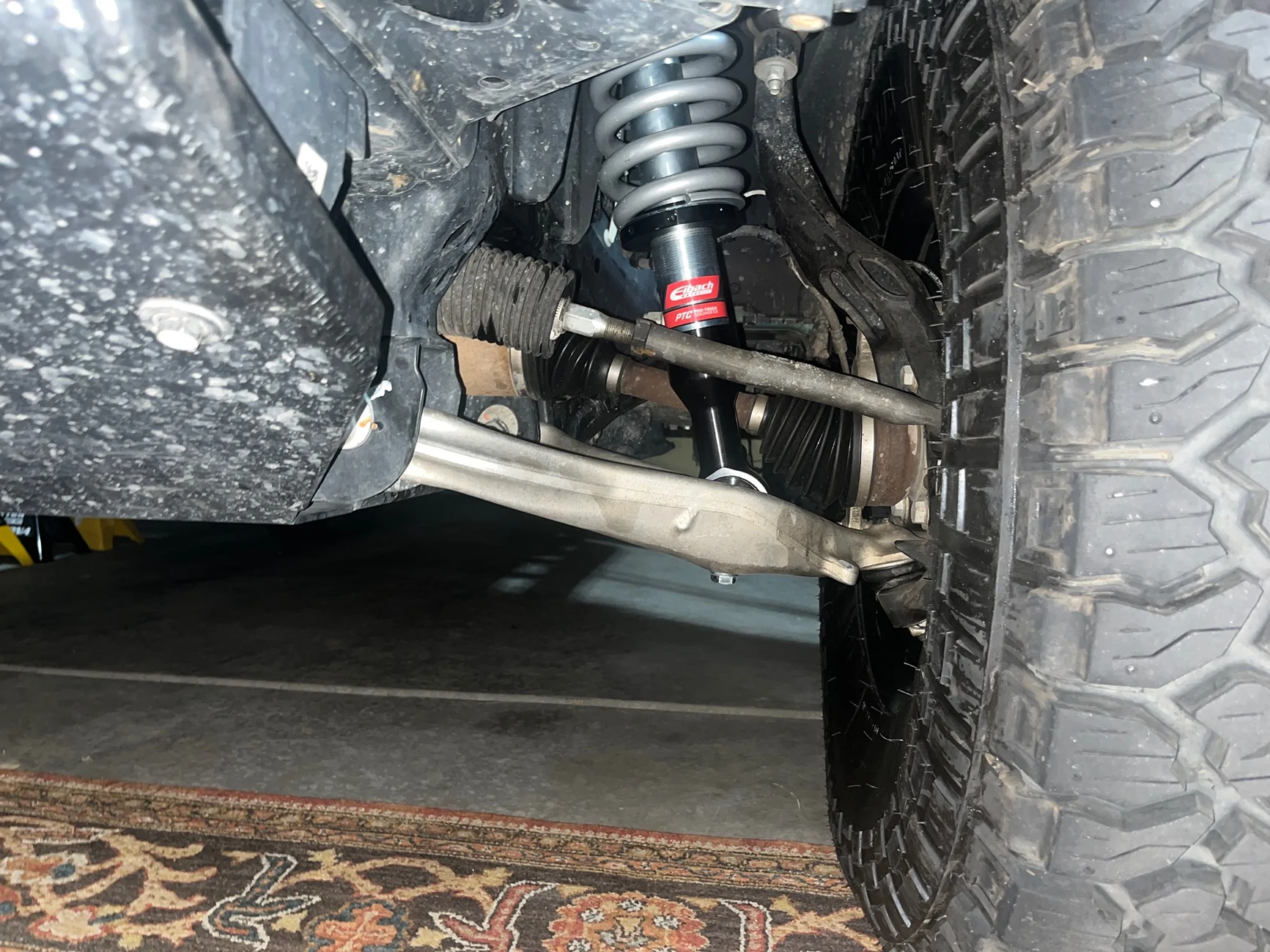

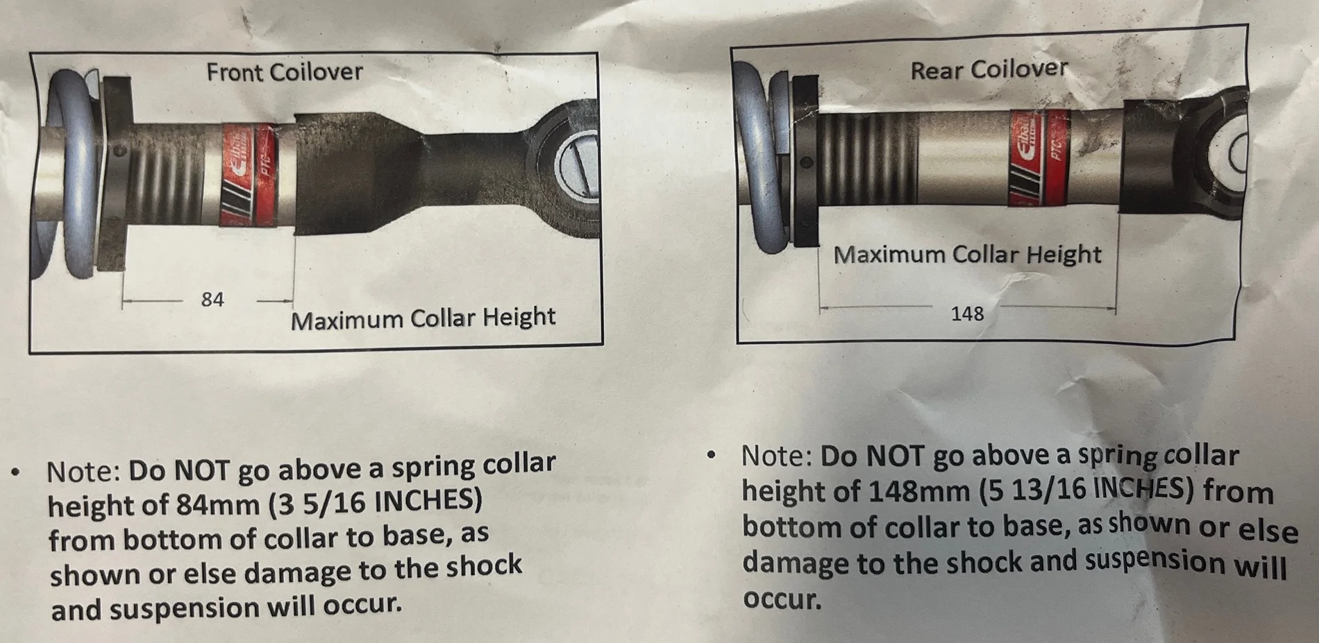

Honestly I’m surprised how much preload these Pro Truck 2.0 coils have from the factory. These are the maximums in the instructions.
Ford Bronco Rear TracBar Relocation Bracket - Get One! IMG_4627
84mm front / 148mm rear. Out of the box mine were set at 82mm front / 128mm rear. Rough measurements put my front fender flare 7” above the tire and the rear 8”.

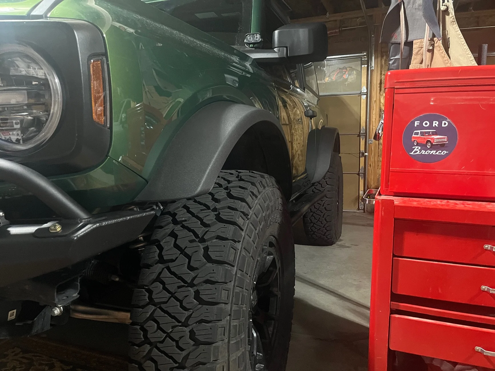

My Bronco is a 2D / 37’s lots of armor plus water / aux fuel / drawer system / cooler full of beers / camping gear, etc. My Green lady is a bit of a pig.
The ability to adjust the preload in these coils (when installed) and get an HD spring kit from the factory is why I went with Eibach this time around. Hard to see because perspective is misleading but these are my CV’s sitting flat. So they definitely can come down a bit.

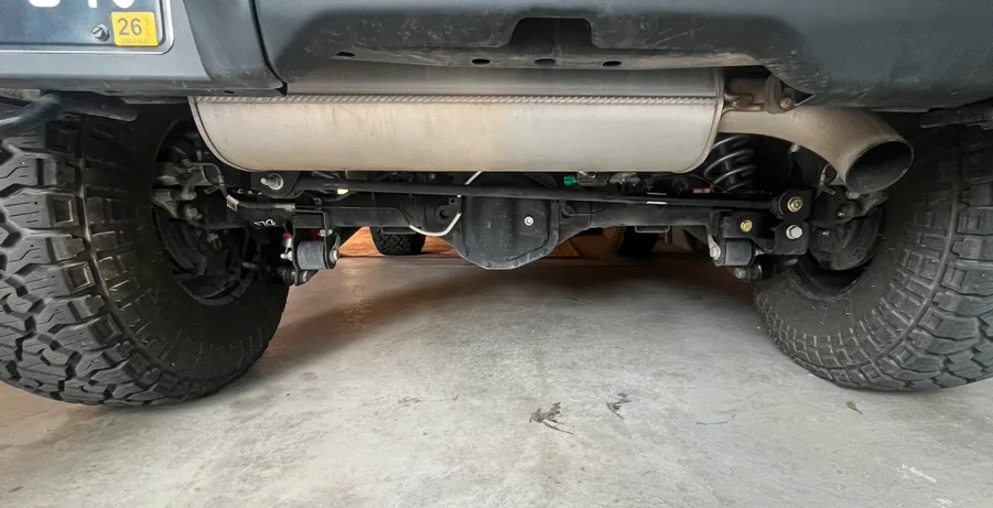

I’ve had the RJ bracket for a while, added soon after adding my ADS setup. I’ve had some noise coming from the rear ADS coil over, which ADS thought either the upper/lower coils were out of sync or I needed an adjustable track bar. I took it to a local shop and they ordered new 350# upper coils, currently have 300# upper/400#lower coils, and AGM sliders/dividers. They said the upper coils were too compressed with my weight, but the bottoms were good. I have about 2.25” of preload in the rear. The shop disagreed that the noise was due to .25” misalignment and that the track bar would resolve. It was more likely due to the pre-load/needing a heavier spring/better divider. They did recommend Rock Krawler though for any future upgrades.
Though I was informed it wasn’t required, as I was only shifted to the driver .25” , my OCD kicked in… Rock Krawler had a nice Labor Day sale and no tax, so I snagged their adj. track bar too. It’s super stout! I can notice a slight improvement in tracking/handling over just the RJ bracket. Noise is still there, as the shop predicted. Awaiting my other parts to come in….
Pics of the adjusted RK track bar, which I believe I only tightened 1/8”, and geometry looks great:
