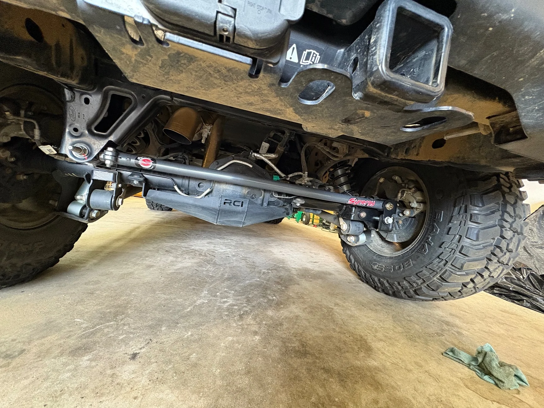

I’ve had the RJ bracket for a while, added soon after adding my ADS setup. I’ve had some noise coming from the rear ADS coil over, which ADS thought either the upper/lower coils were out of sync or I needed an adjustable track bar. I took it to a local shop and they ordered new 350# upper coils, currently have 300# upper/400#lower coils, and AGM sliders/dividers. They said the upper coils were too compressed with my weight, but the bottoms were good. I have about 2.25” of preload in the rear. The shop disagreed that the noise was due to .25” misalignment and that the track bar would resolve. It was more likely due to the pre-load/needing a heavier spring/better divider. They did recommend Rock Krawler though for any future upgrades.
Though I was informed it wasn’t required, as I was only shifted to the driver .25” , my OCD kicked in… Rock Krawler had a nice Labor Day sale and no tax, so I snagged their adj. track bar too. It’s super stout! I can notice a slight improvement in tracking/handling over just the RJ bracket. Noise is still there, as the shop predicted. Awaiting my other parts to come in….
Pics of the adjusted RK track bar, which I believe I only tightened 1/8”, and geometry looks great:

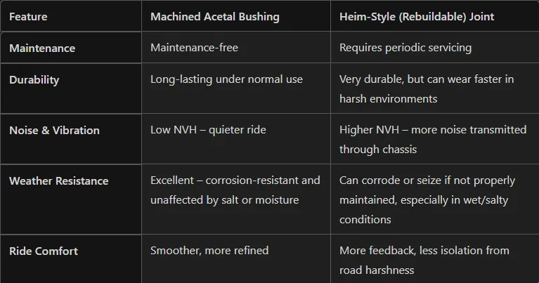

ADS provided some helpful information when I inquired about their design decisions for their track bar:
We opted for a machined acetal copolymer bushing on the frame side instead of a heim-style (rebuildable) joint for several key reasons, especially considering long-term durability, ride quality, and environmental exposure.
Machined Bushing vs. Rebuildable Joint – Key Differences
While heim joints are known for their strength and articulation, they tend to transmit more noise and vibration through the chassis — which can be noticeable in daily driving. They also require regular maintenance, especially in regions with rain, road salt, or high humidity, as corrosion can affect performance over time.
The acetal bushing, on the other hand, offers a quiet, predictable ride with excellent resistance to environmental factors. It’s ideal for customers who want off-road capability without sacrificing comfort or adding maintenance tasks.
We’ve found this setup to be a great balance for Bronco owners who use their vehicles both on and off the trail. And while the bushing isn’t rebuildable, it’s designed to last and can be easily replaced if needed — though under normal use, that’s rarely necessary.

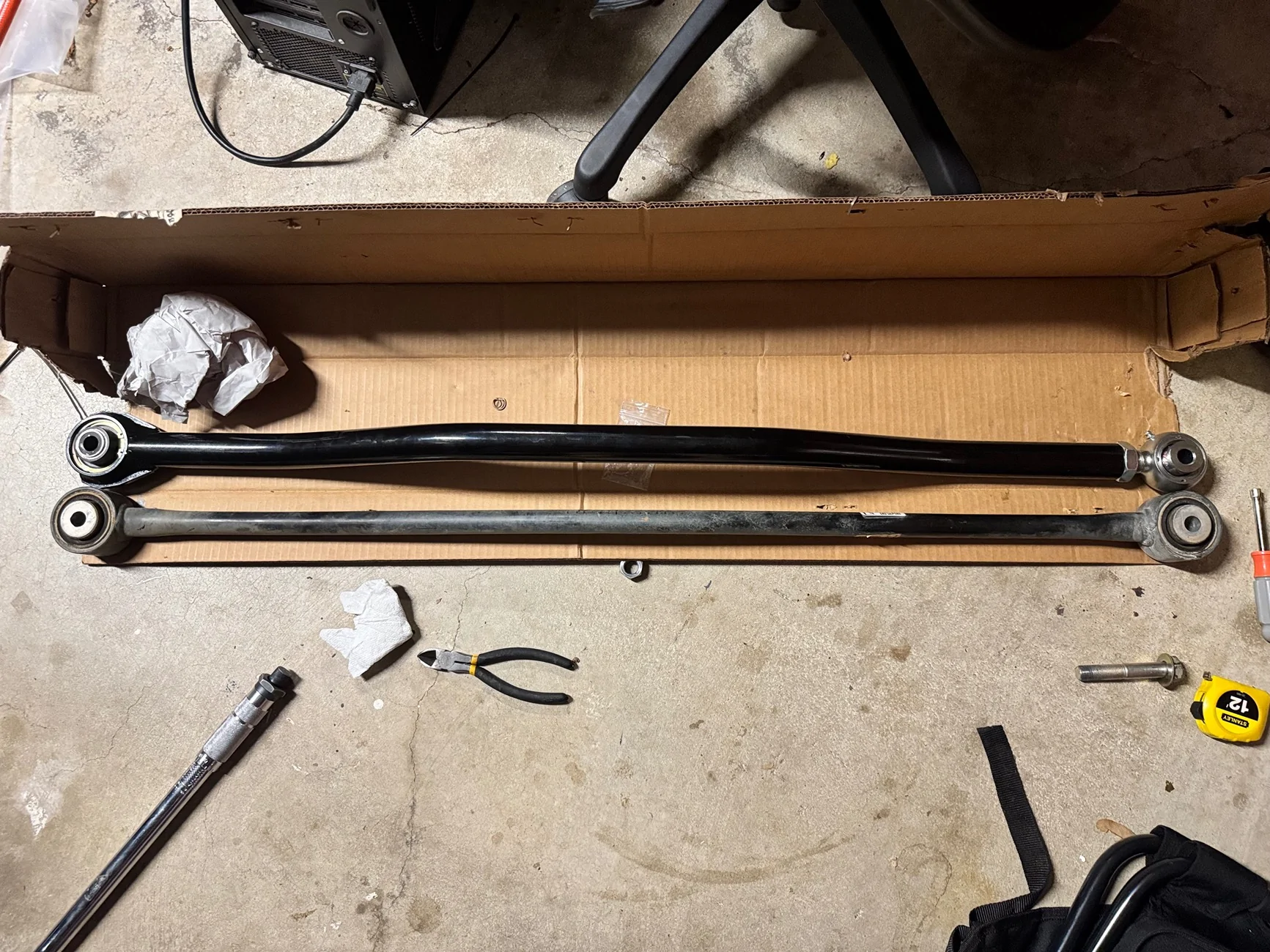

@JF Bronc - installed. This thing is BEEFY. Much more stout than the Icon version I had on my 2021. I guess time will tell if the bushing/heim joint hold up. But, they’ll both be covered in fluid film a majority of the time.

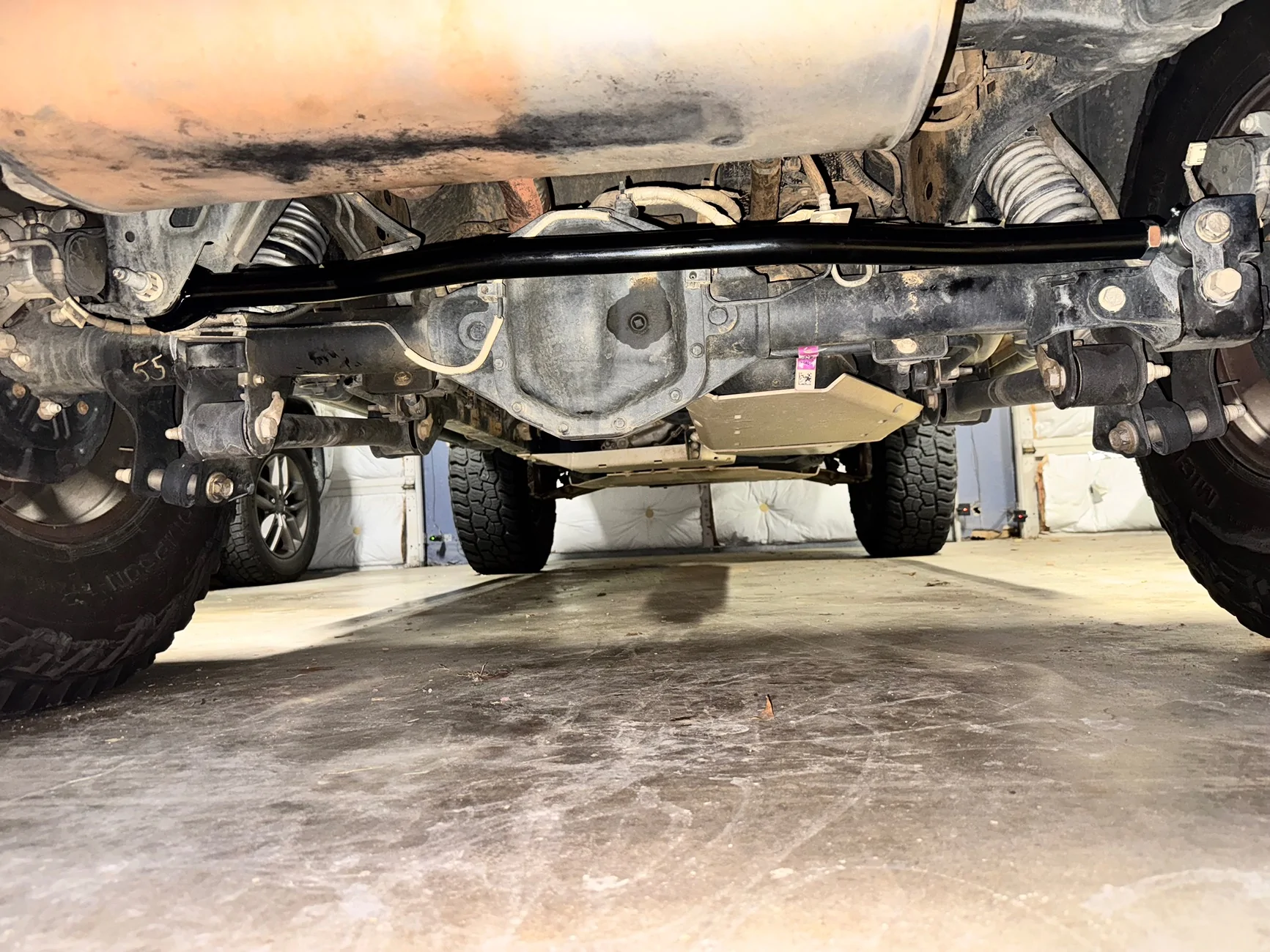

For whatever it’s worth, I installed a track bar relocation bracket the track bar is now level. Running clip 5 on my 6112s 2 door Sas. Didn’t really notice much of a difference with the Bronco driving. Getting alignment and rear control arms installed tomorrow. See if that makes any difference. 🤔
