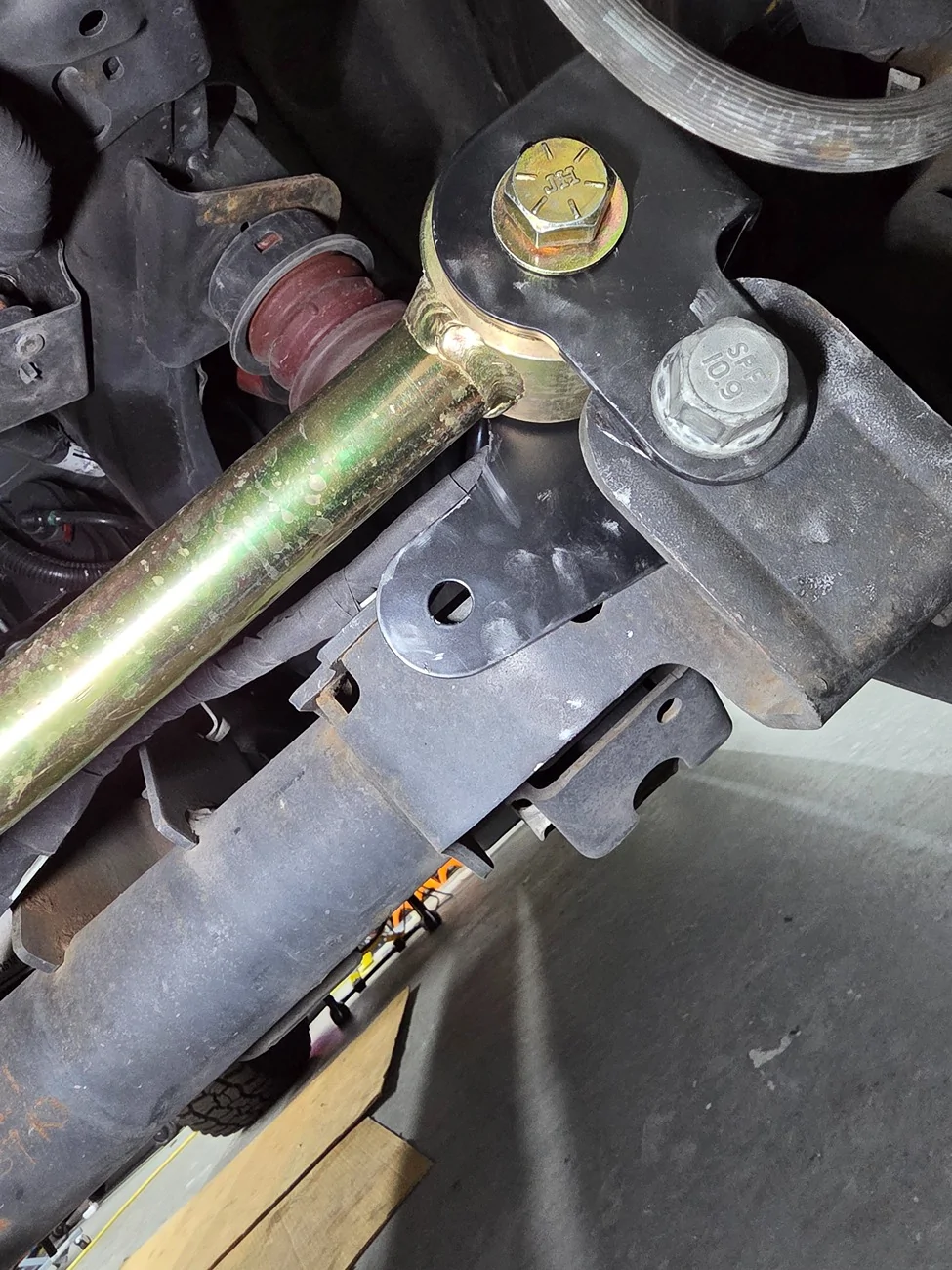

Lifted my badlands SAS 6 months ago. Finally installed the bracket today. It fixed everything. Left it on the ground and it was easy. 1 hour install m. Corrected the bucking. Eibachs took me up 2.5” over Sasquatch and it was off centered greater than 3/8”. Now I’m within 1/8” and will get an alignment Friday
Great to know, I have the exact same set up in almost everyway. Bracket to go on soon. Thank you for the information. Nice to know!

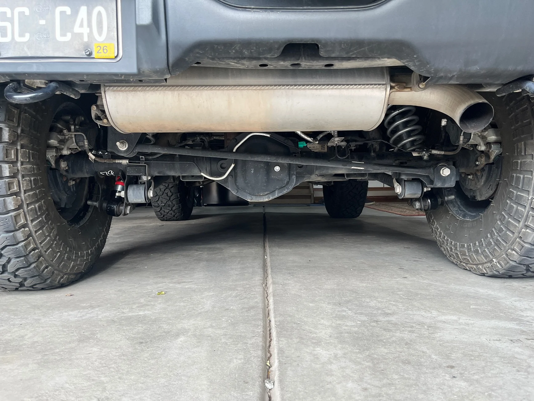

Hi guys, I’ve had a RockJock rear trac bar bracket on my workbench all summer. Was planning on installing it before a recent 4x4 but life had other plans. During that trip I blew up a fox coil over, so on Friday my buddy and I installed a set of Eibach Pro Truck 2.0 HD coils on my 2Door. Long story, I could not just replace the one damaged Fox coil.
I’m traveling this week so the truck can sit and maybe settle a bit while I’m gone. I installed the Eibach kit at factory settings, out of the box the front coils were almost at the max thread suggestion (within 4mm) shown in the instructions, but the rear has plenty of room to adjust up. That said I may actually crank these down a bit, TBD as I need to drive it more and load the back with camping gear to see how it behaves.
Questions please:
- I’ve read that with the Eibach’s RJ bracket may contact the frame depending on ride height adjustment due to the shock stroke. Any thoughts on that?
- I’d wager it would be better to wait until after I adjust the suspension before I install the trac bar bracket. If I crank them down it won’t be much. I’ll keep some rake in the back as that’s my preference / weight etc. Any comments?
- This is a pic of the rear as it sits now so clearly the bracket would be needed. Any thoughts on not using the RJ trac bar kit with these shocks?

I have the exact same set up. I believe it's true they can contact....but I also heard it has to be one heck of a hit to make that contact happen. Myself...not worried about it :)
Ramble_Offroad
Nels
Aug 14, 2020
2,057
4,266
Northern CO
2014 2D JK on 35’s
I’d wager the same would be true of any other trac bar relocation brackets. Meaning the Pro Truck 2.0 rear shock’s stroke may cause contact under full stuff.
If so, what are my other options to improve roll center and rear bump steer? Would an adjustable rear trac bar be the next option that would not cause a potential contact / conflict?

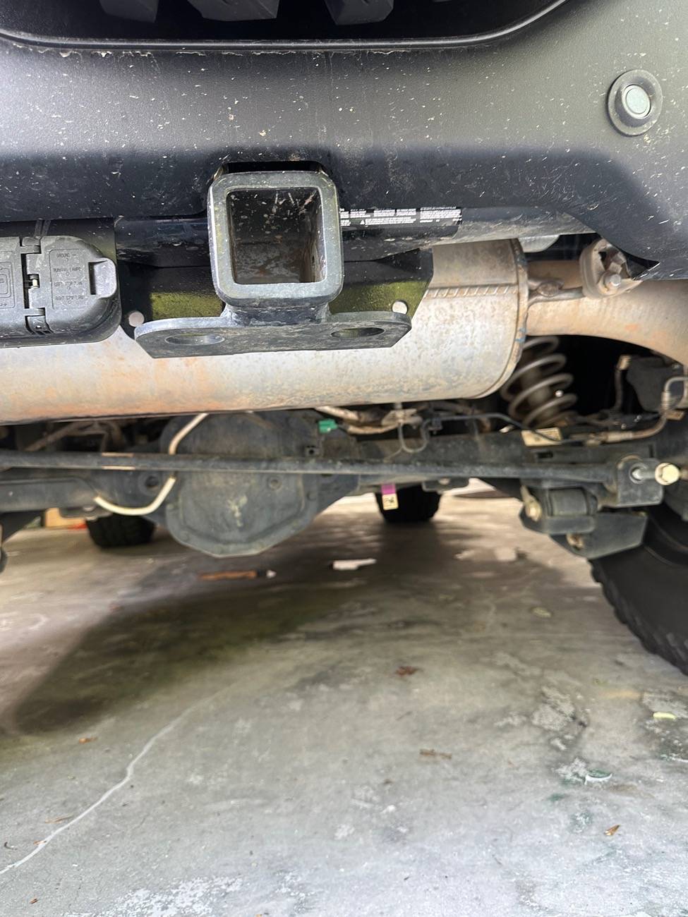

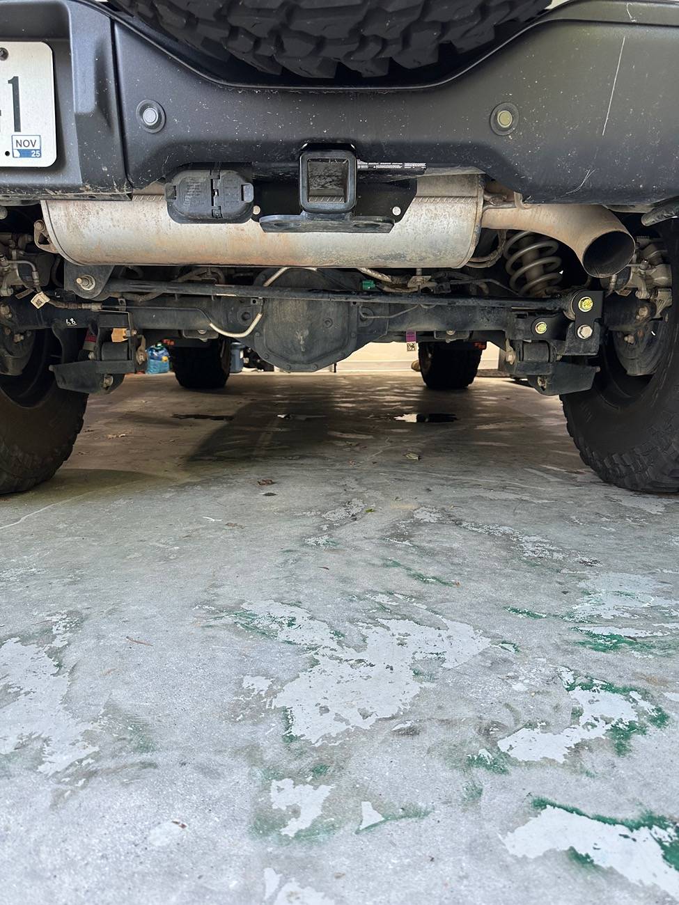

question, so i have a raptor model, 1" lift in the rear, i know rockjock says sasquatch package is +1in lift is ok.
I believe if i install this, my passenger side will be slightly higher than the drivers side. Will that be ok. It will be more level than it is now though.

Yes. The whole point of the relocation bracket is to correct the geometry and allow for better handling characteristics. See this previous post I wrote that explains it :) - https://www.bronco6g.com/forum/threads/rear-tracbar-relocation-bracket-get-one.104993/post-2398111

Fail lol. Both rock jock and boss 4x4 have the same results with the raptor . Back to sq 1
