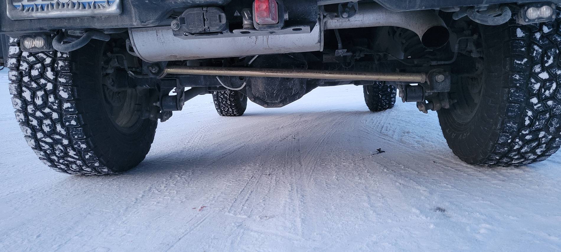

I don't meet the min. 18" compressed shock length in the rear for the RJ bracket but have the 2" difference from left to right on the bar. Would it be worth putting it on? Trying to think what I would damage by hitting the frame.
May depend on if it hits hard because of a high speed jump landing or just sets down on it during max articulation while crawling. Theoretically mine would hit also but if it has hit I didn’t notice and I have had it fully flexed out. I don’t jump it and probably won’t ever. I’m running the Eibach 2.0’s with the standard soft springs.
^^This^^
I'm running the Eibachs as well and have been fully flexed at slow speed w/o contact issue. I would definitely recommend the relocation bracket, made a huge difference in rear bump steer for me.

Interesting. Came here to scout these sort of comments. I have the Eibach 2.0s on mine and had ordered then returned my RJ bracket for fear of it smacking frame at some point. I don't jump my Bronco and any off-roading is pretty casual trail use but I was concerned of any highspeed driving and hitting the wrong pot hole, etc and having it cause some sort of ripple affect that could become problematic. I know I could use one. I'm about to install a rear sway bar on it to help some of the lateral movement I notice driving. It has some slight shiftiness at times. Maybe will reassess after sway bar added.
Funny, I purchased the RJ bracket from a forum member and had the same concerns about contacting the frame so I sold it to another member. Six months later I ended up buying another RJ bracket and take a chance on contacting the frame. My adjustable track bar is now almost perfectly level...No contact issues whatsoever slow speed and the improvement in bump steer was impressive IMO.
It's going to depend on how you lifted your rear end. If you added a spacer lift, you can add the actual thickness of the spacer to your compressed shock length. If it's a spring replacement or spring perch type lift, your original compressed length doesn't change and you can still contact the frame. It will just take more downward force or energy to bottom out the shock.
