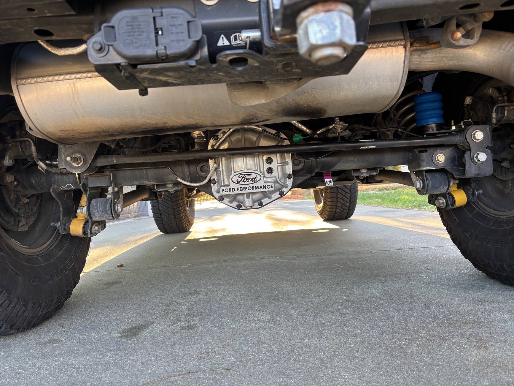

In the picture below, the rear suspension is lifted approximately 2.5”. With the RJ bracket my stock tract bar is nearly perfectly level. In this photo there’s about 200lbs of gear in the rear storage area.
Perfect. Thank you for the info!
Do you consistently have the 200 lbs. of gear in your rig? I'd think that you would adjust the track bar/bracket setup to conditions that you most frequently find yourself in - in my case, zero load except a Ford Accessories metal drawer in the trunk full of recovery gear... totaling maybe 60 lbs.
Normally about 100 pounds (this includes the extra weight of the 38” tire and gate brace) loaded it up before I took this photo. Appears to ride about 1/2” ish lower with the extra weight. I don’t have an adjustable bar & the bracket is fixed

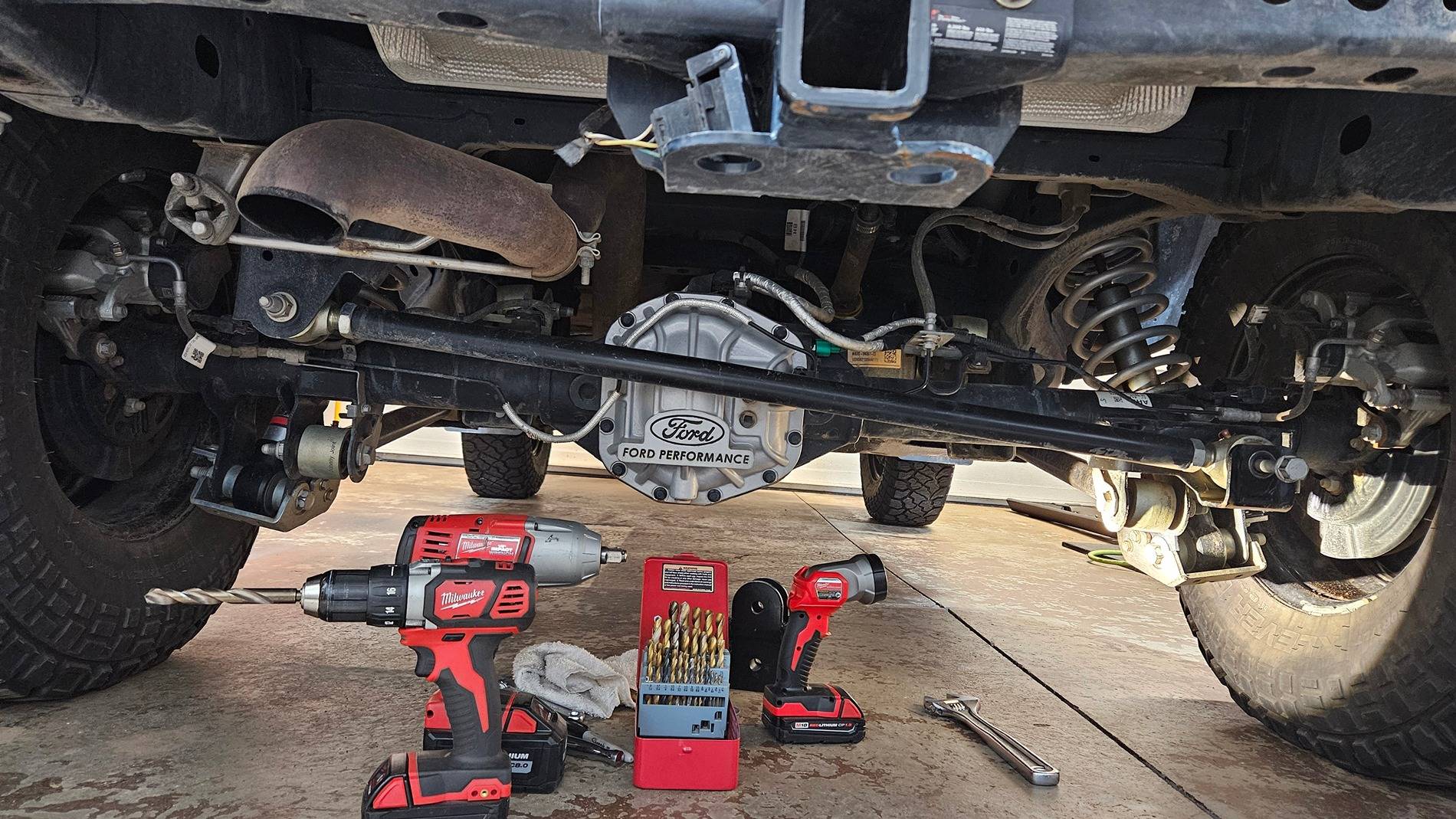

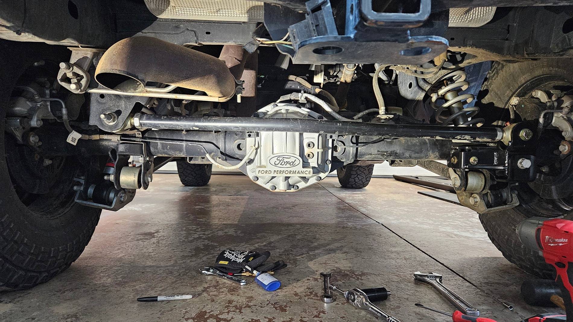

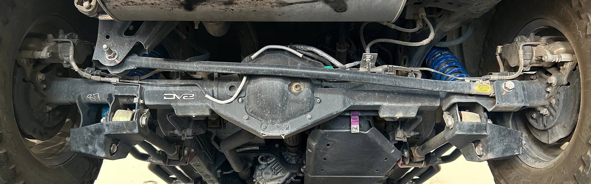

Got the FabTech one installed. It raises the track bar up 3". Hopefully I don't hit the frame under full compression. Will test that out...
Ford Bronco Rear TracBar Relocation Bracket - Get One! 20241209_074330
Sweeet man! That looks GREAT! Looks like you also have the RJ Control arms and Trac Bar. Noice!!!!
Man........that diff cover is sooooo sexy. I want one so bad but don't think my DV8 diff skid plate will fit it. UGH :(

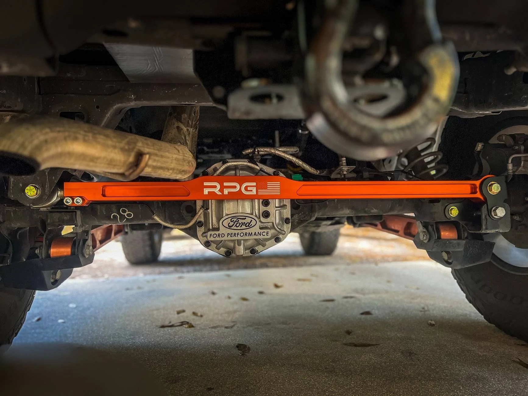

Installed the RockJock bracket w/ RPG bar this weekend. Came out 👌

HOLY SEXY trackbar Batman!!!!!
Haha it is quite the beast, however I do wish it was adjustble while installed. Que sera, sera I guess.

The Fabtech bracket looks beefer than the Rock Jock bracket. Made of 1/2" steel vs 3/16" of RJ's and It adds a gusset brace, wraps around the axle mount with an extra mounting bolt. Don't know if its necessary but looks heavy duty. Keep us posted on how the install goes.
I highly doubt it is made from 1/2" steel. It would be way too heavy and completely overkill. It looks more like 1/4" plate.
orion
Jeremy
Nov 23, 2020
1,317
3,271
17' F-250, 17' Explorer
It is indeed 0.25 inch!
