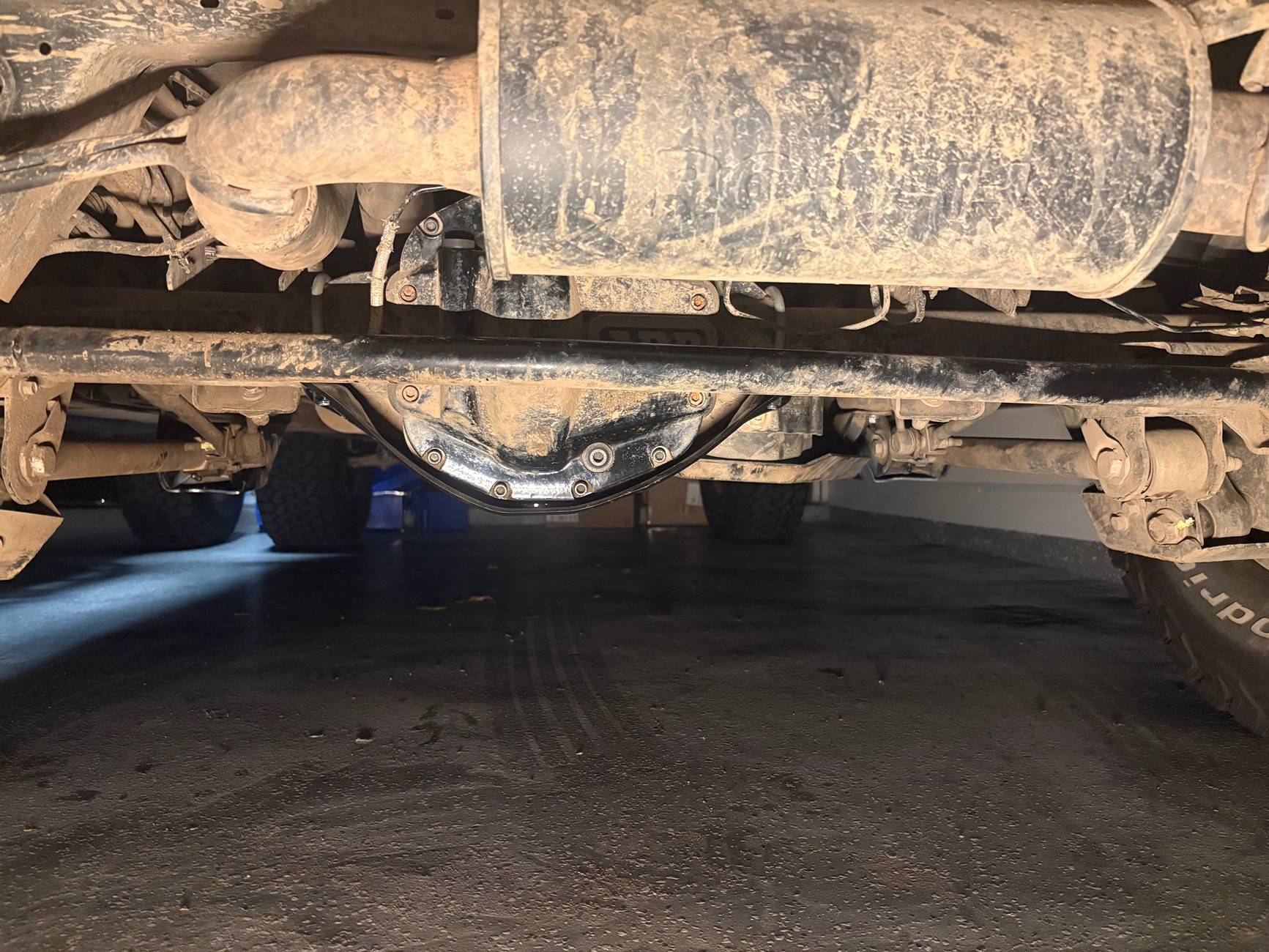

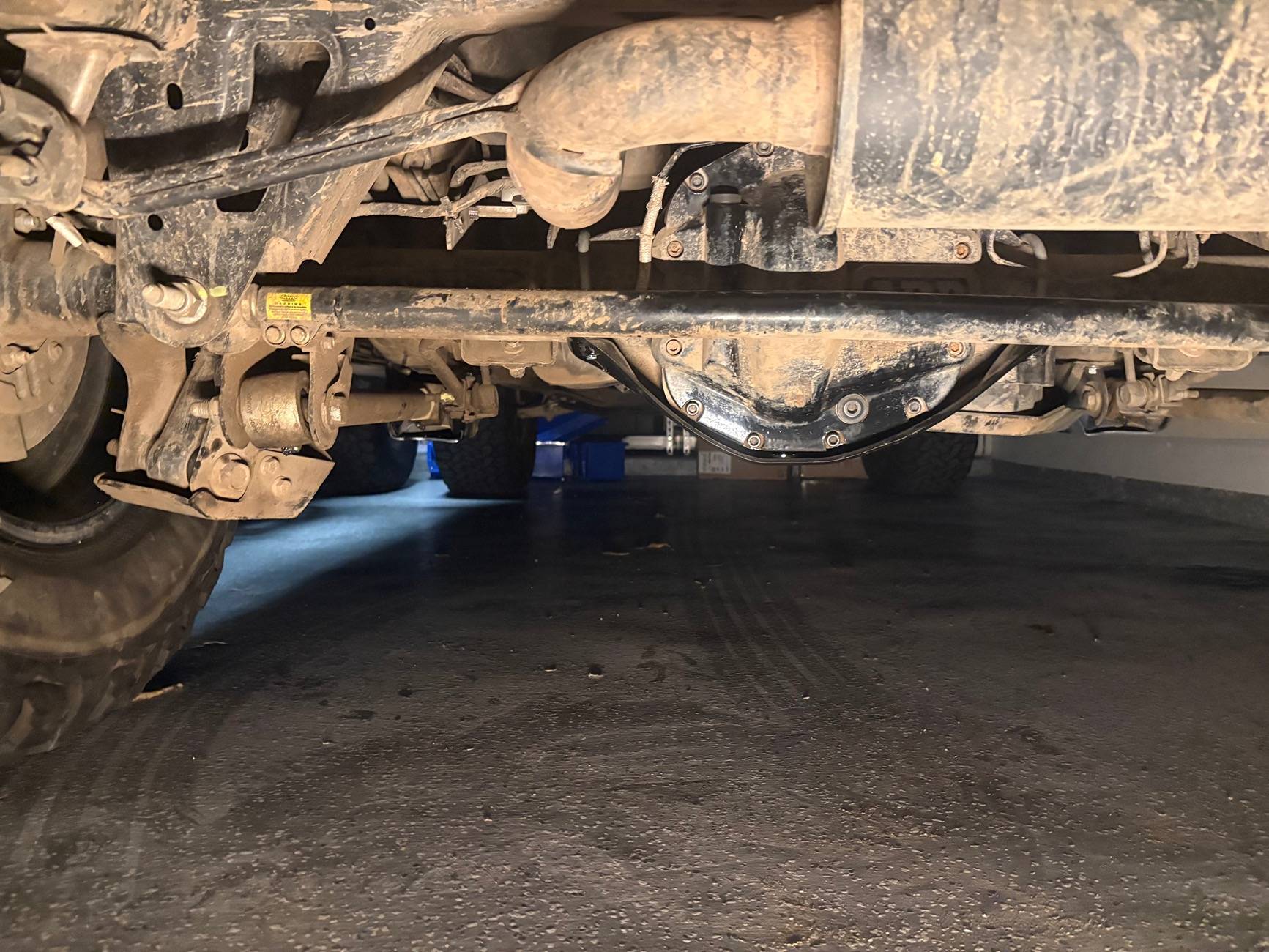

After looking at my lifted & settled setup closer, I’m dead level at 0 degrees measured. Looks like I don’t need the relo after all first glance, but I articulate a lot and speed on bumps so I’ll see what they say at Rock Jock. I don’t mind moving back in the relo but probably moving UP isn’t the right plan.

Hmmmm....Could you show a shot of the rightmost connection point on the track bar? I'm wondering where it connects to have that kind of an almost horizontal angle.

Is that the ICON track bar? Looks like it’s on backwards. Their install instructions have the adjustable side on passenger.
I believe Some are adjustable on both ends… right-hand threads on one end and left-hand on the other so you don’t have to un-bolt it to adjust it.

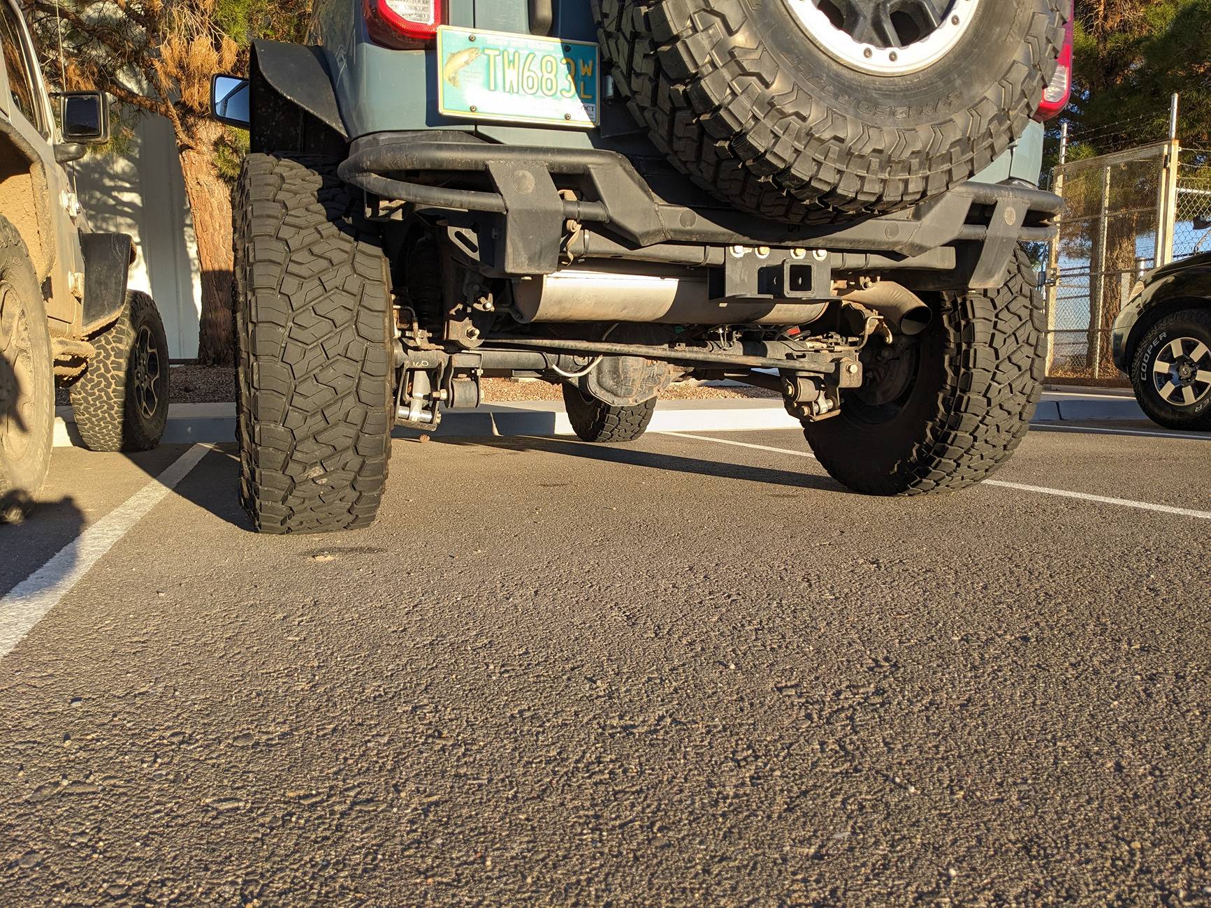

Just bought the Rock Jock one. I definitely need it.
