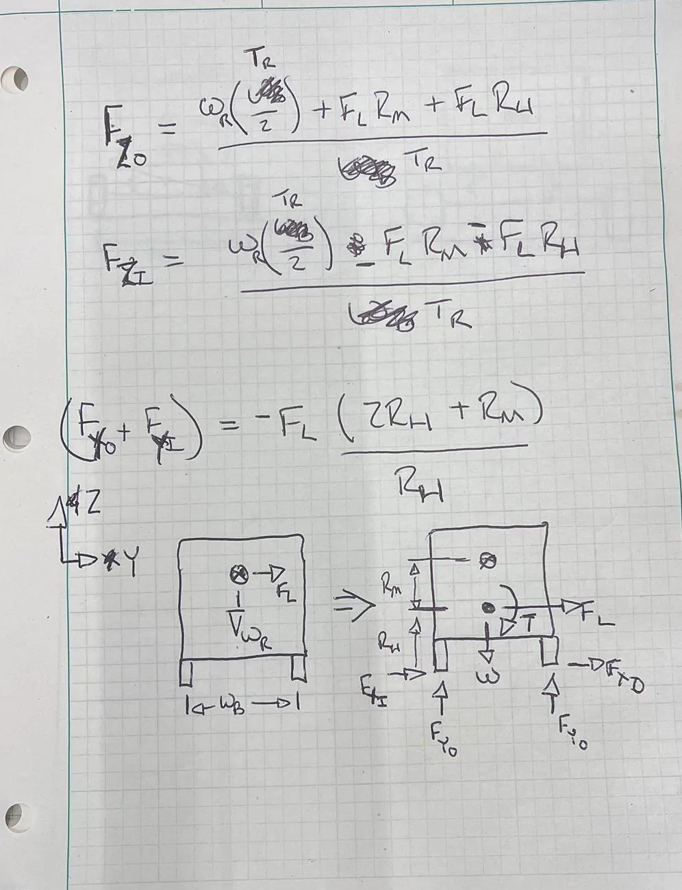

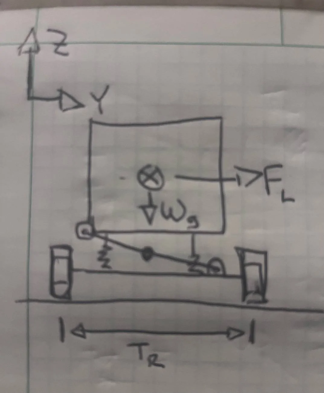

Bigmeats got me curious about real numbers for the 6G platform and “roll center”. I have attached a simple analysis to illustrate some critical behaviors.
First a word about “Roll Center”. This is merely an engineering construct in order to simplify analysis. The roll center is not a single point nor does it remain fixed in space. If there are two bodies that are kinematically connected, then there exists a point where lateral loading is applied and NO roll will exist between the bodies. Not necessarily the point the vehicle rolls about.
Consider a simplified model of the rear end in 2D, see first figure. this model shows the vehicle body and rear axle as the two bodies and the 5 link suspension as the kinematic connection between the bodies with the relative rotation between the body and axle as the “roll”. There are 3 degrees of freedom (motion) for this model of rear end; lateral, vertical, and rotational. This obviously ignores the front end and is not a true 3D representation but can nonetheless highlight interesting behaviors of our solid axle rear end.
The “roll center” location for this 2D model can be calculated from the line of action of the links connecting the axle and body. For this 2D case, only the lateral loading can produce a roll between the two bodies. The lateral body force at the CG during cornering is transferred to the axle via the links and into the road at the tire contact patch.
In the oem 5 link, the rear upper and lower links are very weakly triangulated. The Panhard bar is the dominant lateral load transfer between the bodies. This makes the roll center easy to calculate but more importantly completely controlled by the Panhard geometry. Hence locating the Panhard via custom mounts you can control roll center and cornering vehicle response. Very powerful.
Assuming rigid links and perfectly pinned ends (no flexible bushings). Then the symmetric oem Panhard roll center falls at the location where the Panhard intersects the central axis in our 2D model. Obviously during suspension cycling, especially for an off road vehicle, the Panhard geometry changes and thus roll center dynamically moves. It is NOT a fixed point in space.
A static analysis can be easily done neglecting dynamic response, so inertial effects, which are of course real. Fully understanding the limitations. Nonetheless some interesting cornering behaviors can be shown and are qualitatively representative.
The analysis is included in the figures and has some critical variables of interest; WR is vertical weight on rear axle, FL is later load due to cornering g’s, Tr is rear track width, Rh is roll center height from ground, Rm is roll moment (distance between CG and roll center height), Ry is lateral traction at tire/ground interface, RZo is vertical tire load at outer wheel, and RZi is vertical tire load at inner.
the tire forces (Ry, RZo, and RZi) are shown in 3 equations from 2nd figure. Plotting these quantities vs the roll center some interesting results can be seen, see plots. For easy reference the roll center is located wrt the axle. Also plotted is roll angle.

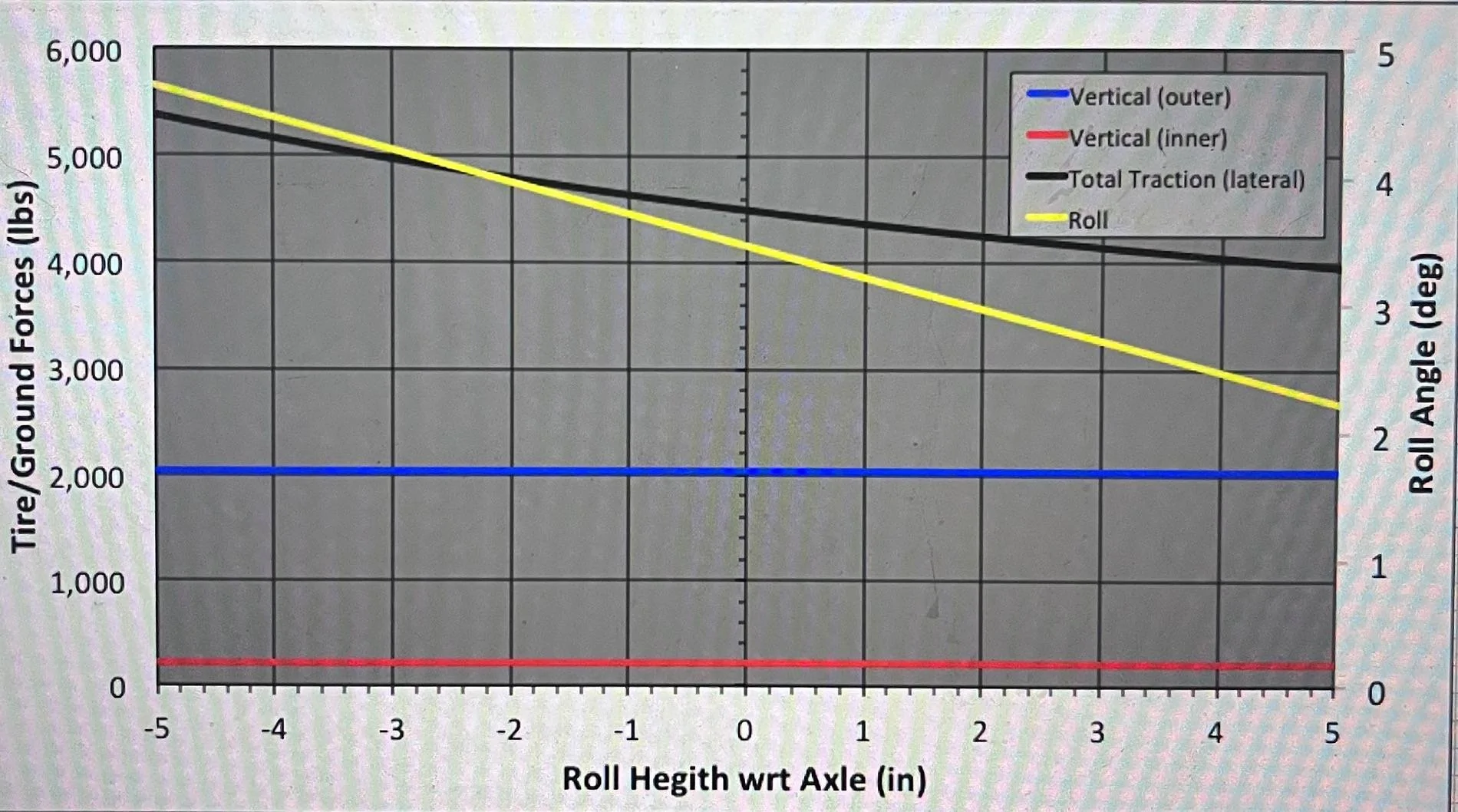

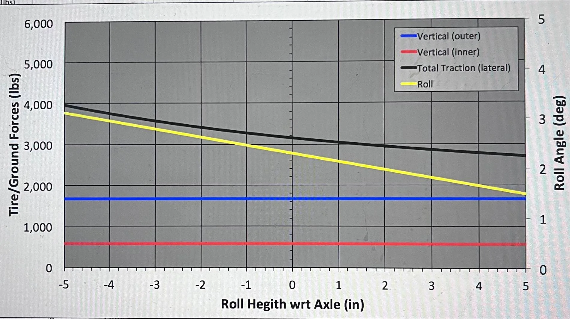

Now for some basic oem numbers; weight on rear axle is 2500 lbs, SAS roll moment is 15”, SAS roll height is 1” below axle and 16” wrt ground, roll stiffness is estimated (wo sway bar) from 250 lbs/in springs.
First plot of results is for 0.5 lateral cornering g’s and second is for 0.75 g’s. All plots assume roll height varies as we relocate Panhard bar but CG remains constant for SAS (31” from ground) so roll moment increases as Panhard moves lower
Notice 0.5 g’s produces greater vertical tire load on outer tire than inner, ie, vehicle wants to tip. But vertical loads don’t change with roll center height. However tire traction loads increase as roll center decreases. This produces better corner handling, as long as tire friction can keep them on the road. That is why reducing roll center improves corner handling. Also notice that there is no free lunch, body roll increases as roll center decreases since roll moment increases (CG doesn’t move). Perhaps a fair compromise for an off road rig. At 0.75 g’s the traction forces increase even more.

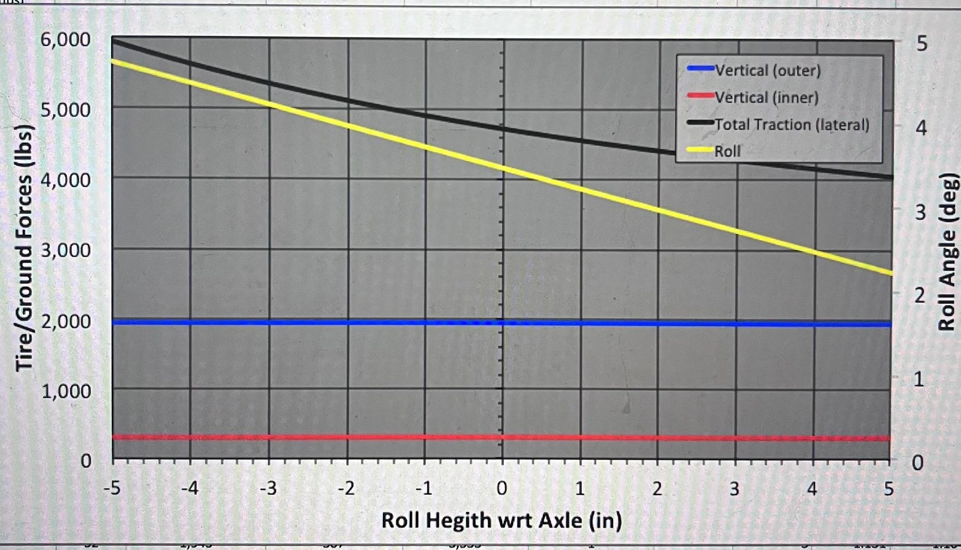

I also made a plot for Bigmeats and his 40s with near SAS CG wrt axle (0.75 g’s). He has kept his CG down while getting clearance from the big meats. So this really helps his corner handling. Maybe he is already on 42s or 50s 🤷‍♂️, I can’t keep up. Anyway his tire traction is LESS than SAS since he has lifted the CG from his big tires, that is why he is fighting to keep it as low as possible. So another tool in his arsenal is to try and reduce the roll center height back to near oem by dropping the frame mount for the Panhard bar which helps get back some tire traction forces.
TLDR for most but interesting to me. If nothing else, ignore math and equations., but think about roll moment and roll height. Then traction forces and body roll in degrees from plots can clearly show how roll center affects these.

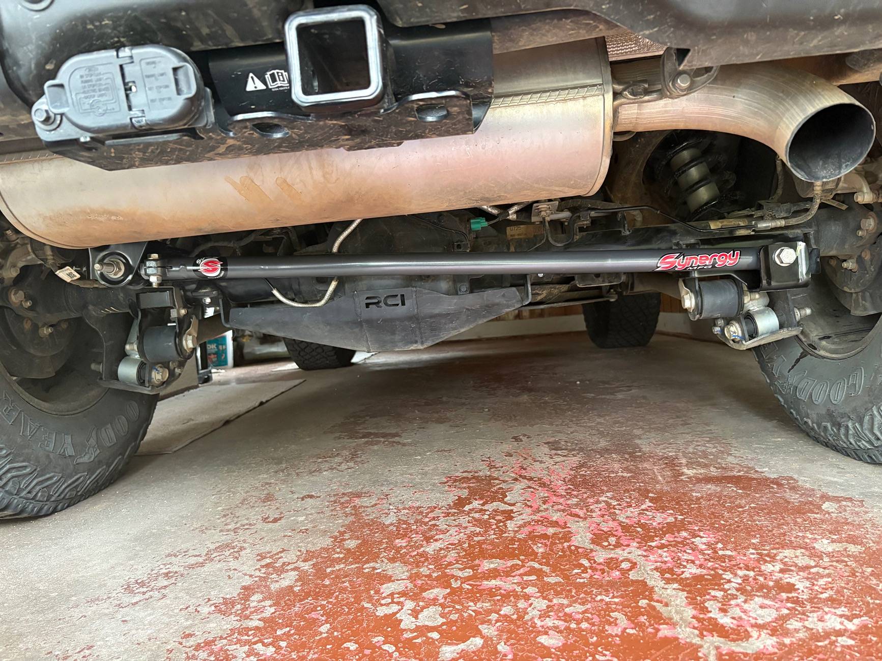

Would you be able to explain what strength of the pan hard bar and flexible bushing does with ride quality? After my lift I installed a Synergy Trackbar, the bar is massive and is made out of steel and has special durometer flex joints. I didnt add a relocation bracket, but the Bronco feels different driving around town and on the highway. I will be taking it Offroad in another week to really test things but overall bumps feel more muted and the vehicle feels stiffer but not stiff just more compliant. Cornering at speeds the rear just feels planted and when hitting bumps I am not getting any jarring feelings or hops.
Can you explain why just a track bar would make such a big difference? I’m thinking it’s mostly has to do with stiffness of materials and bushings used on the new bar and can help centering the axel. Trackbars probably not all created equal. I’d imagine a billet track bar with heim joints or Jonny joints would ride differently then a steel track bar with a poly or rubber flex joint.

the Panhard bar is designed to be a “rigid” link. It can only carry axial loads along its line of action (from mount to mount). The size of the oem bar is plenty stiff along its axis.
many of the bars have a slight bend at the diff for extra clearance. This weakens the bar by causing a stress concentration at the bend under axial load. So general practice would be to increase bar diameter to decrease stress at concentration and maintain stiffness. Once again I would think the oem bar is plenty strong and stiff.
this becomes a fairly simple design trade off, ie, make bar as small as possible to minimize weight and reduce its volume for clearance issues.
the effective stiffness of the Panhard needs to include the bar, the end conditions, and the mounts. These are all springs in series which are completely dominated by the weakest spring.
The Panhard is plenty stiff so doesn’t contribute to effective stiffness. Hopefully the mounts are plenty stiff and also don’t contribute. The mount can be a challenge though. The oem mount has a small offset so not much bending to react. However if it were offset 10” from axle then bending loads would be difficult to deal with and mount stiffness would be an issue. Some real design considerations are needed for the mount. All of the aftermarket bar leveling mounts increase bending stresses.
so ultimately the stiffness is dominated by the bar end conditions. One of the design goals is to rigidly locate the rear axle laterally. No lateral motion at all is desirable. So then a steel on steel pinned connection with very tight tolerances would be desirable.
Another design goal is ride quality. Dynamic loads across a steel on steel connection will have large spikes. Deformations are required to absorb energy in the form of strain energy. Local deformations can be introduced at the rod ends with a flexible bushing material. This will absorb energy but also add flexibility, reduce stiffness, which is in contradiction to the first design goal of rigidly locating the axle.
So the compromise is in the bushing material. Be as “rigid” as possible and still absorb “sufficient” energy. Both rigid and sufficient need to be quantified with numbers so chosen designs can be evaluated and the “best” compromise can be chosen. This most definitely requires knowledge of the use case for the design. Hard core off roading, racing, daily driver, …
a direct swap, bar for bar, I can’t imagine the bar makes any difference but the bushing materials or lack there of most likely do.
