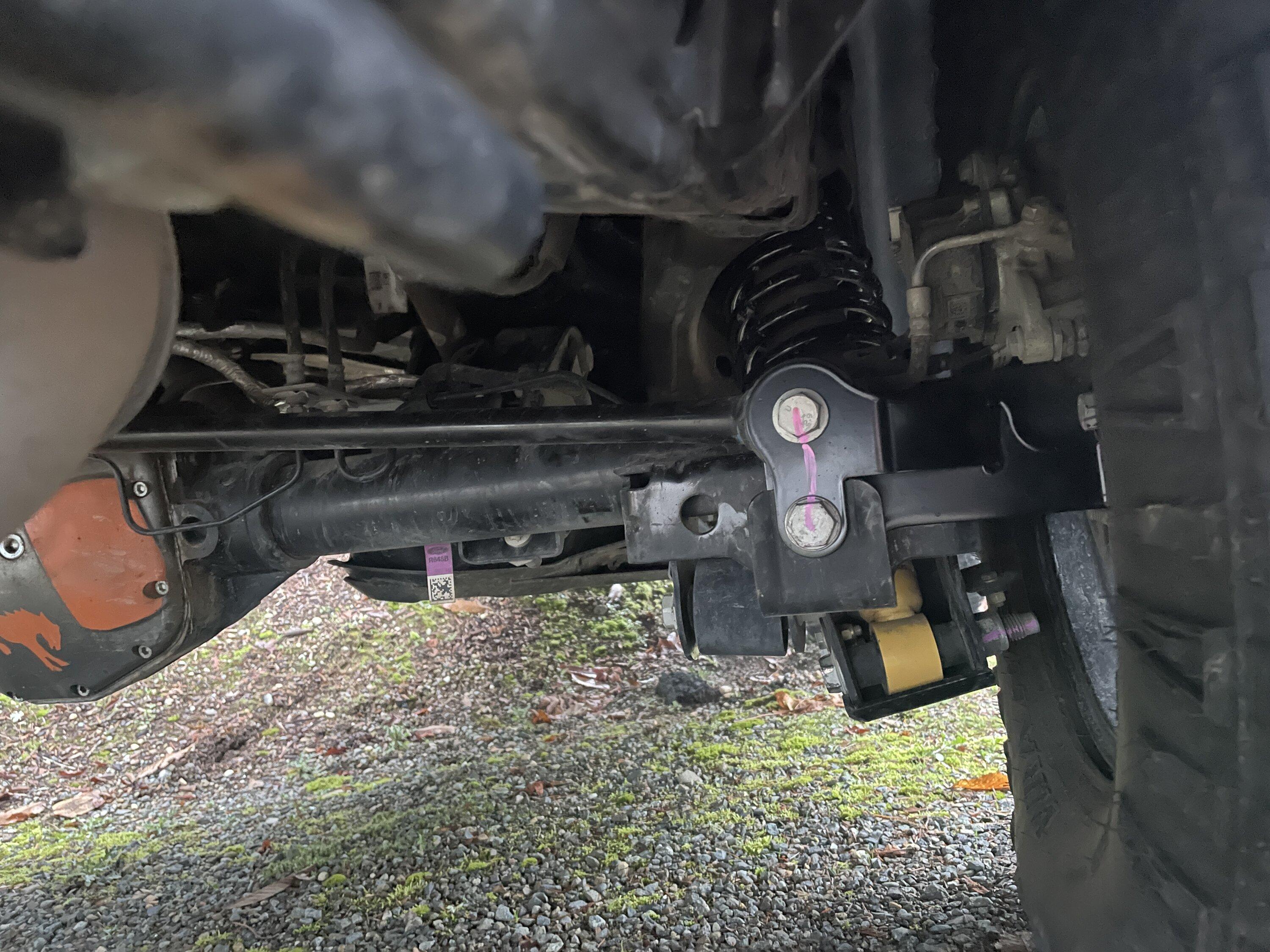

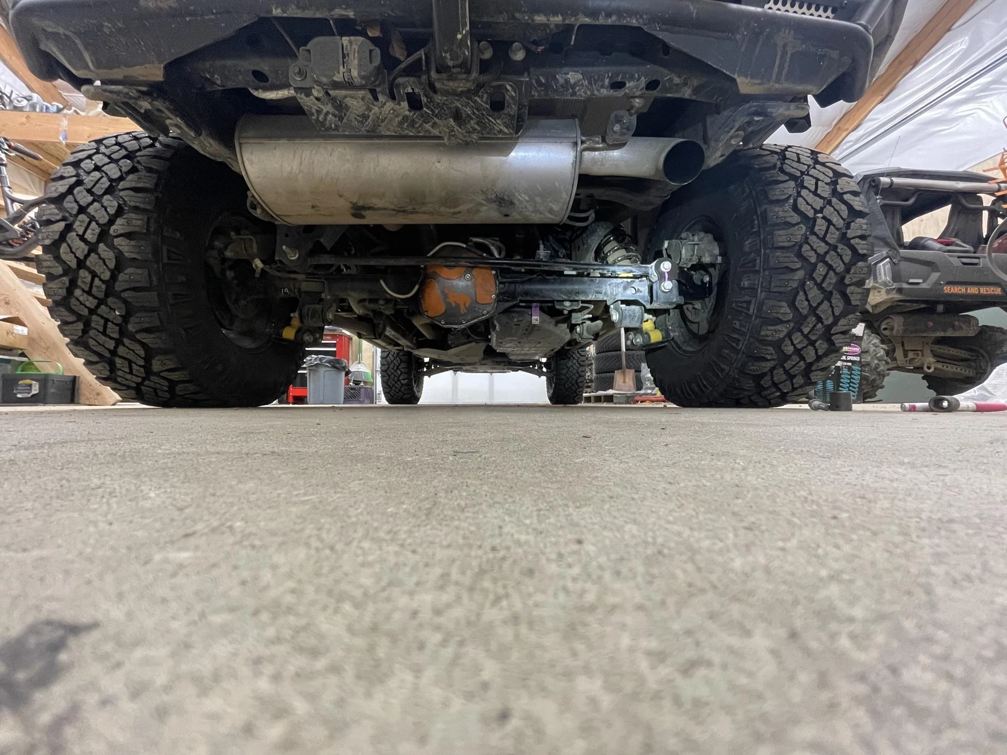

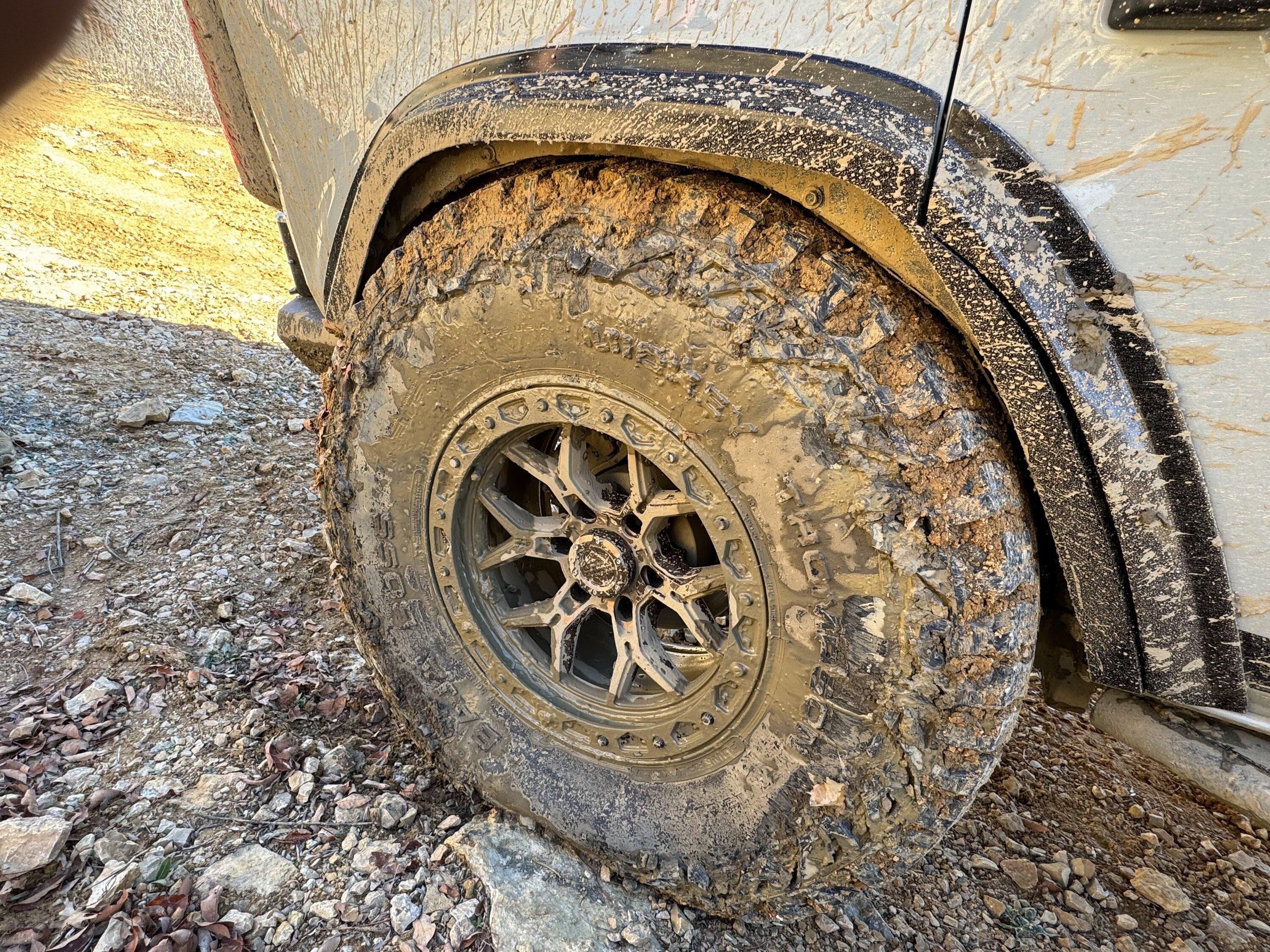

Some quick articulation testing with the OME bracket. I’m on the bumpstop on the shock but not fully compressed and still have about 5” of clearance before frame contact. a jump test may still create an issue but time will tell.
Ford Bronco RockJock track rod bracket full suspension compression requirement E47DD643-B77E-4C51-A735-71E4BB3994E5
Ford Bronco RockJock track rod bracket full suspension compression requirement 2747CA3D-8ADD-4D38-99DD-3B596E7EA583
youloze
Feb 1, 2023
72
57
2023 Bronco Black Diamond
Thank you for this. What suspension are you running?
stock SAS bilsteins with dobinson front and rear 2” lift springs
I'd imagine I should be fine on Eibach 2.0 with 4" of lift then. Guess I'll find out haha. Thanks!

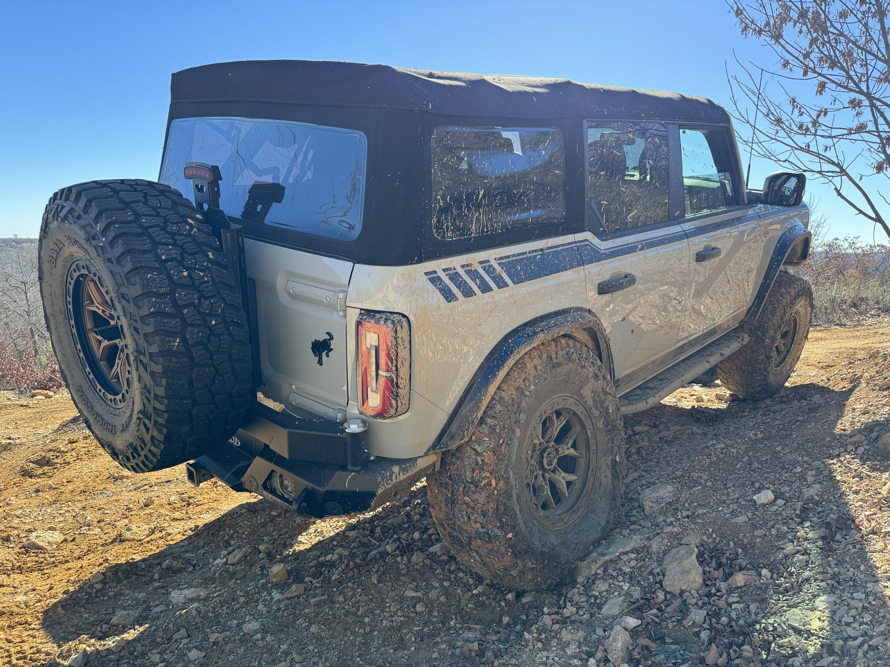

I’m running ADS and the Rock Jock bracket. No issues seen flexing this thing out. ‘23 Wildtrak and swaybars still connected… I’d fully stuff the front with discos…
