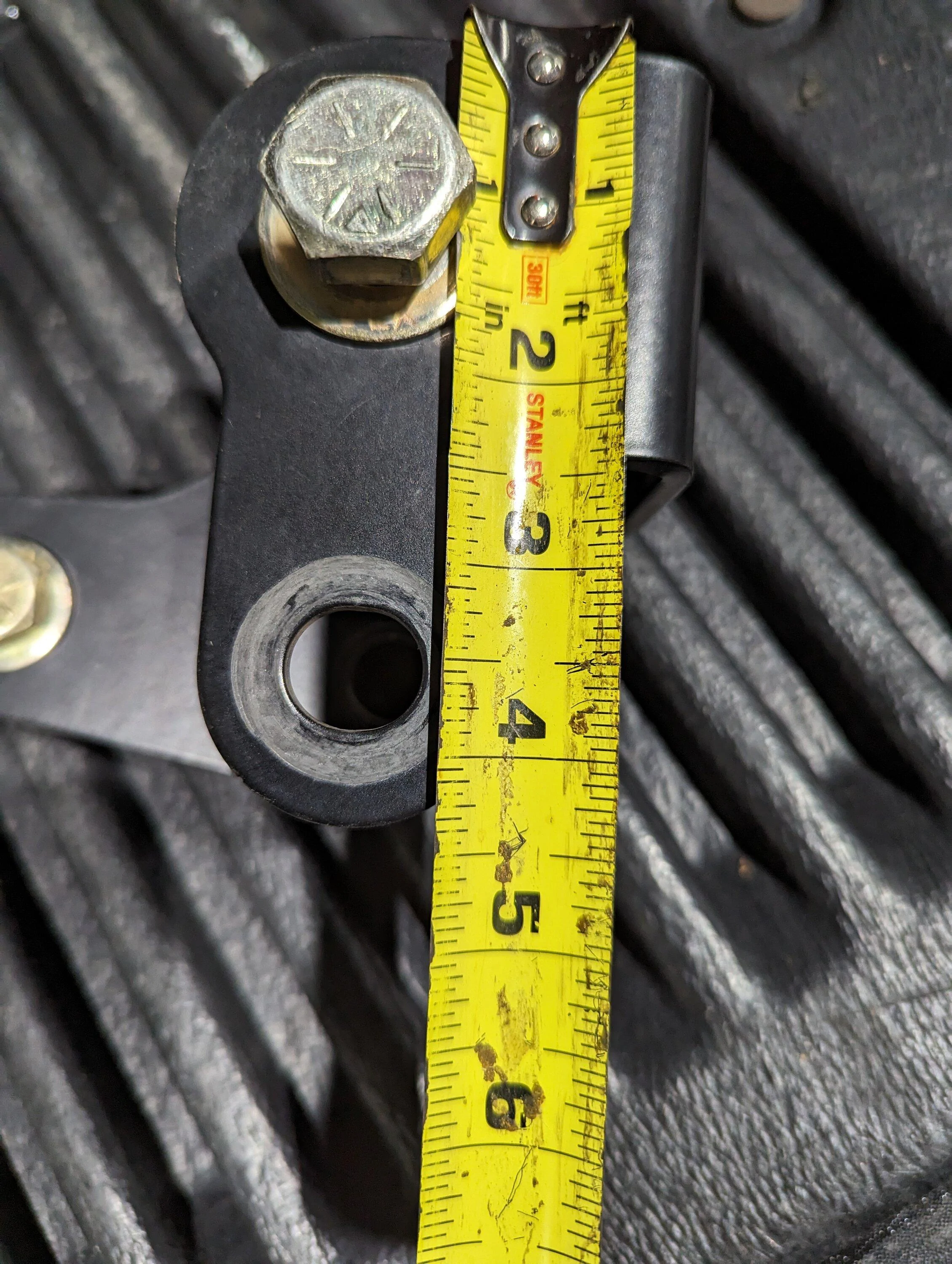

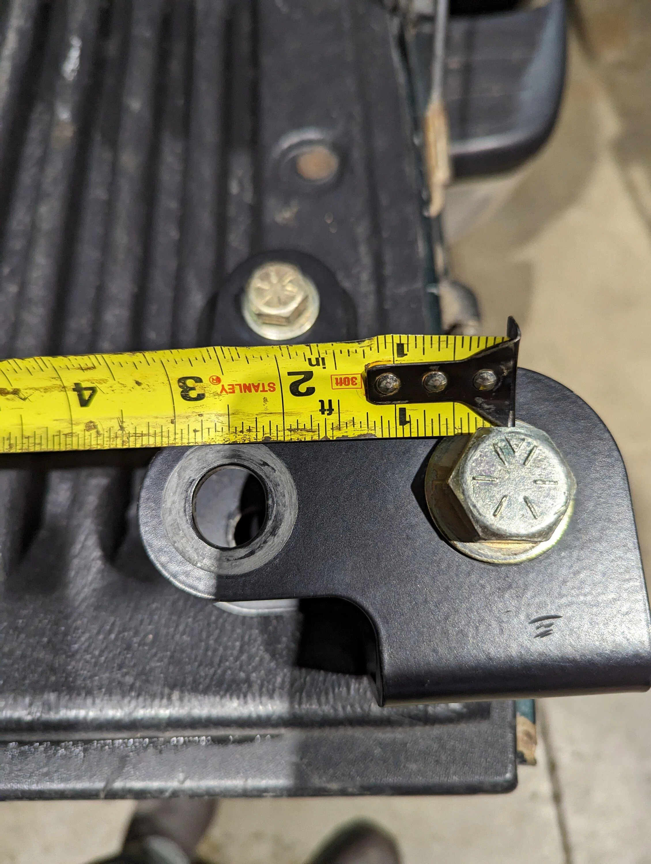

Here's couple measures...
3-5/8" center of axle tube mount to the top of the bracket.
2-1/2" center of axle tube mount to center of Trac bar bolt.
Hope that helps
