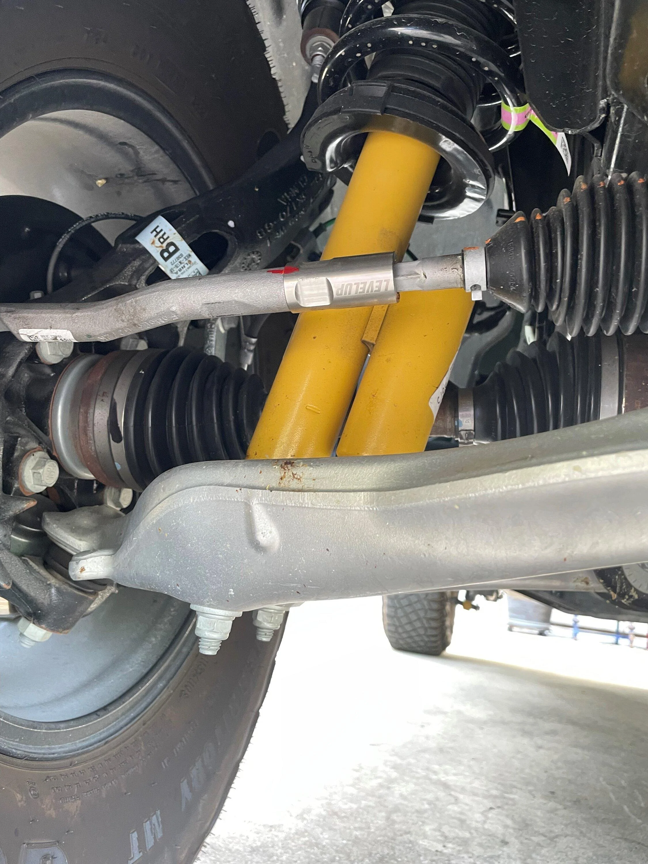

Nice simple upgrade. From the failure pictures I've seen, it appears the tie rods tend to shear right at the threads where the jamb nut is. This sleeve should stop any movement from happening. Will I wheel it hard enough to break the factory tie rod? probable not, BUT, this $70 investment may vary well save a very expensive recovery bill. Especially since I tend to explore and wheel alone. Ready for Colorado next week....

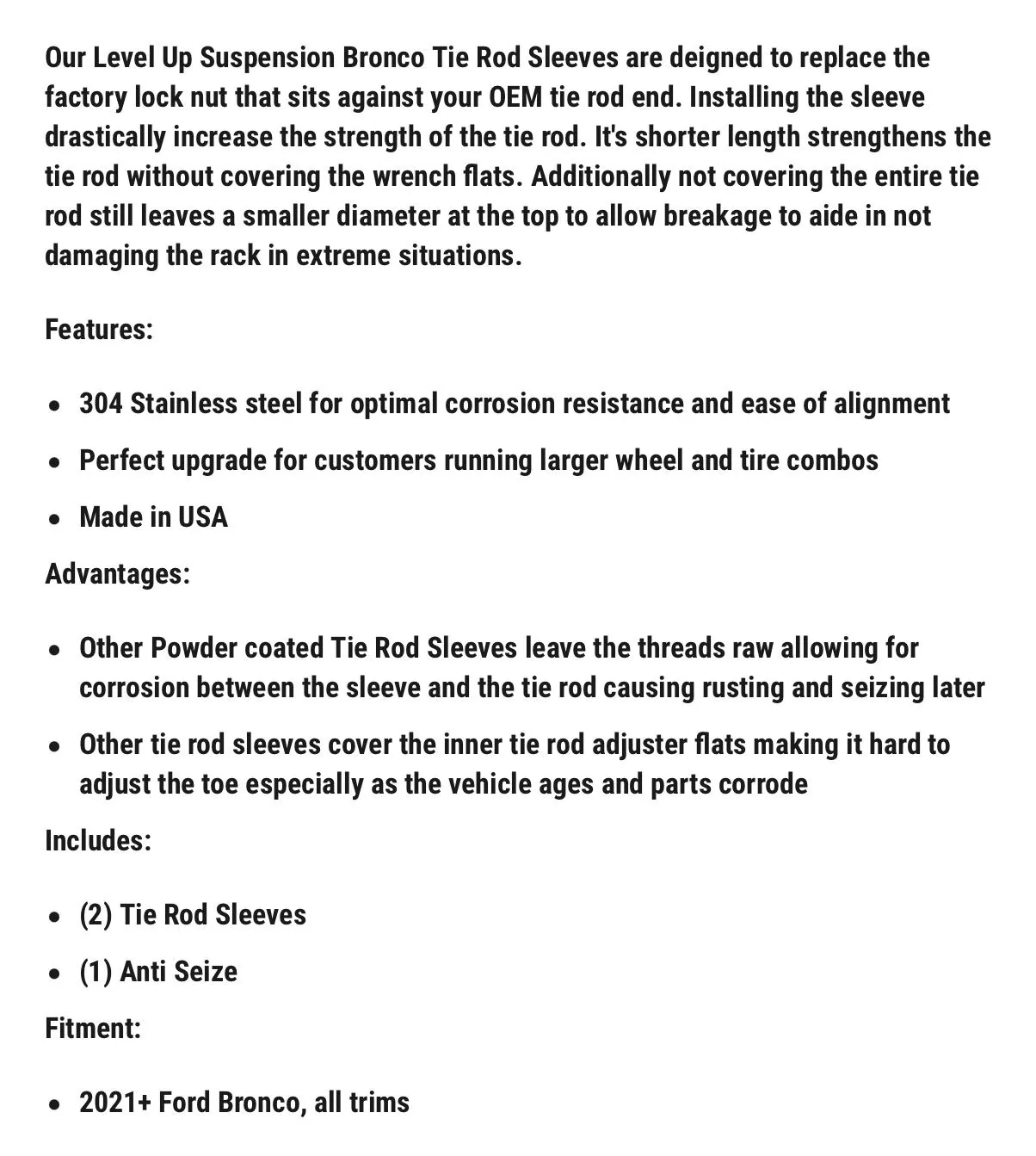

be curious to see how they compare, head to head with the Level Up ones.
The Level Up webpage mentions some specific features and advantages…
