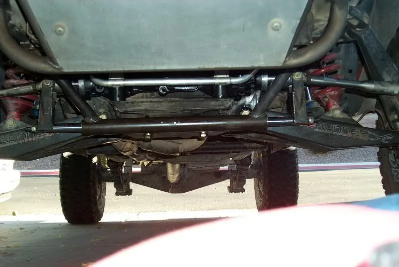

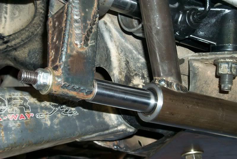

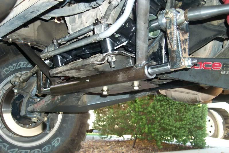

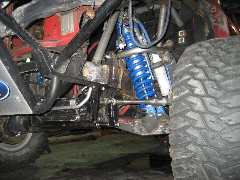

A friend of mine had issues with his '02 ranger XLT after installing a long travel kit. He had gone through 6 rack and pinions in 4 years. He built a slider for it with a 1 3/4" x .250 wall housing, 1 inch shaft, bronze bushings and a seal to keep dirt out. He had a machine shop make the shaft and he built the rest of it. The slider took a lot of stress off the rack and made the steering much tighter and responsive. Its still not perfect as I know he has still replaced the rack and pinion a few times, but he installed the slider back in 2009 and the racks last him so much longer. His long travel kit has a clevis that is mounted to the rack where the inner tie rod goes. Seems like most of the parts I have seen so far just replace the outer tie rods, not both.
